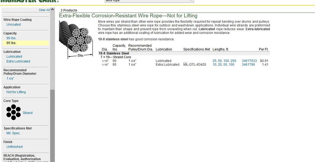

pfrederi 19,375 #10 Posted February 3, 2022 You want something like this. Key is 7 x 19.. home center stuff is usually 7 x7 and stiff... Share this post Link to post Share on other sites
