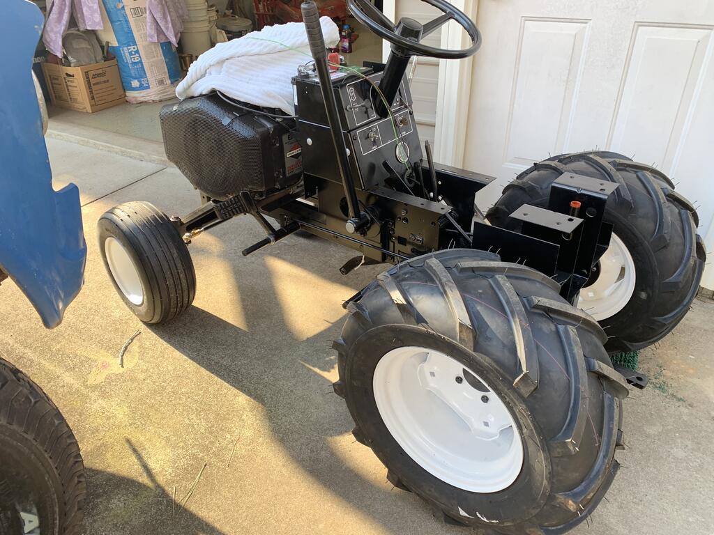

TJ5208 1,841 #177 Posted February 5, 2022 Got the parts just have to put them on. 1 1 Share this post Link to post Share on other sites

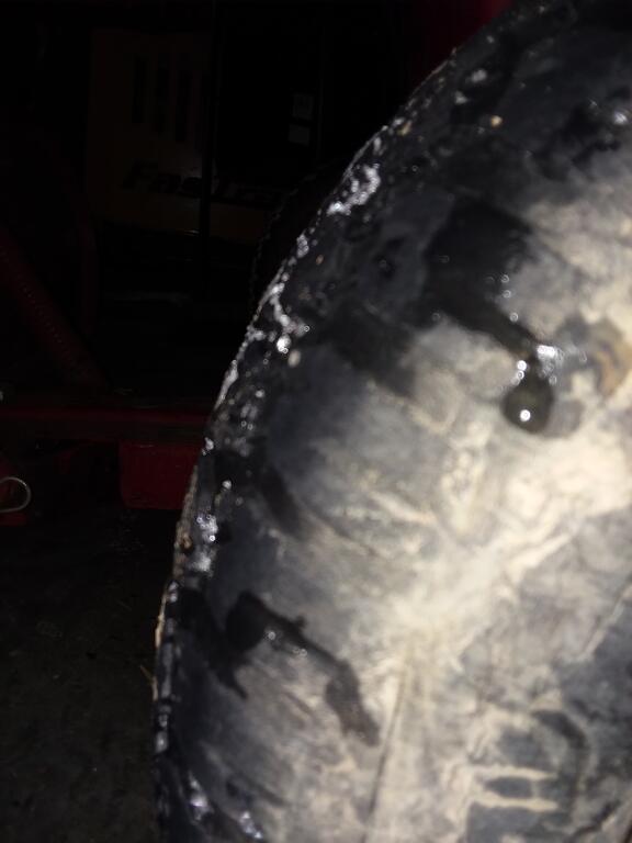

TJ5208 1,841 #178 Posted February 6, 2022 (edited) Would you guys consider these tires wore out. would you guys still stick fluid in them or not. Couldn't push any snow with ice underneath it today it would push a tiny bit then start spinning. any recommendations I don't really want to stick outside weights on it maybe inner wheel weights jut like the tractor look. I'm planning on filling all four tires. Edited February 6, 2022 by TJ Salyers 2 Share this post Link to post Share on other sites
Howie 900 #179 Posted February 6, 2022 Not going to push much without at least chains on there. 4 1 Share this post Link to post Share on other sites
Jeff-C175 7,211 #180 Posted February 6, 2022 (edited) 15 minutes ago, Howie said: Not going to push much without at least chains on there. @TJ Salyers Those are turf tires TJ, you need weight (whether filled tires or external weights) and chains (preferably 2 link) to get any grip at all. For turf use, no, they aren't particularly worn out. They were never intended for snow. Edited February 6, 2022 by Jeff-C175 3 Share this post Link to post Share on other sites
TJ5208 1,841 #181 Posted February 6, 2022 (edited) Just so thin tread. Edited February 25, 2022 by TJ Salyers 2 Share this post Link to post Share on other sites
c-series don 12,375 #182 Posted February 6, 2022 @TJ Salyers Like others have said weight and two link chains are the key. As a kid I weighed about 120 lbs and I had (have) a Work Horse GT-1800 with chains and no extra weight and I could move mountains of snow. 2 Share this post Link to post Share on other sites

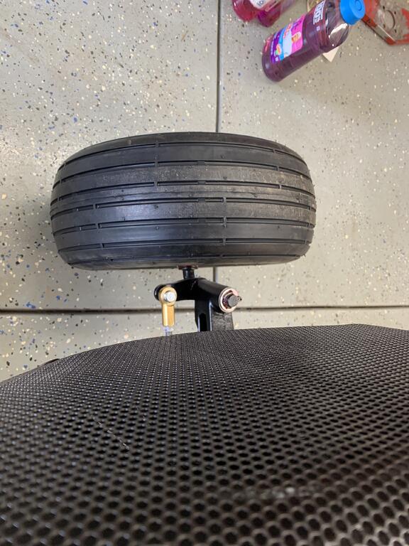

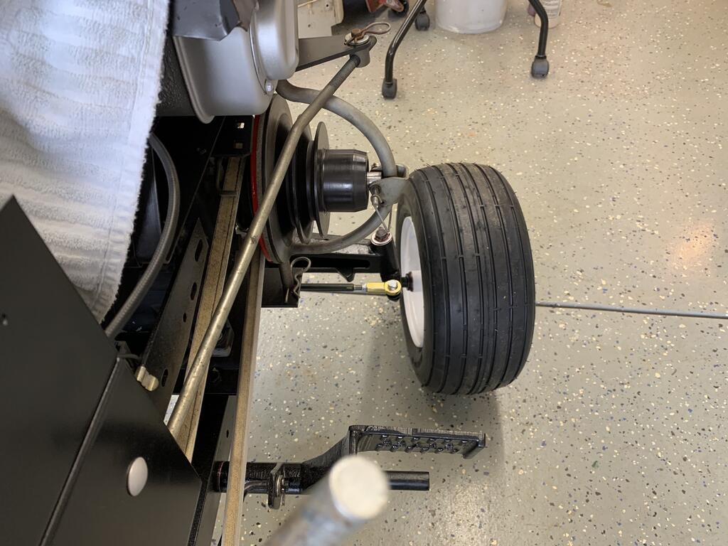

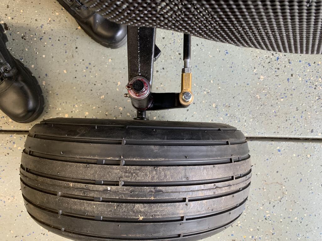

TJ5208 1,841 #195 Posted March 13, 2022 (edited) Did these tires change? I was about to order me the 23 8 but the 23 10 looks better. Edited March 13, 2022 by TJ Salyers 1 Share this post Link to post Share on other sites
Achto 32,432 #196 Posted March 13, 2022 I'd go with the 10.50's 1 1 Share this post Link to post Share on other sites
Horse Newbie 7,405 #197 Posted March 13, 2022 38 minutes ago, TJ Salyers said: Did these tires change? I was about to order me the 23 8 but the 23 10 looks better. Looks like the pics are mixed up, but it could just be me… looks like by the pics the 23x10.50 is narrower than the 23x8.50… 1 Share this post Link to post Share on other sites
