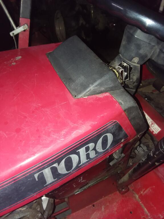

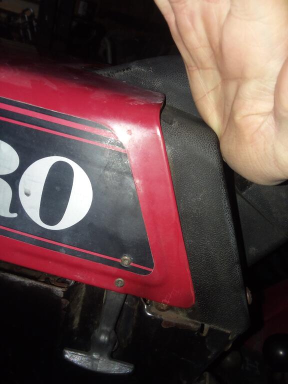

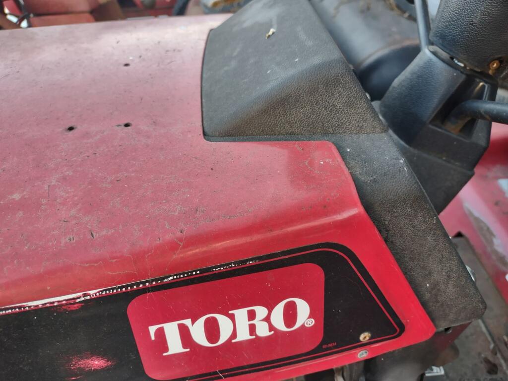

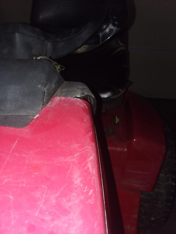

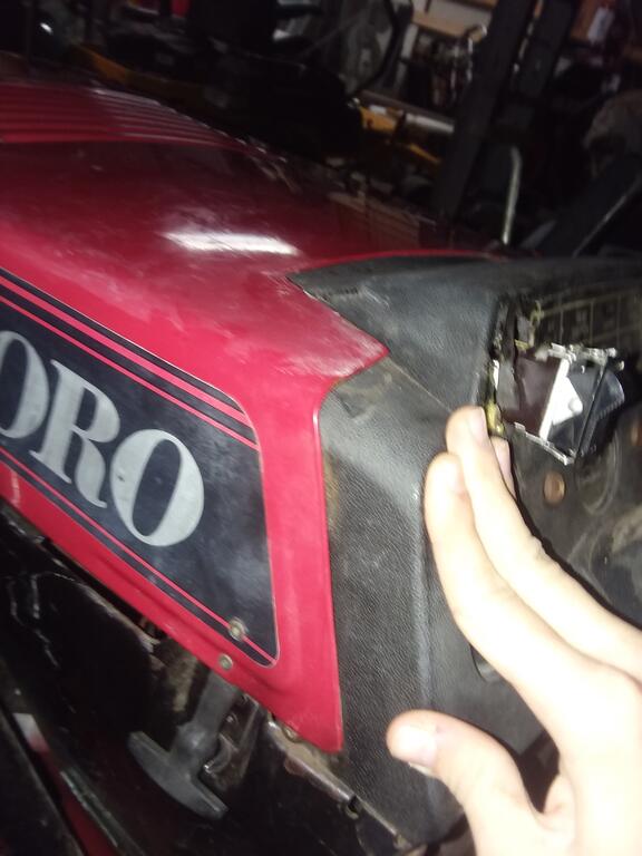

Achto 32,095 #153 Posted February 3, 2022 14 minutes ago, TJ Salyers said: Just didnt know if i could fix it. Looked mine over, no way to adjust the dash. Could be that the hood is out of adjustment. The hood is slotted by the hinge so that you can loosen the bolts & slide it back some. Hood should meet up with the dash like this. 2 Share this post Link to post Share on other sites
TJ5208 1,841 #154 Posted February 3, 2022 6 minutes ago, Achto said: Looked mine over, no way to adjust the dash. Could be that the hood is out of adjustment. The hood is slotted by the hinge so that you can loosen the bolts & slide it back some. Hood should meet up with the dash like this. The plastic is bent 1 Share this post Link to post Share on other sites
Achto 32,095 #155 Posted February 3, 2022 12 minutes ago, TJ Salyers said: Your hood gets wider as it goes toward the front. If you slid it back it should slip over the dash. 2 1 Share this post Link to post Share on other sites

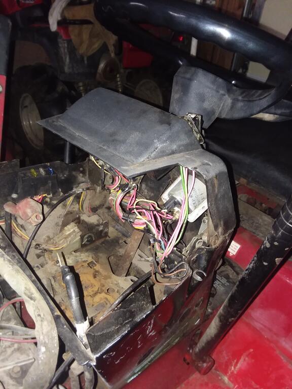

TJ5208 1,841 #156 Posted February 3, 2022 15 minutes ago, Achto said: Your hood gets wider as it goes toward the front. If you slid it back it should slip over the dash. The dash itself is bent I think I can fix it though 3 Share this post Link to post Share on other sites

TJ5208 1,841 #161 Posted February 4, 2022 I got it underneath the hood it don't want to go under the hood correctly and hopefully the pressure will bend it back in shape I went ahead and latched the hood. 1 2 Share this post Link to post Share on other sites

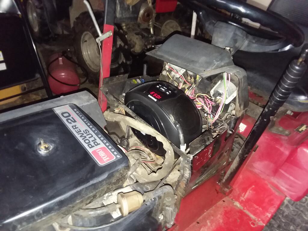

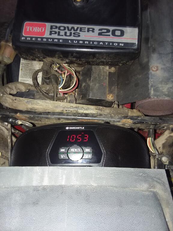

TJ5208 1,841 #165 Posted February 4, 2022 If I didn't have to put the battery in there this is what I would put in it. wonder if you could hear it over the tractor. Share this post Link to post Share on other sites
