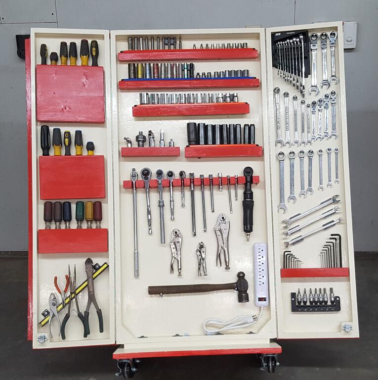

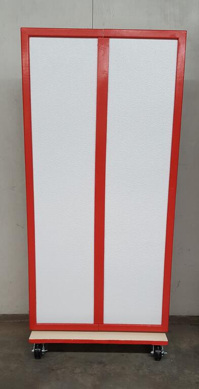

Gregor 4,838 #1 Posted February 2, 2022 I said a while ago that I was going to make me a cabinet for my tools. Not all my tools of course, but the ones I seem to use the most. I've been working on this off and on for a while now, along with some other wood projects, trying to get the saw dust mess done all at once. AND A MESS IT IS ! There are some changes I would make if I were to do it again, bu it's good enough for who it's for. The object was o get as many tools in as small a space as practical. I think I have done that. 8 10 1 1 Share this post Link to post Share on other sites
Kenneth R Cluley 480 #2 Posted February 2, 2022 Cool, like a portable pegboard. Share this post Link to post Share on other sites

ebinmaine 63,272 #4 Posted February 2, 2022 Excellent work sir Share this post Link to post Share on other sites
tunahead72 2,346 #5 Posted February 2, 2022 Very clever, well done! 1 Share this post Link to post Share on other sites
formariz 11,865 #6 Posted February 2, 2022 (edited) Good idea. It keeps all tools visible so there is no searching. Some woodworkers use tool cabinets like that but not on wheels, just hanging on wall over the bench. Quick tool identification and access is the key to efficiency. Edited February 2, 2022 by formariz 1 1 Share this post Link to post Share on other sites
ebinmaine 63,272 #7 Posted February 2, 2022 2 minutes ago, formariz said: Good idea. It keeps all tools visible so there is no searching. Some woodworkers use tool cabinets like that but not on wheels, just hanging on wall over the bench. Quick tool identification and access is the key efficiency. That would work well for me because I'm terrible about out of sight out of mind. Share this post Link to post Share on other sites

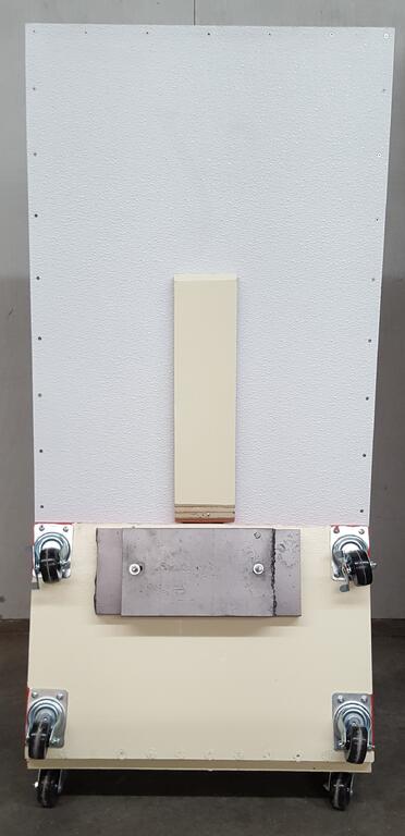

Gregor 4,838 #10 Posted February 2, 2022 1/2 plywood for the cabinet, 3/4 plywood for the bottom, LOTS of T-nuts, and sex screws, FRP facing on the front and back.This is 40# of steel on the underneath for ballast 1 Share this post Link to post Share on other sites
Handy Don 10,656 #11 Posted February 2, 2022 8 minutes ago, Gregor said: .This is 40# of steel on the underneath for ballast I wondered about what kept it in balance. Good thinking! 1 Share this post Link to post Share on other sites
formariz 11,865 #12 Posted February 2, 2022 9 minutes ago, Gregor said: This is 40# of steel on the underneath for ballast That was going to be my next question if that was a ballast. So its 111Lbs including ballast? Share this post Link to post Share on other sites

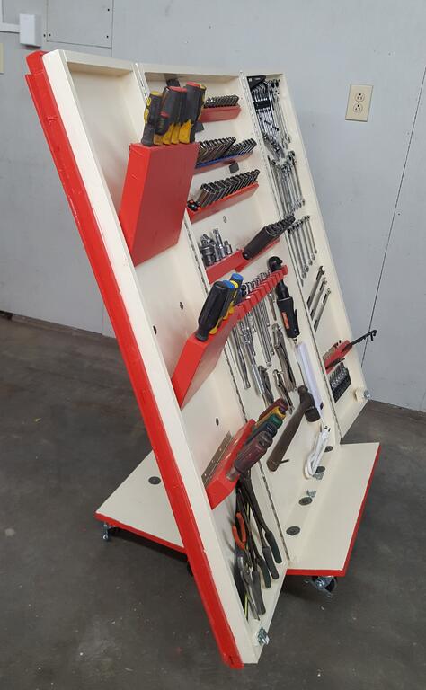

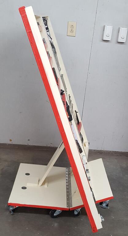

Pullstart 59,825 #13 Posted February 2, 2022 Perfect shop project! When it’s all closed up, how stable is it? I think toggle lock to a wall for safe keeping? Share this post Link to post Share on other sites
Gregor 4,838 #14 Posted February 2, 2022 25 minutes ago, formariz said: So its 111Lbs including ballast? The cabinet is 111 with the 40 # of steel empty. 149 # loaded. I would have thought more. 3 minutes ago, Pullstart said: I think toggle lock to a wall for safe keeping? It is actually quite stable whether standing up or leaning back, but you want to have a clean floor. It will be secured to the wall when not in use. I couldn't imagine what would happen if it fell over. 1 Share this post Link to post Share on other sites
