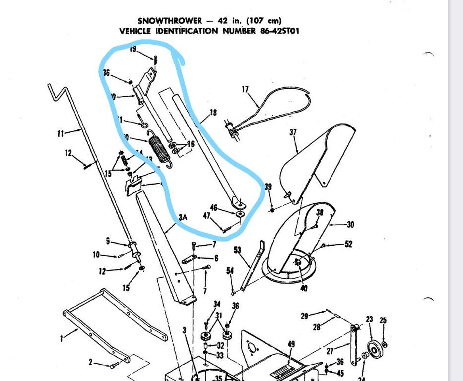

pfrederi 21,046 #7 Posted February 2, 2022 Should fit the 520. Would have to come with a front tachmatic to work on 607 (way lacking in HP to be truly effective) Do not see the flag or lift rod. (circled) They are available but cost $$ Look for cracks at the front top corners of the housing 1 Share this post Link to post Share on other sites
