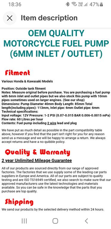

Mickwhitt 5,259 #26 Posted February 1, 2022 this is 1 to 2 psi so should be OK. I can just bypass the mechanical pump and see what happens. 1 Share this post Link to post Share on other sites

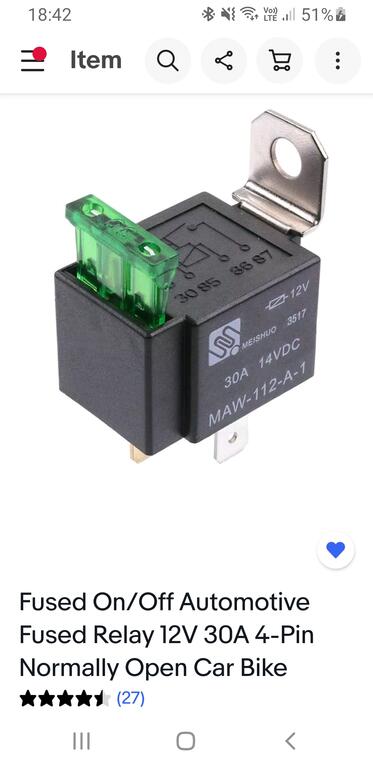

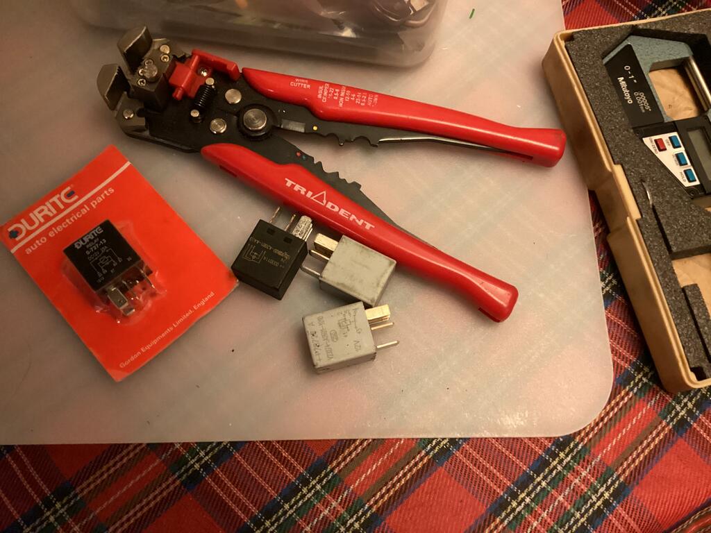

Mickwhitt 5,259 #27 Posted February 1, 2022 I guess this size of relay will do the job, I'm no electrician so I will be asking questions like a dummy. Lol Share this post Link to post Share on other sites
pfrederi 21,051 #28 Posted February 1, 2022 I do not see the current draw in the specs for your pump. The ones i use only draw about 1.5 amps (the have an internal 3.5 am fuse so that would be the max) I know a lot of people use relays i do not. Have at least 4 electric pumps for several years now no issues. Your ignition switch handles 3-4 amp for the ignition and 6 amps or more for lights with out a problem. to me adding a relay just introduces another electro mechanical device that can fail . Put a fuse in the feed line. wire it to Acc.. 2 2 Share this post Link to post Share on other sites

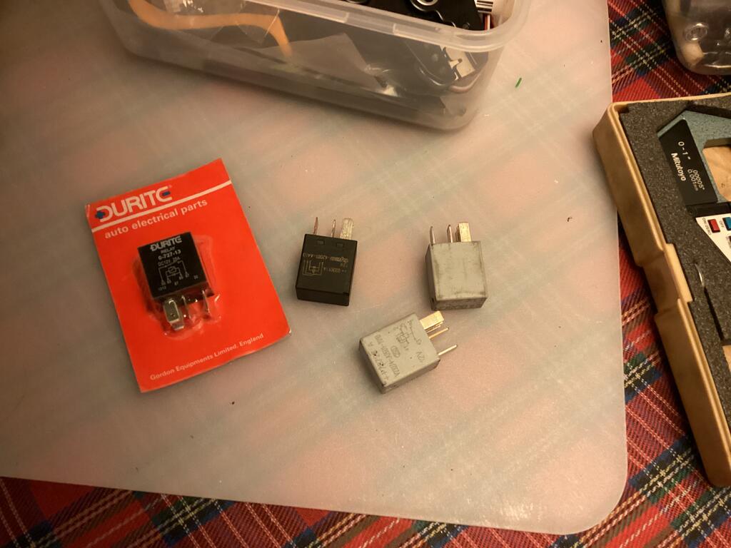

squonk 47,888 #29 Posted February 1, 2022 Those relays will out last 10 ign switches. Simple to hook up. The instructions are in my threads. Yes the pumps don't draw a lot but the ignition switches have crappy contacts when new. I installed relays and contactors on all kinds of equipment. They handle loads much better than the switches and controls things come with now days. Do what you want. I have a drawer full of these relays so they don't cost me a thing. Share this post Link to post Share on other sites

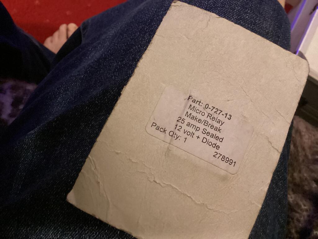

ranger 1,860 #31 Posted February 1, 2022 (edited) Try operating the primer bulb when it plays up Mick, if you have any form of blockage in the tank/fuel tap etc, the bulb will collapse and be very reluctant to resume it’s ‘Inflated’ state. If you want to fit a relay, p.m. me an address, and I’ll send you a few, 25amp ‘micro’s, I’ll fish out some of the smaller spade terminals as well, the larger ones are 1/4”. I think I may have some inline fuse holders also. Doug. Edited February 1, 2022 by ranger 1 Share this post Link to post Share on other sites

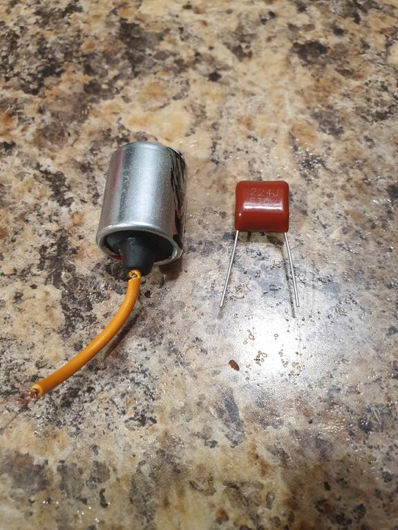

Mickwhitt 5,259 #42 Posted February 9, 2022 Well by way of an update. Checked for vacuum leaks and everything OK. Tried the original main jet back in the carb, no real difference. I had replaced it with a spare one in slightly better condition but from a different carb. This one worked fine despite the difference. Messed with the ignition wiring, tried a wire from positive to coil positive, made no difference. Seemed to run fine at tick over but acted up when at running throttle, even standing in the drive. Tried a new capacitor in place of the automotive condenser I had fitted new with the ignition coil. Hey presto seems to run a lot better just parked up. No time for a test run today but I will run him under load on Friday and see if it has cured the problem. Hoping that Ranger is right and the fuel problem is an ignition issue. If so this new jury rigged capacitor will be made permanent and resilient. 1 Share this post Link to post Share on other sites

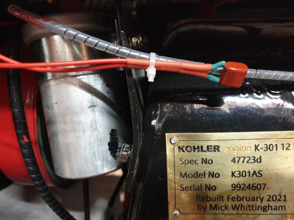

Mickwhitt 5,259 #43 Posted February 9, 2022 This is the capacitor simply fitted between coil and earth. 1 Share this post Link to post Share on other sites
Jeff-C175 7,211 #44 Posted February 9, 2022 1 hour ago, Mickwhitt said: the capacitor What value is that capacitor Mick? Share this post Link to post Share on other sites

Mickwhitt 5,259 #48 Posted February 9, 2022 The condenser i put on with the new coil is on the left, you can see the insulation on the wire has cracked. Its not the best bit of electronic engineering. The capacitor I used is 0.22uF I believe, its on the right. Old motorcycle forums provided information about condensers and gave the value to try. I can only look at the points to see if they are burning to tell if I'm in the right ball park. Share this post Link to post Share on other sites
Jeff-C175 7,211 #49 Posted February 9, 2022 14 minutes ago, Mickwhitt said: 0.22uF I believe, S'what it looks like to me, 224 = 0.22uF And 630V ? hard to read with the glare... that oughta be enough! Now ya got me curious to measure the ones on my machines and see what the value is. Maybe I'll do that tomorrow if'n I remember! If the cap is too large, you get deposits on one side, if too small, on the other... I can't recall which side is which though. 1 Share this post Link to post Share on other sites
