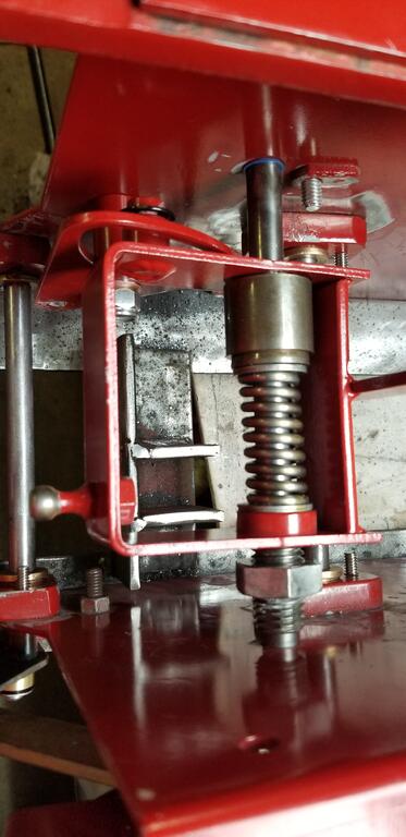

gt14rider 1,275 #26 Posted February 1, 2022 So should I put the rust back on 4 Share this post Link to post Share on other sites
Jeff-C175 7,211 #27 Posted February 1, 2022 47 minutes ago, gt14rider said: should I put the rust back on No! but you might wanna tighten that loose locknut! 2 Share this post Link to post Share on other sites
pfrederi 21,005 #28 Posted February 1, 2022 That spring is a whole lot looser than any of my several working Sunstrands... Aren't any of them that clean or nice looking either...but they work 1 Share this post Link to post Share on other sites
Snoopy11 5,731 #29 Posted February 1, 2022 42 minutes ago, Jeff-C175 said: No! but you might wanna tighten that loose locknut! Easy peasy... @gt14rider ...you da' man!!! Don 2 Share this post Link to post Share on other sites

gt14rider 1,275 #33 Posted February 2, 2022 3 hours ago, Jeff-C175 said: No! but you might wanna tighten that loose locknut! Got to lube it first 1 3 Share this post Link to post Share on other sites
Snoopy11 5,731 #34 Posted February 2, 2022 22 minutes ago, gt14rider said: Got to lube it first Don 1 Share this post Link to post Share on other sites

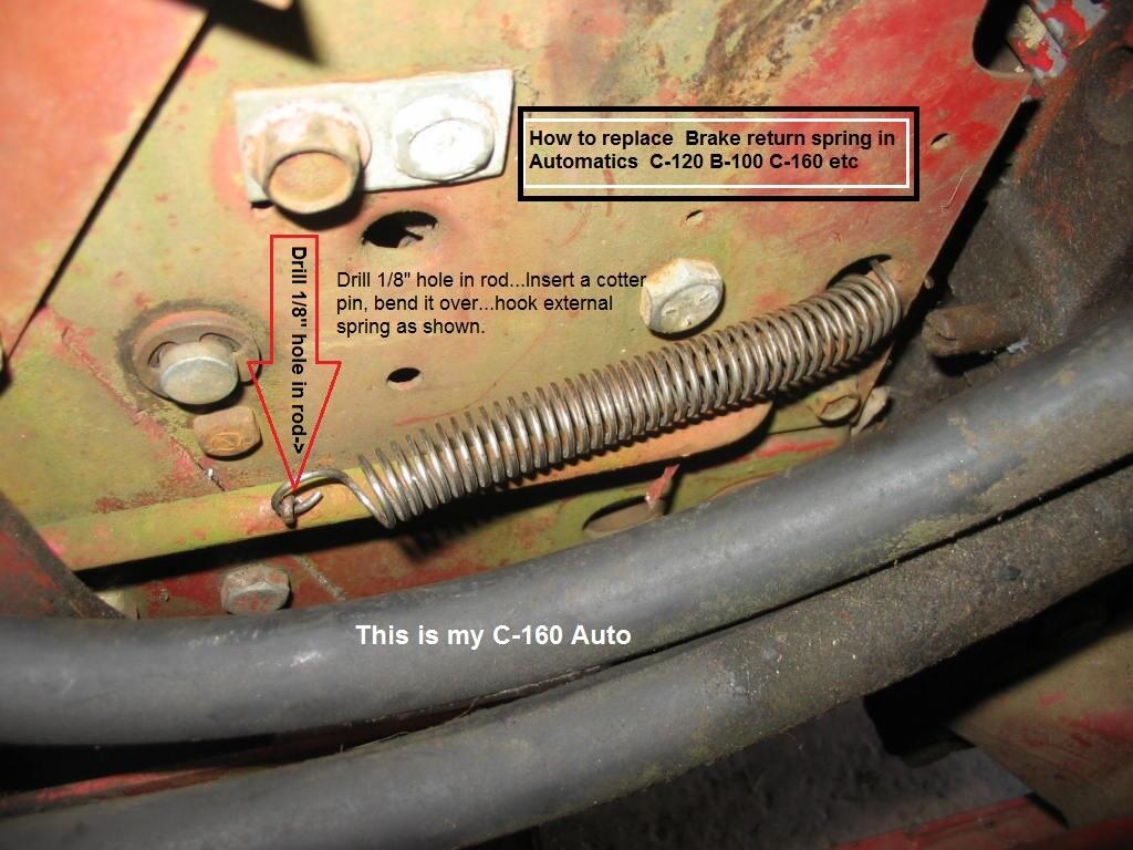

Wheelhorse#1 1,962 #44 Posted February 5, 2022 On 1/30/2022 at 7:22 PM, daveoman1966 said: Common problem on most hydros... The easy fix is this: Drill a 1/8" (or less) hole in the BRAKE return ROD. Insert a little cotter pin in that hole, bend it over, and hook a small SPRING to that cotter pin. Other end of spring hooks conveniently to a NOTCH in the hoodstand... This is my C-160 Auto. ( Bronco 14 is same) with FIX APPLIED...took about 15 minutes. Dave Where is the spring located ? I checked my 74 auto and there isn’t one or is this just a add on ? 1 Share this post Link to post Share on other sites
squonk 47,798 #45 Posted February 5, 2022 5 minutes ago, Wheelhorse#1 said: Dave Where is the spring located ? I checked my 74 auto and there isn’t one or is this just a add on ? That is an add on. The stock spring is inside the tunnel, usually broken and a PITA to reinstall if it isn't 2 Share this post Link to post Share on other sites
Wheelhorse#1 1,962 #46 Posted February 5, 2022 1 hour ago, squonk said: That is an add on. The stock spring is inside the tunnel, usually broken and a PITA to reinstall if it isn't Thanks.That whole break pedal system is wonky, not really a break cause it just throws trans in neutral. 1 Share this post Link to post Share on other sites

gt14rider 1,275 #50 Posted February 5, 2022 15 hours ago, Wheelhorse#1 said: It looks like its off the tractor assembly Pic is from a mockup, like Jeff- C175 said a little dab of brake caliper grease 96, 101, 105 wouldn't hert.the spring is 109. Put some bushings at pivot points to pedal. Maybe a little overkill. This is a GT14 setup but should be similar. Gt14 project put on back burner when covid hit. Then my back decided short circuit, it has not been fun, nerve pain sucks. 1 2 Share this post Link to post Share on other sites
