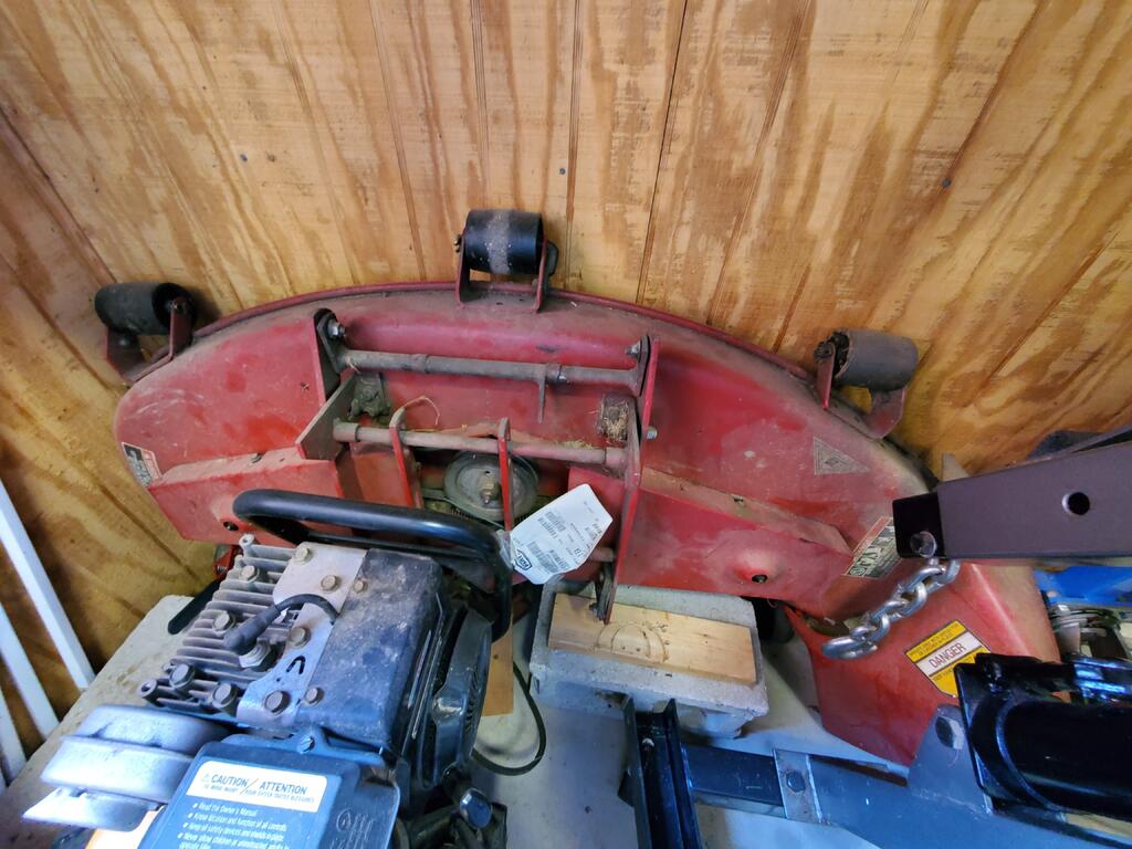

Red-Bovine 337 #8 Posted January 31, 2022 Here is a picture of our 1992 48" mower deck. It has the welded bar edge. Don't know about the steel plate. Don't think it has it. It has the flip up discharge chute.. Kinda stuffed in the back of the garage. Storing it for the day we might sell the 520H. 1 1 Share this post Link to post Share on other sites
gwest_ca-(File Mod) 12,451 #9 Posted January 31, 2022 You have the steel plate. You can see it in the center between the belt guards. The screws that secure the belt covers are threaded into the turned up lip of the plate. Models without the plate have the belt cover screws going down into the deck shell. There is no other place for them. 2 Share this post Link to post Share on other sites

Red-Bovine 337 #13 Posted February 1, 2022 I guess maybe I do have the plate. Bought new in 1992 and has been trouble free with annual greasing and cleaning. Probably didn't clean it when we removed it a few years ago when we made the 520H a permanent snow blower. Getting too old to crawl around on the floor swapping out the deck for the blower. LOL 2 Share this post Link to post Share on other sites
