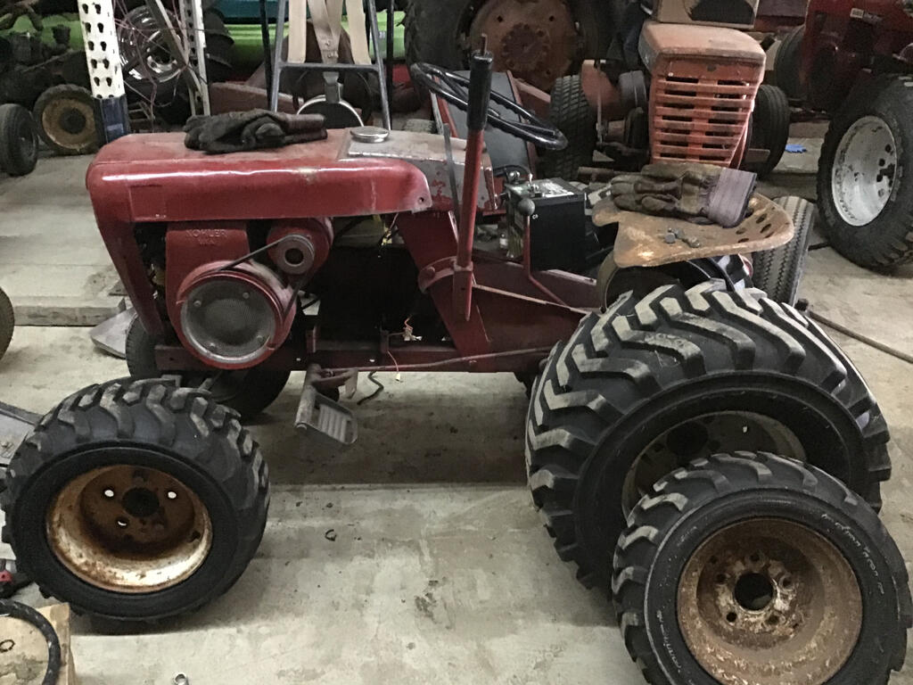

Rob J. 1,944 #26 Posted January 30, 2022 4 minutes ago, ebinmaine said: On the rears you could swap out for a set of wheels and tires from a later C series. Those would be 23 x 8.5 x 12. The fronts you actually have more options because you have more clearance. No fender in the way. 8" wheels with tires as tall as 18" or more. Parts availability is excellent by mail order. For wheels and tires both front and rear you could call Lincoln at A to Z Tractor in Pennsylvania. His shipping rates would be competitive. Thanks for the info, I’ll check him out for sure. 1 Share this post Link to post Share on other sites

EB-80/8inPA 2,115 #28 Posted January 30, 2022 2 minutes ago, Rob J. said: The seat was the next thing I was getting to. Not even sure it’s correct. It mounts directly to the rear fenders. Almost seems like it’s missing a mount in between the seat and fenders? I have that same machine. I Recently had the seat bracket welded back together, adding a piece of angle at the bends. The seat on mine (as I found it) bolted to the fender through that bracket as you describe. So finding a bolted seat with the right pattern seems to be an issue. Maybe using nutserts will increase your replacement options? 2 1 Share this post Link to post Share on other sites
Racinbob 13,121 #29 Posted January 30, 2022 7 minutes ago, Rob J. said: n. The seat was the next thing I was getting to. Not even sure it’s correct. It mounts directly to the rear fenders. Almost seems like it’s missing a mount in between the seat and fenders? I believe that the seat did mount directly to the fender back them. If you look closely you can see to long U shaped springs fastened to the seat then to the flip up pan. The ride is improved. 3 Share this post Link to post Share on other sites

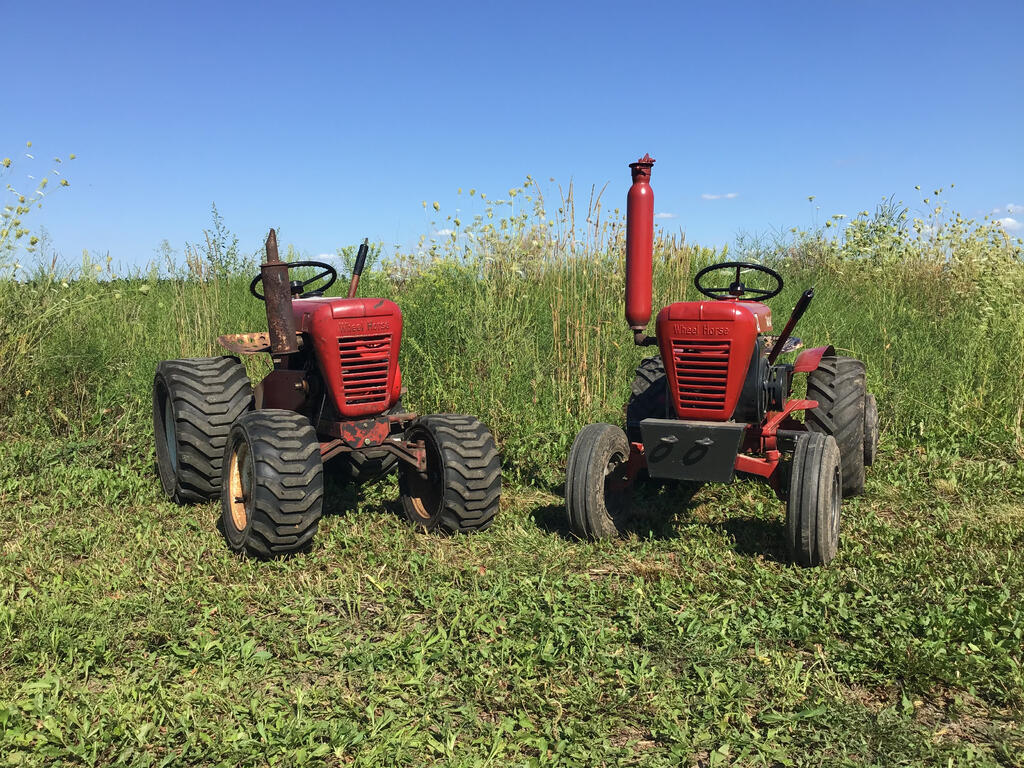

Pullstart 71,160 #33 Posted January 30, 2022 I did however utilize some of those rear 10” wheels on the front of a custom project. It turned out pretty cool. 4 2 Share this post Link to post Share on other sites

Pullstart 71,160 #36 Posted January 30, 2022 7 minutes ago, Rob J. said: Nice! Tell me more please I pieced it together. My uncle gave me the tires as payment for a job, then I shopped around in my storage barn for something to toss ‘em on! Here’s the total build thread. 2 Share this post Link to post Share on other sites
EB-80/8inPA 2,115 #37 Posted January 30, 2022 (edited) 2 hours ago, ebinmaine said: On the wheels ... What exactly do want to change? Width? Back spacing? Type? Looking to swap to larger tires? I would love to find replacement 22X7.5-12’s to match the ones on mine, but I can’t find anyone making/selling them. Unless @Rob J.has better luck than me, wider & taller tires are almost a foregone conclusion. If anyone knows a source, by all means chime in! TIA. Edited January 30, 2022 by EB-80/8inPA 3 Share this post Link to post Share on other sites
Rob J. 1,944 #38 Posted January 30, 2022 12 minutes ago, EB-80/8inPA said: I would love to find replacement 22X7.5-12’s to match the ones on mine, but I can’t find anyone making/selling them. Unless @Rob J.has better luck than me, wider & taller tires are almost a foregone conclusion. If anyone knows a source, by all means chime in! TIA. Well I know I’m limited in the rear but with no suspension I’d like to squeeze the few inches that’s there. Thought about even going skinnier and taller tires more like a traditional tractor. Weighing out my options right now. So new to WH. 1 Share this post Link to post Share on other sites
