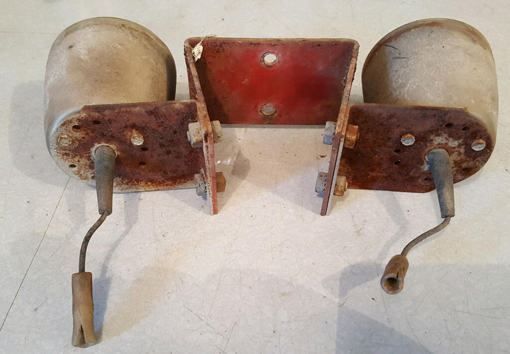

WHX?? 57,869 #26 Posted February 6, 2022 Wow Dav.... I woulda give 200 for that all day! Hate to be one of them vultures but you wanna make a quick bennie... Just kidding but I will tell you what I would do with it and that is a frame off mechanical resto. Motor included. That tractor has character that won't quit. Even with the cut hood. Correct me if I am wrong fellas but the lone head lite reminds me of a 953/1054. Could it be packaged a pair for use on another '63 model? I have a mate for it so DO NOT scrap it! Thanks for the pics and please keep up updated on your progress! 2 Share this post Link to post Share on other sites

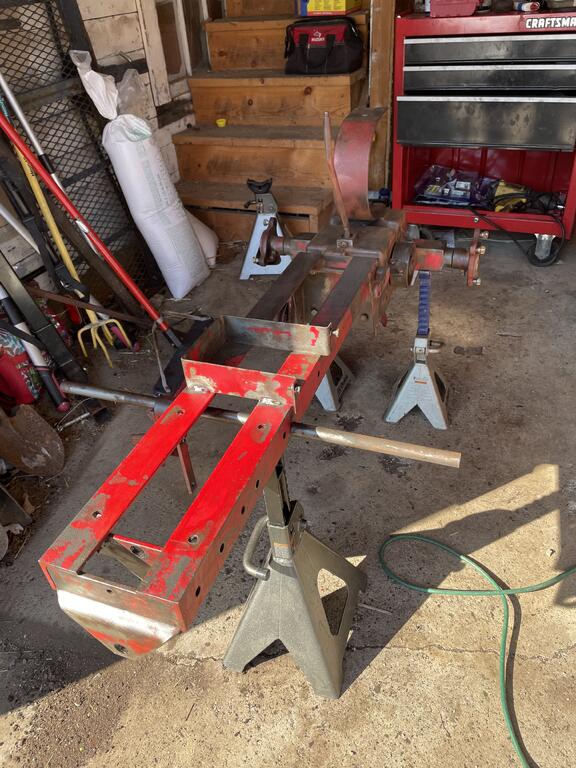

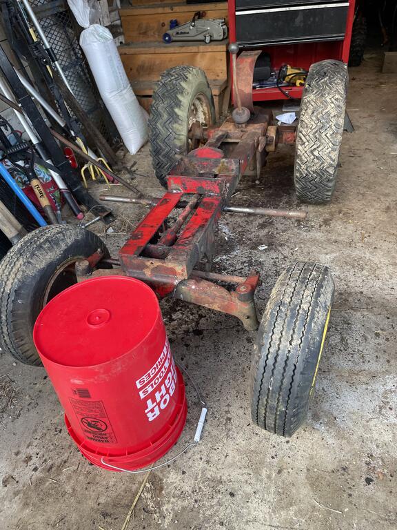

Redav72 231 #27 Posted February 27, 2022 Feel like I owe an update here. I picked up the 753 a few weeks ago and have stripped it all the way down to the frame and transmission. I'm a fan of Super Clean, seems to do a really nice job de-greasing. The toolbox is completely rotted out and I've been unable to remove the seat support, ended up cutting the box out which means that I won't be able to re-install fenders later. Rebuilt the carb and waiting for fuel pump parts, hope to have it running for my sons 6th birthday in May (tractor party) 7 1 Share this post Link to post Share on other sites

953 nut 68,701 #29 Posted February 28, 2022 (edited) On 2/5/2022 at 7:10 PM, WHX?? said: lone head lite reminds me of a 953/1054. Could it be packaged a pair for use on another '63 model? I have a mate for it so DO NOT scrap it! The headlights on the first generation (1000 or so) 953 were leftover HL-22 units that didn't get sold in '62. The weren't the prettiest attachment but are scarce and therefor desirable additions to any '62 or '63 . On 2/26/2022 at 10:58 PM, Redav72 said: hope to have it running for my sons 6th birthday in May (tractor party Edited February 28, 2022 by 953 nut 2 2 Share this post Link to post Share on other sites

Redav72 231 #31 Posted February 28, 2022 3 hours ago, 953 nut said: The headlights on the first generation (1000 or so) 953 were leftover HL-22 units that didn't get sold in '62. The weren't the prettiest attachment but are scarce and therefor desirable additions to any '62 or '63 . Interesting….. So there is what looks like a rotting 953 in a neighbors yard. Think I need to go make a cold offer. 3 Share this post Link to post Share on other sites

equipment guy 55 #33 Posted March 1, 2022 I have never seen that headlamp set up before. However, as far as the hydraulic kit goes, I have the same basic set up on a Cub Cadet 105. Very trouble free, and work great… Share this post Link to post Share on other sites

hcminis 1,796 #35 Posted March 2, 2022 On 2/5/2022 at 6:57 PM, Redav72 said: Nope, regrettably. But if anyone has a buddy for it I'd be happy to drop it in the mail. Believe I have a spare light. 317-491-3106 Share this post Link to post Share on other sites

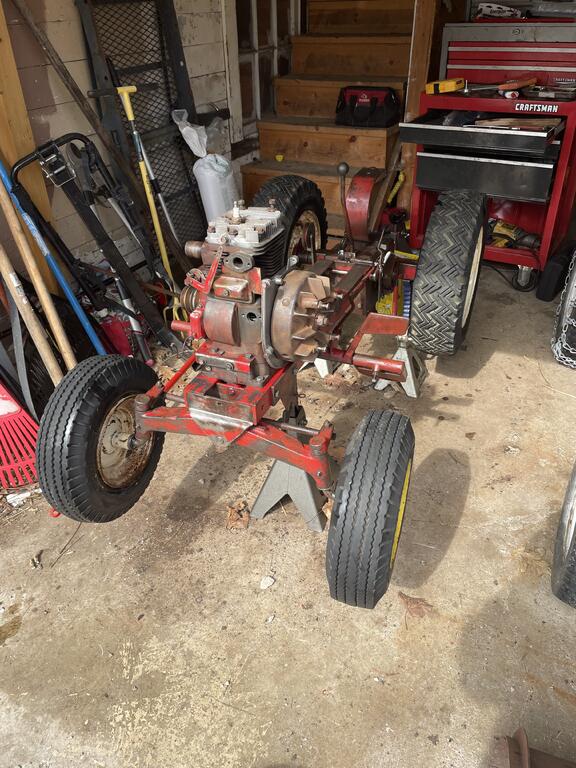

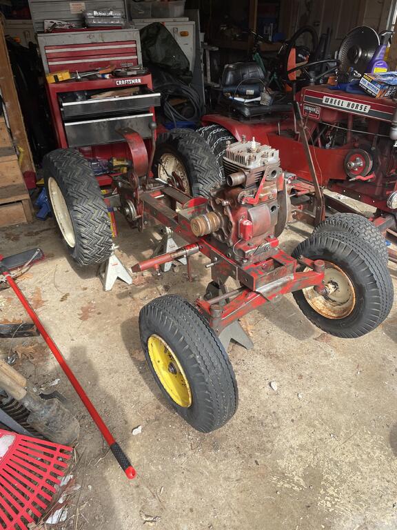

Redav72 231 #36 Posted March 6, 2022 Got a little further. Wheels and engine back on. Hopefully I’ll get a spark tomorrow. 1 2 Share this post Link to post Share on other sites
Handy Don 17,363 #37 Posted March 6, 2022 Ok, I give in. Why the shift of the front jack stand between taking the two pictures? 2 Share this post Link to post Share on other sites
Redav72 231 #38 Posted March 6, 2022 Optical illusion, didn’t move it at all (I think) 1 Share this post Link to post Share on other sites
Pullstart 71,144 #39 Posted March 6, 2022 @Handy Don Me thinks it’s on the 3/4” bar for the foot rests, in the center of the tractor. 1 1 Share this post Link to post Share on other sites

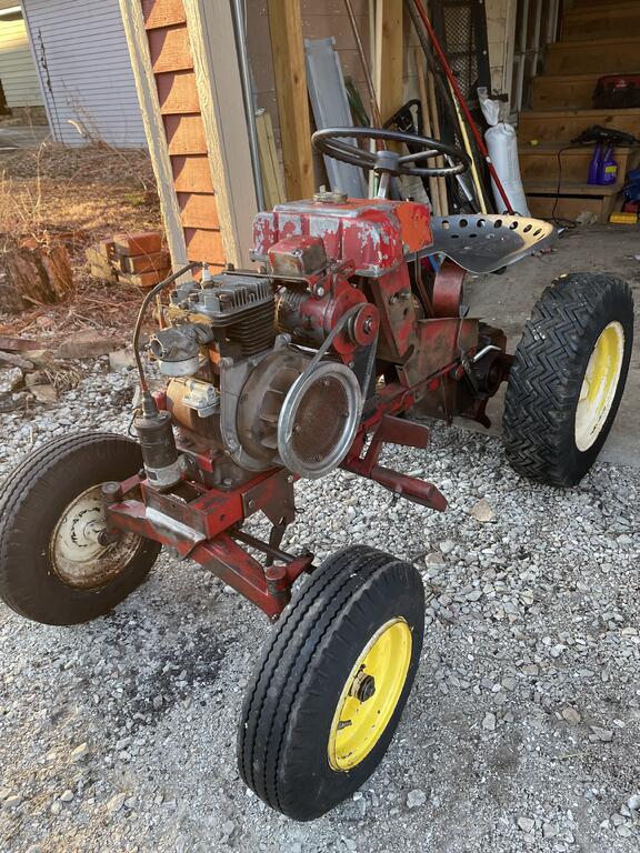

Redav72 231 #44 Posted March 14, 2022 starter generator installed, cheap seat from eBay. Had hoped to get the motor turning today but ran out of sunlight. 4 Share this post Link to post Share on other sites
