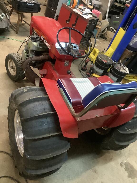

Two to do’s done on 2 2 22.
seat and exhaust, both crossed off.
Nice foot warmer!
Plenty of snow down here in Kalamazoo.  How much did you get?
Something about that pipe, just turned this view into a Rat Fink look.
6 minutes ago, bds1984 said:
Nice foot warmer!
yessir!
about 10-14” I’d say.  I plowed a couple places twice today and I’ll run a cleanup route tomorrow!

15 hours ago, Pullstart said:
It might look better I agree, but function and safety might actually be a concern with this build…
Yeah, Kevin is one guy who knows what he is doing... :handgestures-thumbsup:
14 hours ago, Pullstart said:
Like. It. Was. Meant. To. Be.
I LIKE IT!!!

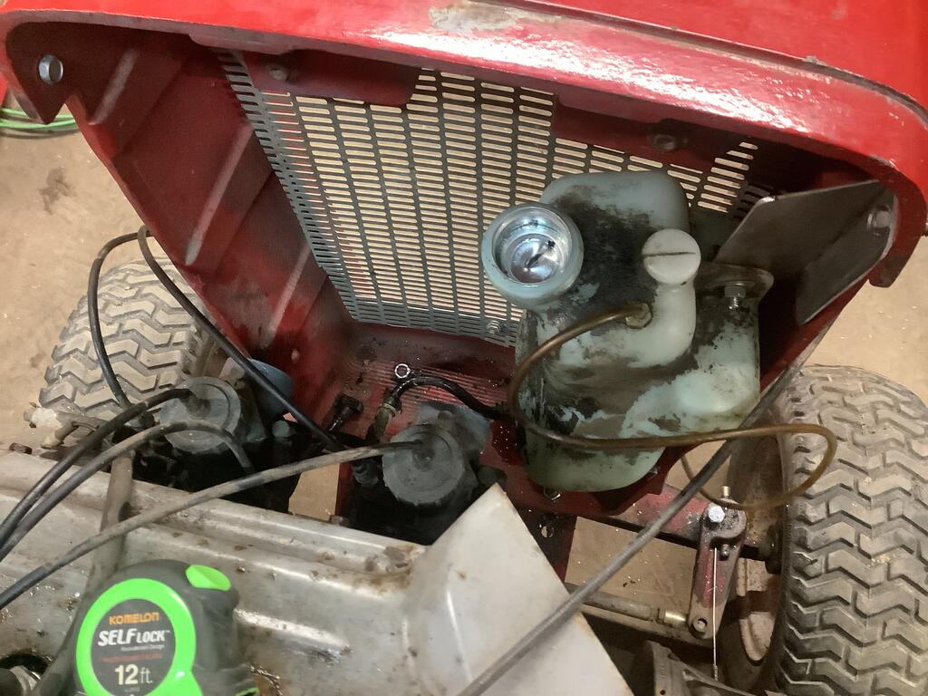

Oil tank is mounted.  Should be plenty of room for the air filters.  Looks like I need a cap from this parts sled’s parts sled!
