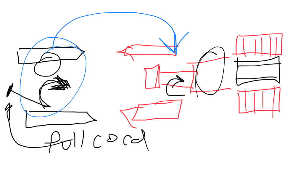

A not so amazing sketch.  Machines facing each other.  Engine should move directly over.  No rotation needed.

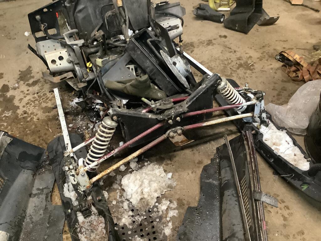

A quick video about the steering upgrades.  It might not matter.  It might get a whole different front end.  I’m not sure yet.
There’s gotta be something useful here!
Some useless plastic is outta the way..

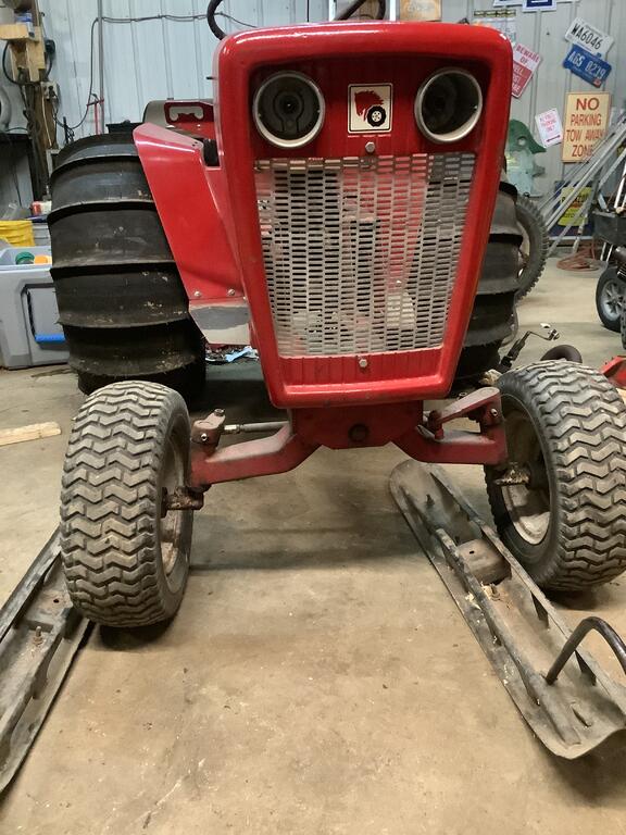

There’s a good chance most of this suspension and maybe steering gets grafted onto the 1054 frame.

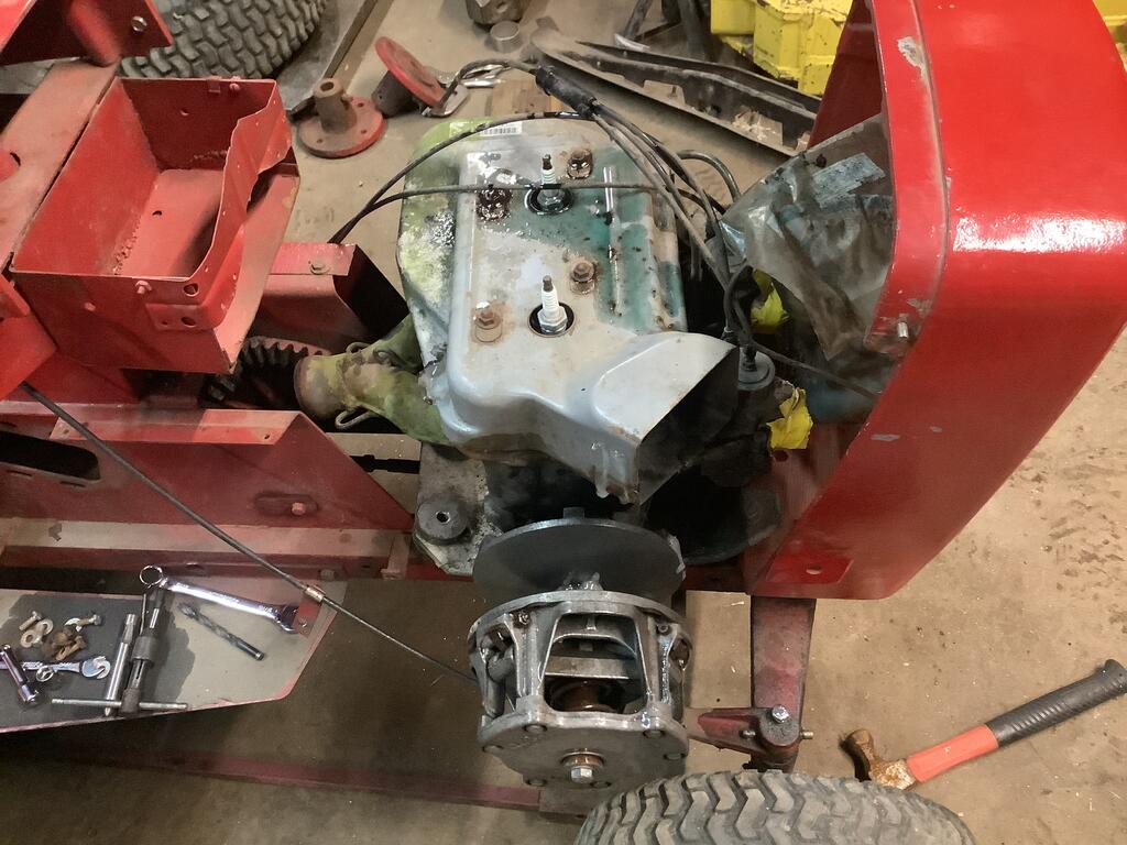

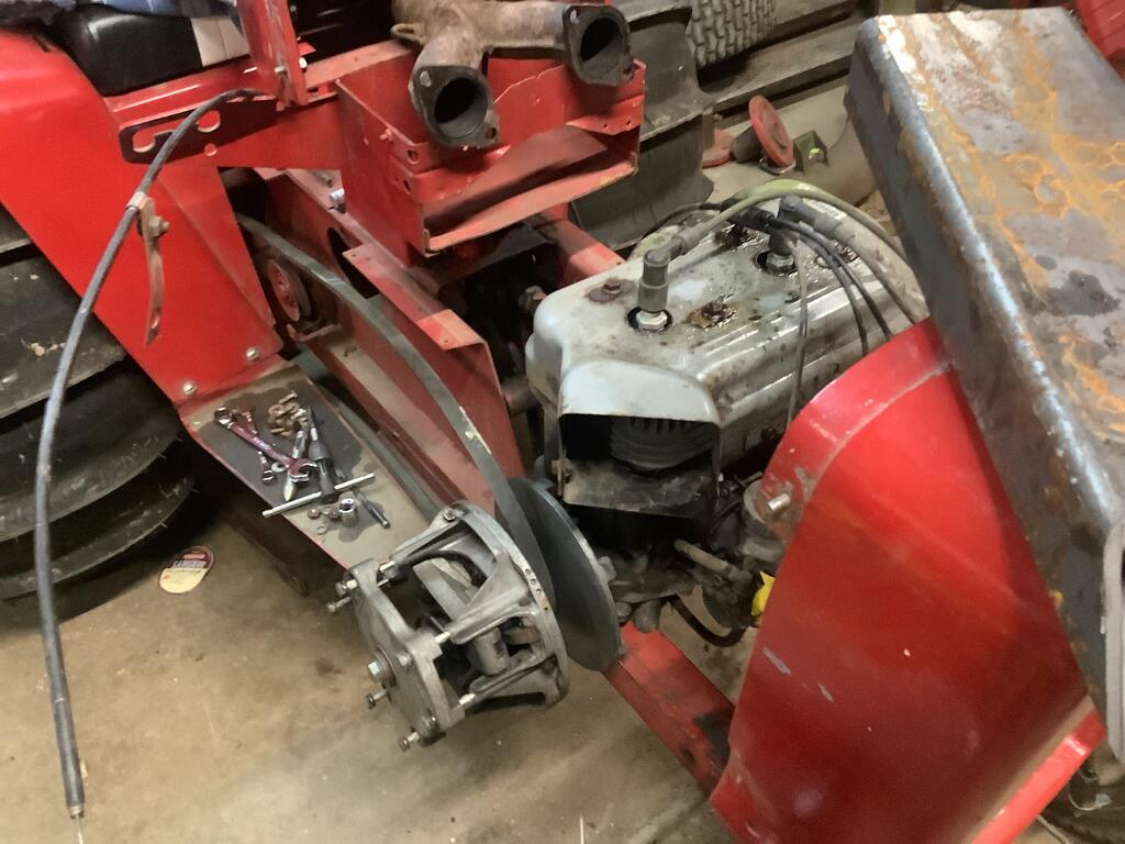

My conflict right now is whether to offset the engine centerline to line up the drive pulley, or run the snowmobile clutch system and use the driven clutch as a jackshaft, and if jackshaft is the way to go, where to re-route the steering.
:text-yeahthat:
That is what I did with my 457. Unfortunately, the engine was so wide... I had to offset it to line up with the drive pulley. I thought that it was going to look a bit odd... but with the exhaust and such, only I notice/know that it is offset.
I had to adjust it several times to keep ensure that it was lined-up. Also, as you probably imagine... you will need to find the belt size... which... for some odd reason I am good at guessing at... :dunno:
Also, I would recommend grade-8 bolts to hold that booger down... :)
Don

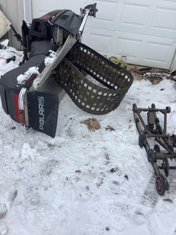

I like the fact that the polaris 440 has needle bearing supported crank with roller bearing crank journal. :banana-dance:
Image 2 - Polaris 98-00 XCR XC SP 440 00-04 500 600 XC SP RMK Crankshaft 2202257 2201234

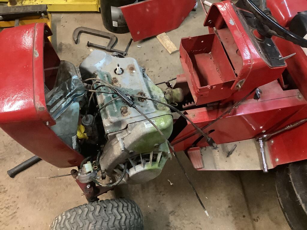

I’m playing with motor mounts and belt alignments and whats nots today.  I think direct drive with no clutch pedal is going to work!
This might loose all brakes, potentially. :auto-swerve:

Oldskool
Was the pedal originally on the "passenger side"?
no. There’s still a pedal “driver’s side” so I suppose I could just trim the clutch arm off or use a shaft locking collar.
