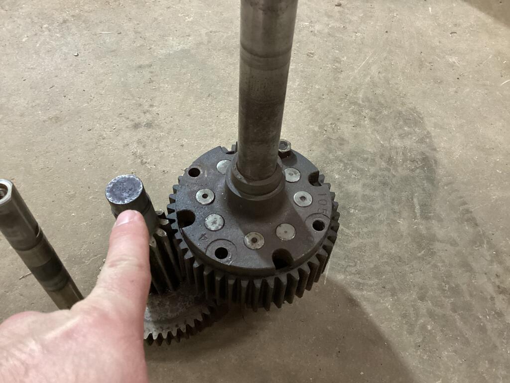

@wallfish. I don’t get this.  I think you’re right, but this tells me we’re wrong?
This is a 3 speed.  Does the brake shaft spin opposite the speed?  I think it does.  Then, what would that do to my calculations and gear ratios?
wallfish
You would be good spinning that brake shaft backwards. It clearly spins backwards so there's another gear inside or one less. The brake band also works that direction confirming it's rotation direction is backwards

Now I need to count the gears on a 3 speed to figure out the ratio.  More mathin’ coming right up!

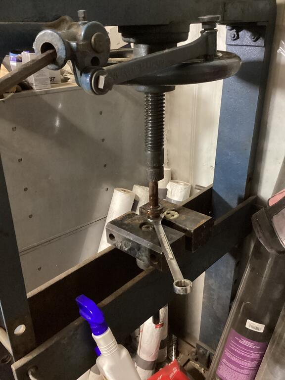

The donor pillow bearing is being pressed off the shaft.  Rusty, but fairly free.  The shaft and collar that is, the bearing is greased and smooth.

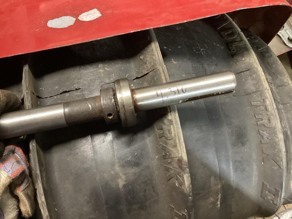

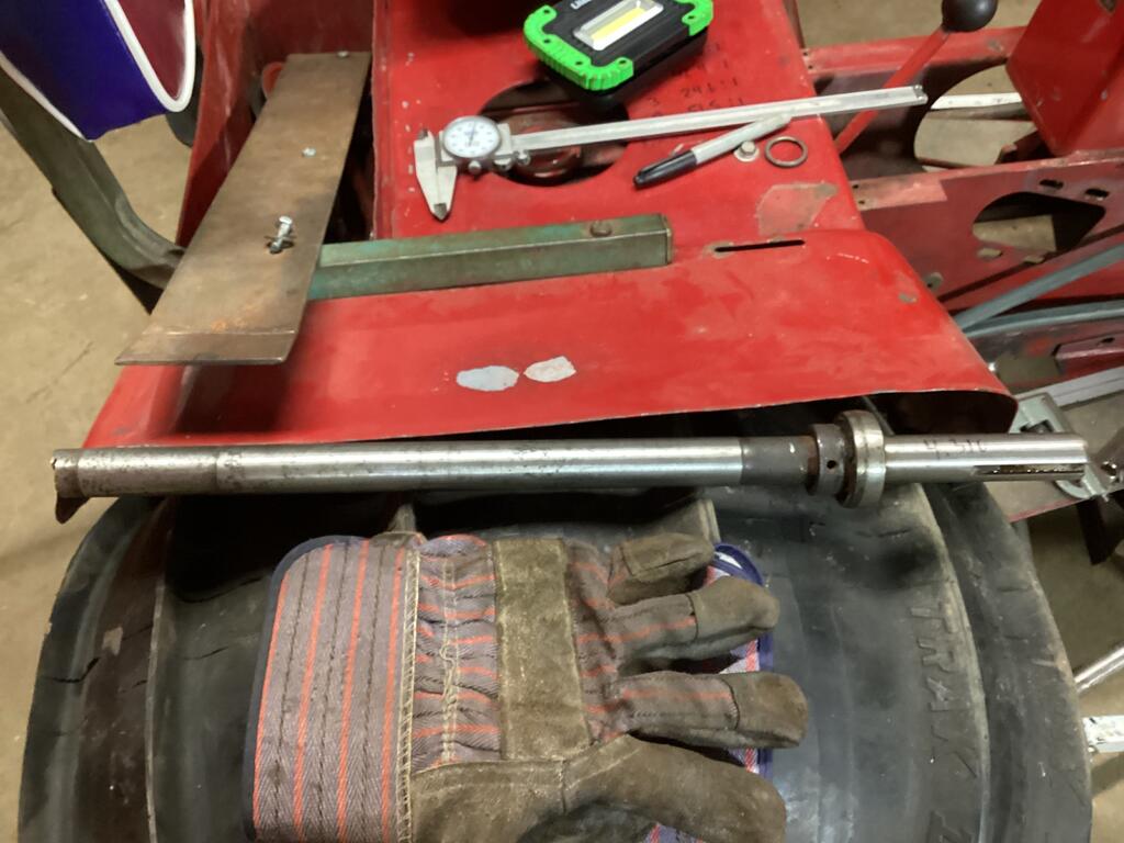

The jackshaft is not a true 1” across.  It is 1.030” in the center.  I need to press the bearing off this shaft in order to chuck it up in the lathe and turn it down.  Notice between some years, the Jack shaft went from a keyed hub to a splined hub.  For reference, the bearing is 4.310” from the end of the shaft.  I am not sure if it’s on a shoulder or not at this time.

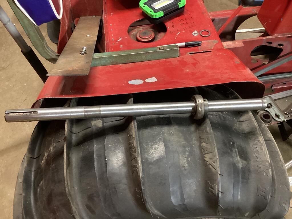

The shaft is cleaned up and turned down.

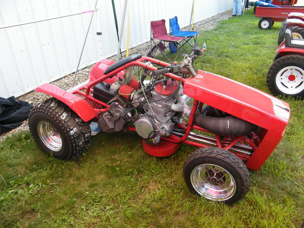

Maybe @joebob can help here Kevin.  This is his "Ice Racer".  It's a rocket.
  • Heart 1
