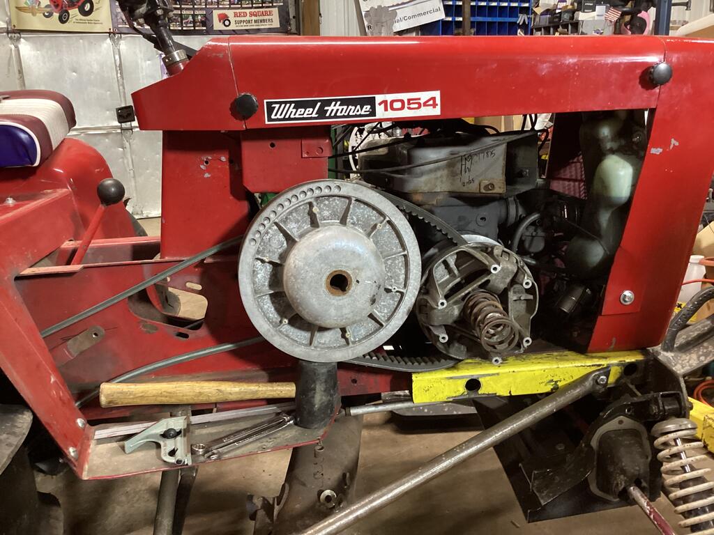

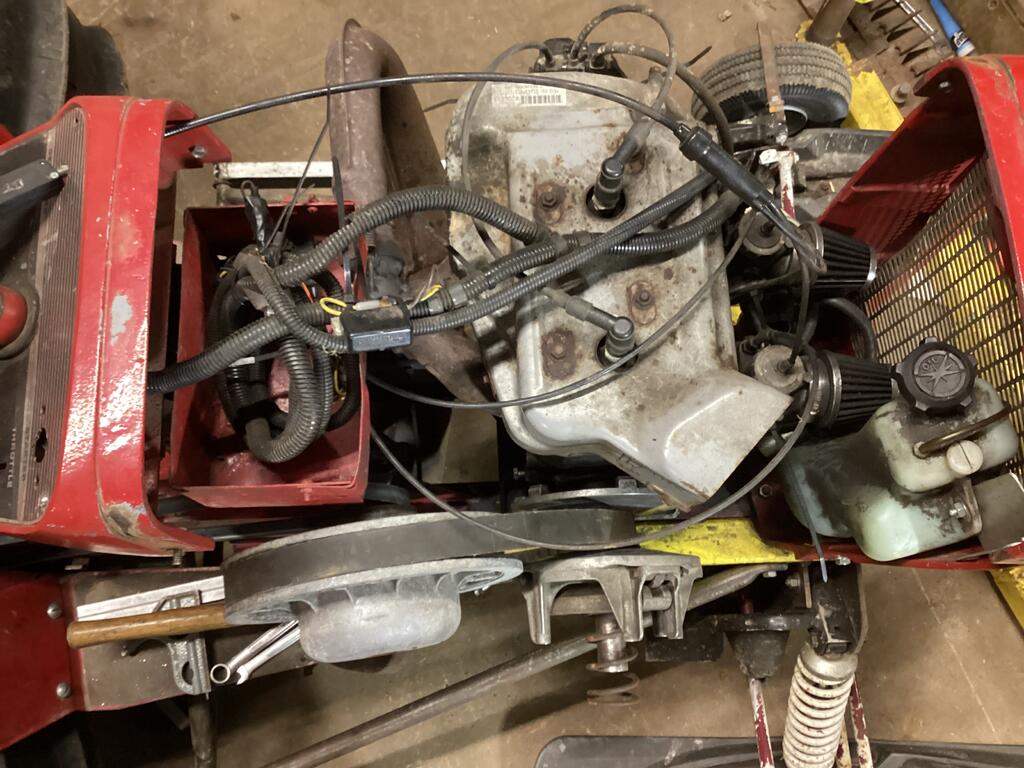

I’ve been fretting the fact that the steering shaft is about 12” from the center of the crank, the precise location the secondary clutch needs to be hiding in.  Well, I had an aha! moment tonight.  The secondary can be ABOVE the shaft!
Wild Thing!  You make my heart sing!
I love Polaris powered Snowmotractors!  The secondary clutch rides on a 1” keyed shaft.  How convenient!
Something tells me I’ll need to slide the engine to the passenger side a bit.  I’ve got tools for that!
Achto
I think you're going to be much happier with this set up when you're done.
Me too!  Now I need an Engineer that is good at matching math to help me figure the transmission drive pulley size.  @8ntruck?  You out there Bill?
Me thinks a 1:1 drive on the transmission would be a good start.  Something like a 6” pulley on the secondary clutch shaft and run the stock 6-1/4” pulley on the transmission for now.  The primary/secondary will be a huge adder to the system, getting low end rotation speeds.  I’ll think hypothetically here and assume a 4” engine pulley driving a 10.5” secondary pulley.  It could vary to a 7” pulley and we’ll assume a 6” pulley once the secondary opens fully.  Max engine speed is 8,000 rpm but we’ll assume a stall speed on the primary around 3,000 for acceleration purpose.  Quoting @MikesRJ here are the transmission ratios (using HI only) and the tire diameter is 30”.
