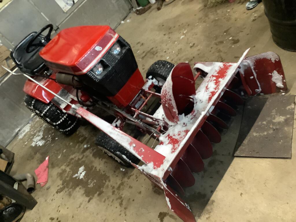

Pullstart 68,883 #1 Posted January 24, 2022 So. Rylee was plowing with Chloe and I was blowing piles back with the 310-8 (Magnum). I popped into a pile she plowed up and pop!bang!backfire!stall! Trying to restart, more backfires and pops. My guess, the snowblower stalled out the engine just enough to shear the key. Thoughts? Share this post Link to post Share on other sites

Pullstart 68,883 #23 Posted January 25, 2022 31 minutes ago, WHX?? said: Sounds great to me... you sure there WAS a problem? Or are you just "hosen" us?!??! It surely was broken. Well, stalled out at least. Rylee helped me drag and push it out of the snow and into the garage. Share this post Link to post Share on other sites
