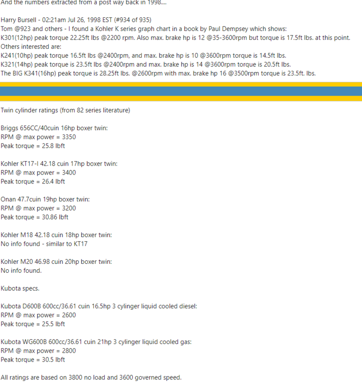

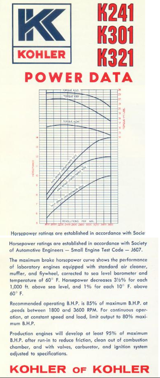

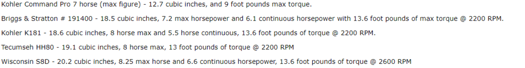

sgtsampay 164 #37 Posted January 25, 2022 (edited) Some more details to confuse people. Edited January 25, 2022 by sgtsampay 1 Share this post Link to post Share on other sites

RED-Z06 2,720 #39 Posted January 25, 2022 I dont put a ton of faith into manufacturers power info and curves, let us not forget the massive industry wide class action suit that every manufacturer got dinged for misleading people on power ratings for decades. Always thought it was odd that a 15, 16, 17 and 18hp briggs shared the same 28ci block, same head part number, same cam, carb, etc. You can make a dyno graph look really good or really bad by tweaking a few variables 4 Share this post Link to post Share on other sites
