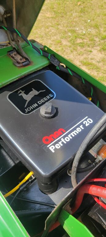

Snoopy11 5,731 #4 Posted January 24, 2022 That's got an Onan in it, correct? NICE... Don 1 Share this post Link to post Share on other sites
RED-Z06 2,718 #5 Posted January 24, 2022 Im hoping this one doesn't have "the governor problem" but darned if i dont think it might... Share this post Link to post Share on other sites
RED-Z06 2,718 #6 Posted January 24, 2022 Onan P220G, 2spd Eaton90, 874hrs. 1 Share this post Link to post Share on other sites

RED-Z06 2,718 #14 Posted February 4, 2022 Got the engine ready to hoist out today, things i need to do while its out... Replace governor spacer Inspect why the starter sounds so awful Adjust valve lash Inspect intake for leaks (prevention) Pull heads and Inspect valve seats/bores. Change oil and filter Share this post Link to post Share on other sites
RED-Z06 2,718 #15 Posted February 9, 2022 Engine is out, start to finish it was out in about 20 minutes, got it torn down this afternoon, plastic spacer came off too easy, i heated the steel new one, cleaned all the mating surfaces and put it on..a few hammer strikes it was seated in. Cleaned my balls up, and my cup..😐, and assembled it back, ensuring the hole was at 3oclock. Also chanced the flywheel side crank seal. Valve lash is all over, ill set it tomorrow..one valve has no lash at all. The only problem i encountered is, it ate a screw at some point, right side piston took a beating but looks superficial. Share this post Link to post Share on other sites
RED-Z06 2,718 #16 Posted February 12, 2022 Mostly done...runs like new now 4 Share this post Link to post Share on other sites

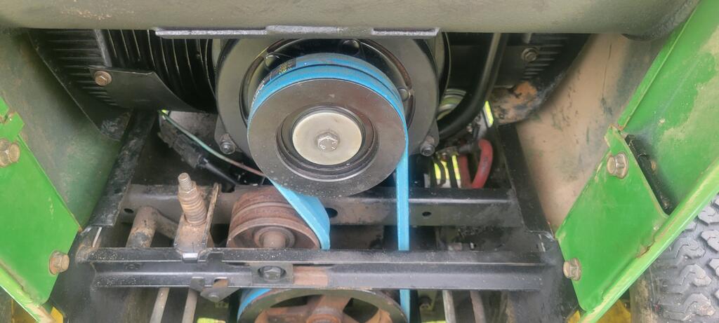

Handy Don 17,212 #18 Posted February 12, 2022 2 hours ago, RED-Z06 said: Very nice work, These are very nice machines, especially with the triple hydraulics and PS like this one has. Never did like the front belt routing that powers the mower deck though, a common problem with longitudinal engine placement. Enjoy it! 1 Share this post Link to post Share on other sites
RED-Z06 2,718 #19 Posted February 12, 2022 8 minutes ago, Handy Don said: Very nice work, These are very nice machines, especially with the triple hydraulics and PS like this one has. Never did like the front belt routing that powers the mower deck though, a common problem with longitudinal engine placement. Enjoy it! This one has a shaft driven deck off the front pto, Twin belts down to a pulley on a shaft. The 316/318 had the mule drive similar to wheel horse with twisted belts 1 Share this post Link to post Share on other sites
Handy Don 17,212 #20 Posted February 12, 2022 (edited) 14 hours ago, RED-Z06 said: This one has a shaft driven deck off the front pto, Twin belts down to a pulley on a shaft. The 316/318 had the mule drive similar to wheel horse with twisted belts Do you have a picture of that you can share? Sounds interesting. Thanks Also just noticed the separate rear wheel brake discs (you didn't post a right side image so I didn't see the pedals ). Edited February 12, 2022 by Handy Don Share this post Link to post Share on other sites
RED-Z06 2,718 #21 Posted February 12, 2022 28 minutes ago, Handy Don said: Do you have a picture of that you can share? Sounds interesting. Thanks Also just noticed the separate rear wheel brake discs (you didn't post a right side image so I didn't see the pedals ). This gives it a 2000 rpm front or mid shaft driven pto 1 Share this post Link to post Share on other sites

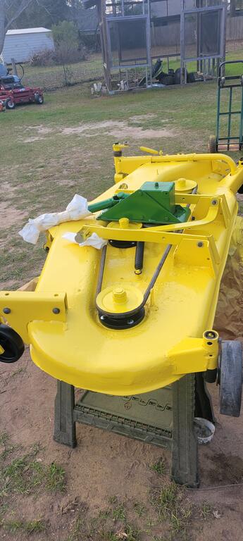

RED-Z06 2,718 #22 Posted February 24, 2022 Tractor itself is nearly complete...engine runs like a top. Deck is...very rough, ive got it stripped down bare, refinished the spindles, brackets, temsioner, pulleys, stripped the hardware, new gauge wheels...waiting on supplies for the shell itself 1 Share this post Link to post Share on other sites
