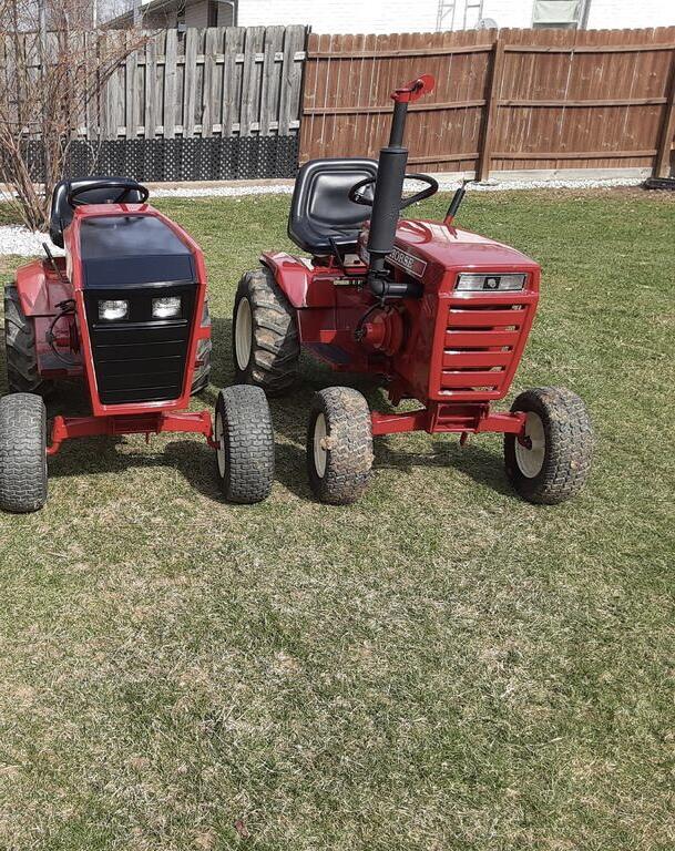

Horse Newbie 7,405 #26 Posted March 13, 2022 12 minutes ago, briankd said: used fine line tape the body shop at work uses Maybe the surface wasn’t quite right to accept the paint… those spray bombs can be a pain. I use spray bombs and sometimes it’s like rolling the dice… sometimes you win, sometimes you lose… Most times I can get it good enough for me though… yours looks good ! 1 Share this post Link to post Share on other sites
briankd 833 #27 Posted March 14, 2022 22 hours ago, Horse Newbie said: Maybe the surface wasn’t quite right to accept the paint… those spray bombs can be a pain. I use spray bombs and sometimes it’s like rolling the dice… sometimes you win, sometimes you lose… Most times I can get it good enough for me though… yours looks good ! this is my first rattle can paint job . I'm not thrilled with the result's . my other 2 tractors the body shop guy were I work sprayed them I bought the paint . this one here just a quicky job I am going to mow with it this year just wanted something that looked decent for now . the hood was a little rough before painting it probably will get some scratch's here and there over time and i may completely tear it down and paint it right in the future. the black was rust oleum machinery spray bomb and it started spitting bits out of can something like specks of sand when i was half done spraying nothing i could do but re sand and start over but i wasn't going to need to get it done 1 Share this post Link to post Share on other sites
briankd 833 #28 Posted March 17, 2022 well it runs got it out and run it around the yard a bit . it does smoke some but the more it ran it cleared up some . don't know how long this sat before i got it it sat in my shed bout a year . ran great after i got the carb adjusted right and adjusted the hydro so it wouldn't creep in neutral . reve'd it up and once it hit high r.p.m. it wanted to go . now it work's like it should . need to get decals on it and the hood strap's and fix the paint that messed up on hood . then put the 48" deck to it . fixed theses headlight bulbs so they fit tight and won't move fabed a peice up after seeing a massy garden tractor and used a connector nut on stud and bolted bracket down also ran a ground wire all the way to lights got a group picture but my 857 buried in the garage it didn't make the picture it sleeping for the summer since it my snow pusher sorry about the green thing it had to get in on the action also was y nice day out today temps in the 70's so i got some seat time in on my C 120 rolling the yard 2 4 Share this post Link to post Share on other sites
