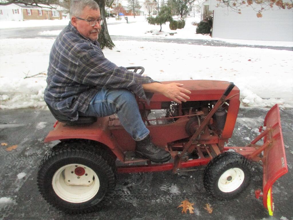

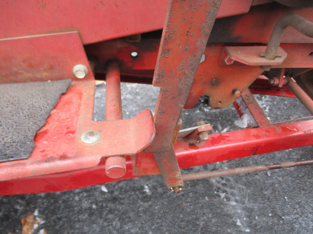

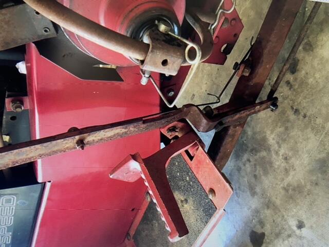

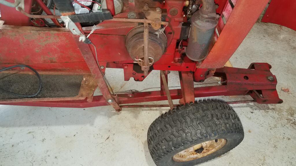

Inspectorjoe 473 #1 Posted January 19, 2022 I planned on outfitting two tractors with snow blades, a 1974 C-120 Automatic. and a 1973 14 Automatic. The two plow frames I have are identical. They look like they will fit long frame tractors. The frame handle on the C-120 just touches the footrest when it's angled to the left, but when it's angled to the right, the handle and release cable hit the PTO clutch assembly. Also, it's so far forward, I can't possibly reach it from the seat. On the No-name, when the blade is in the center position, the handle touches the footrest. There's no way it can be angled left. Am I doing something wrong or do I have the wrong plow frames? 1 Share this post Link to post Share on other sites
Ed Kennell 46,980 #2 Posted January 19, 2022 I believe you have the correct plow frames for your tractors, but there are several different blade angle levers. Sometimes you have to modify to fit. On my 312H I had to flip the lever around and insert a spacer to get it to clear everythig. On my 520H, I wanted the lever inside the cab. I don't like cold. So I cut bent and welded. 6 1 Share this post Link to post Share on other sites
ebinmaine 80,278 #3 Posted January 19, 2022 2 hours ago, Ed Kennell said: I believe you have the correct plow frames for your tractors, but there are several different blade angle levers. Sometimes you have to modify to fit. I'm with Ed. In fact I think it looks like a PO did just that on both of your setups. The one that touches the PTO looks like it's been bent in the past and possibly even installed backwards. The other one I can't tell for sure. Maybe home made or also modified. 3 Share this post Link to post Share on other sites
squonk 47,887 #4 Posted January 19, 2022 Your 3rd pic. I see a weld on that lever by the floorboard. Definitely modified. 1 Share this post Link to post Share on other sites
daveoman1966 3,884 #5 Posted January 19, 2022 In your 1st & 2nd pic, the flat bar Index lever(#20 here) is on backwards. The cut-away notch s/b forward...allowing that lever to tilt back so tou do'nt strain your milk trying to reach it. (ps..I had made other notes on this pic that you can disregard .) 2 1 Share this post Link to post Share on other sites

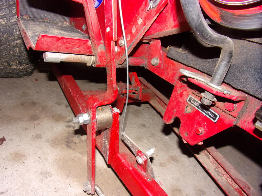

OutdoorEnvy 1,817 #6 Posted January 20, 2022 (edited) Joe your handle is flipped backwards. Take it off the frame and turn it 180 degrees. Your wire cable from handle lever should run through the eye loop on the inside. See my pic as it appears your same handle Edit: you’ll need flip around the squeeze lever too on the handle. Good luck with it! Edited January 20, 2022 by OutdoorEnvy 4 Share this post Link to post Share on other sites
Ed Kennell 46,980 #7 Posted January 20, 2022 But you will have to get rid of the bend that is not factory. Just a note, I had to put my lever on backwards and use a spacer to clear the foot pedal motion control on all my hydros. 2 Share this post Link to post Share on other sites

Inspectorjoe 473 #9 Posted January 21, 2022 Thanks for the help, everyone. On 1/19/2022 at 7:03 PM, OutdoorEnvy said: Joe your handle is flipped backwards. Take it off the frame and turn it 180 degrees. Your wire cable from handle lever should run through the eye loop on the inside. See my pic as it appears your same handle Edit: you’ll need flip around the squeeze lever too on the handle. Good luck with it! I thought the handle might have been installed backwards when I saw the eye on the opposite side of the rod, but wondered why the squeeze lever would be reversed. I guess the guy I got it from made it fit whatever he had it on that way. Share this post Link to post Share on other sites

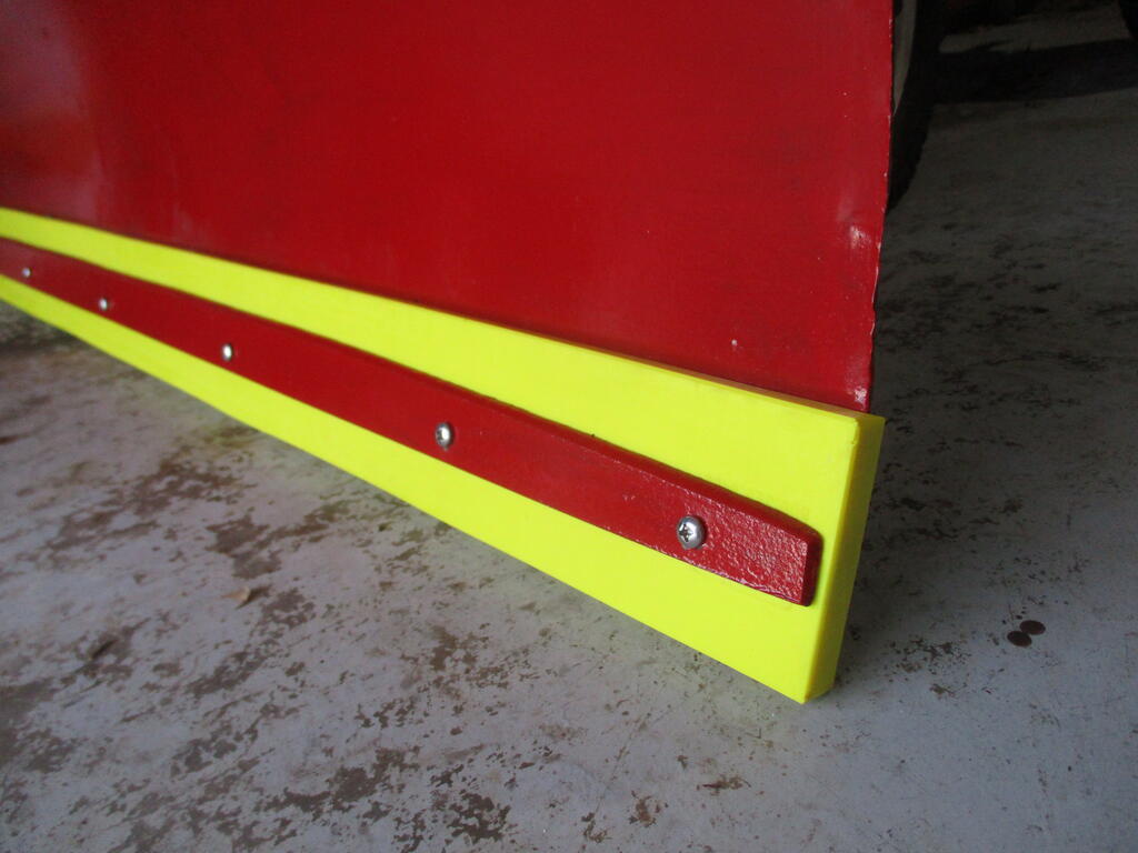

SylvanLakeWH 32,135 #17 Posted January 22, 2022 What are you using as wear bars? Look like plastic…? Share this post Link to post Share on other sites
Inspectorjoe 473 #18 Posted January 22, 2022 1 hour ago, SylvanLakeWH said: What are you using as wear bars? Look like plastic…? 3/4" polyurethane made by FallLine. It was obscenely expensive, but I had great luck with one I bought in 2017, so I bit the bullet and shelled out the bucks. This 60" one (that I cut down to 54" was $119 + $22 shipping +$8.46 tax for a total of $149. 46. By comparison, the 48" one I bought in 2017 for $58 costs $91 today. This is from Amazon, but they're priced a little cheaper directly from FallLine. I don't recall why I didn't but directly from FallLine in 2017. One reason may be that they don't tell you the shipping cost until after it ships. I just went with Amazon again for the 60" one because it was a one-click process. 2 1 Share this post Link to post Share on other sites
