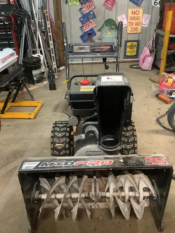

Pullstart 68,761 #1 Posted January 19, 2022 I’ve been tinkering with stuff that I wouldn’t mind unloading in the near future. This one, if I can’t get it to run right, might just end up as a trash heap project of sorts… @Gregor / Casper style. I really like the tires for the front of a worker Horse… that’s another reason I’m not terribly attached to it. Share this post Link to post Share on other sites
Achto 30,844 #2 Posted January 19, 2022 9 minutes ago, Pullstart said: I really like the tires for the front of a worker Horse I have those tires on the front of my snow plowing tractor. Love 'em!! 2 Share this post Link to post Share on other sites

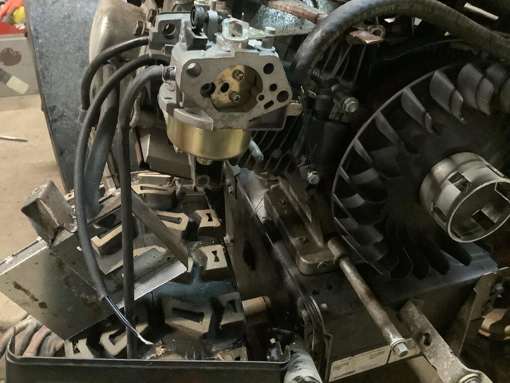

Pullstart 68,761 #3 Posted January 19, 2022 Initial inspection? Out of gas. Can’t be that easy AGAIN! One of my last dead on arrival jobs was a lack of explosivous liquidous. 2 1 Share this post Link to post Share on other sites
Pullstart 68,761 #4 Posted January 19, 2022 Also, no spark. There it is. I’ll pull the flywheel shroud and investigate. 1 Share this post Link to post Share on other sites
Pullstart 68,761 #5 Posted January 19, 2022 My guess… is that the answer to no spark lies in this photo. 3 Share this post Link to post Share on other sites
Pullstart 68,761 #6 Posted January 19, 2022 Sure enough. Some repair shop twisted the kill wires together and duct taped them off. When they couldn’t “fix” this junk, they sold her an $800 machine. Sad. 3 Share this post Link to post Share on other sites
Achto 30,844 #7 Posted January 19, 2022 (edited) 15 minutes ago, Pullstart said: My guess… is that the answer to no spark lies in this photo. Just crimp an alligator clip on to that wire, clip it back on to the spark plug & you'll be good to go. Never mind, now I see that it is the kill wires that were "Shoe Maned" Edited January 19, 2022 by Achto 1 1 Share this post Link to post Share on other sites
Achto 30,844 #8 Posted January 19, 2022 So you separated the wires and now you have spark, right? 2 1 Share this post Link to post Share on other sites

Achto 30,844 #15 Posted January 19, 2022 (edited) @Pullstart just watched the video, seems to run great. Pisses me off that a shop would trick someone into buying a new machine like that. I would be telling everybody that I know about how they do business. As for the head light on that blower. If it is like my Ariens and most others that I have worked on, it will be AC power not DC power. So the wires can not be grounded. To check this disconnect the wires and test them with a multi meter when the engine is running. BTW - I see the blue can that you used to fill the tank. Didn't know that they made a blower that runs on kerosene???? Edited January 19, 2022 by Achto 1 Share this post Link to post Share on other sites
Pullstart 68,761 #16 Posted January 19, 2022 31 minutes ago, Achto said: @Pullstart just watched the video, seems to run great. Pisses me off that a shop would trick someone into buying a new machine like that. I would be telling everybody that I know about how they do business. As for the head light on that blower. If it is like my Ariens and most others that I have worked on, it will be AC power not DC power. So the wires can not be grounded. To check this disconnect the wires and test them with a multi meter when the engine is running. BTW - I see the blue can that you used to fill the tank. Didn't know that they made a blower that runs on kerosene???? Well, the light must be a shop fix too. It’s grounded. 2 Share this post Link to post Share on other sites

Pullstart 68,761 #19 Posted January 21, 2022 On 1/19/2022 at 6:03 PM, Achto said: As for the head light on that blower. If it is like my Ariens and most others that I have worked on, it will be AC power not DC power. So the wires can not be grounded. To check this disconnect the wires and test them with a multi meter when the engine is running. I’ll look for my meter(s) yeah they both grow legs or I’m having a long continuous doh! moment… but at least the bulb is 12v. I should have looked, but maybe it has a reg/rect. in the shroud? 1 Share this post Link to post Share on other sites
