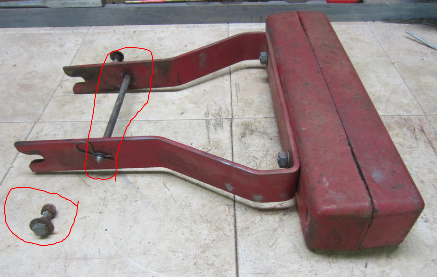

wh5208speed 677 #1 Posted January 19, 2022 Does anyone know the part numbers for the pin that goes thru the frame & the two bolts that allows the bracket to slide onto? Thanks Thad Share this post Link to post Share on other sites
Achto 32,844 #2 Posted January 19, 2022 (edited) 44 minutes ago, wh5208speed said: Does anyone know the part numbers for the pin that goes thru the frame & the two bolts that allows the bracket to slide onto? I do not but it looks like some 3/8" round stock, a couple of hair pins and a couple of bolts would get you set up though. Edited January 19, 2022 by Achto 2 Share this post Link to post Share on other sites
ebinmaine 80,935 #3 Posted January 19, 2022 2 minutes ago, Achto said: I do not but it looks like some 3/8" round stock, a couple of hair pins and a couple of bolts would get you set up though. Agreed. Wheelhorse used many "standard parts". The bolts are likely grade 5 3/8 coarse by 1-1/4" or 1-1/2". The pin should also be 3/8" . Maybe 8" long (?). Could be a little shorter. 2 Share this post Link to post Share on other sites

Herder 2,356 #5 Posted January 19, 2022 They are very similar to the rods that hold the trip springs in place on the dozer blades, provided you have one it may be worth the comparison. Threaded rod with nuts will work too. 1 Share this post Link to post Share on other sites
