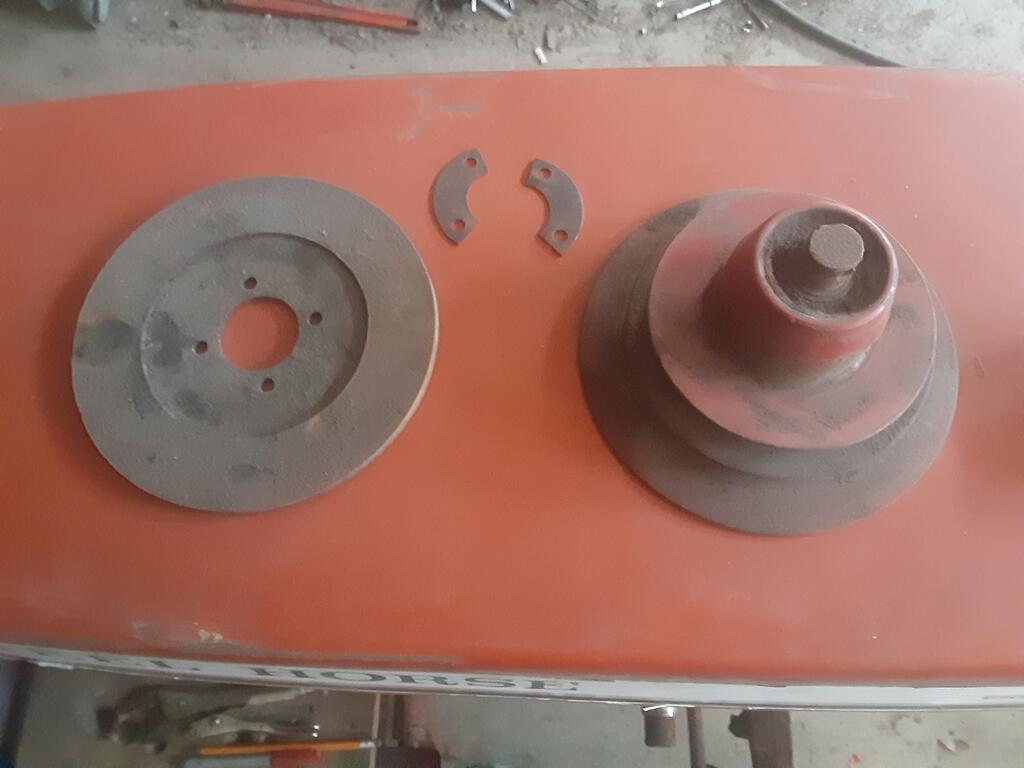

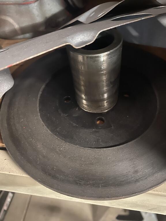

Heatingman 977 #95 Posted September 16, 2022 (edited) On 1/21/2022 at 12:08 PM, Oldskool said: After such a good start things have kinda come to a temporary stop. Parts and info collection will still carry on. I would like to put a PTO clutch on this build in hopes of having some hydraulics for various tasks. To start with its probably going to require a custom pulley of sorts for the transmission drive belt. This is where the questions begin. I have alot of the linkages and im sure I will have to fab a few as well. I have these parts indicated in the pic. What am I missing as far as the clutch itself goes? Also how much shaft should be sticking out past the pulley for this to be functional? The needle bearings of the the pto bell ride on a shaft extension/bushing that is held in place by those 2 crescent parts. could be made on a lathe with the right skill set You can see the groove that the crescent clips would slot into. Edited September 16, 2022 by Heatingman Share this post Link to post Share on other sites
Oldskool 6,678 #96 Posted September 16, 2022 14 minutes ago, Heatingman said: The needle bearings of the the pto bell ride on a shaft extension/bushing that is held in place by those 2 crescent parts. could be made on a lathe with the right skill set You can see the groove that the crescent clips would slot into. Thanks for that info. I think this build has drifted very far from its original intent. Whatever comes out of this mess probably won't have a pto on it. Share this post Link to post Share on other sites

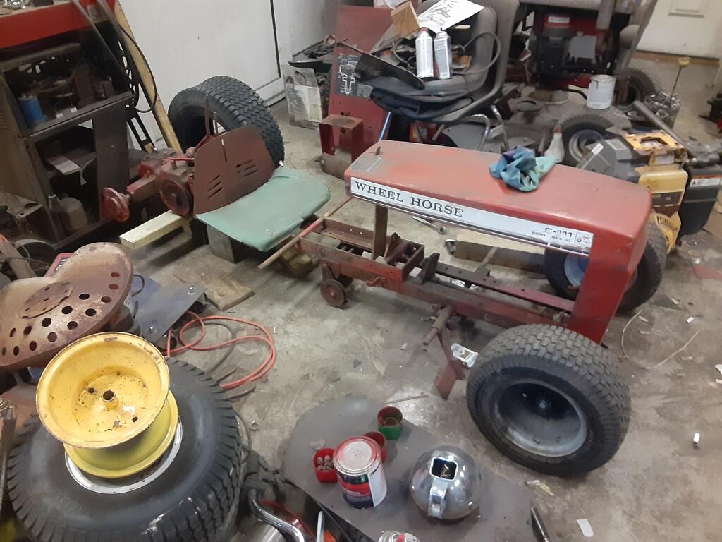

Oldskool 6,678 #97 Posted September 17, 2022 So sliding stuff around on the floor, this mess is where things ended up before supper. Thinking this may end up as a C cab T bucket style tractor. Things may change again before tomorrow comes to an end lol 2 1 Share this post Link to post Share on other sites
