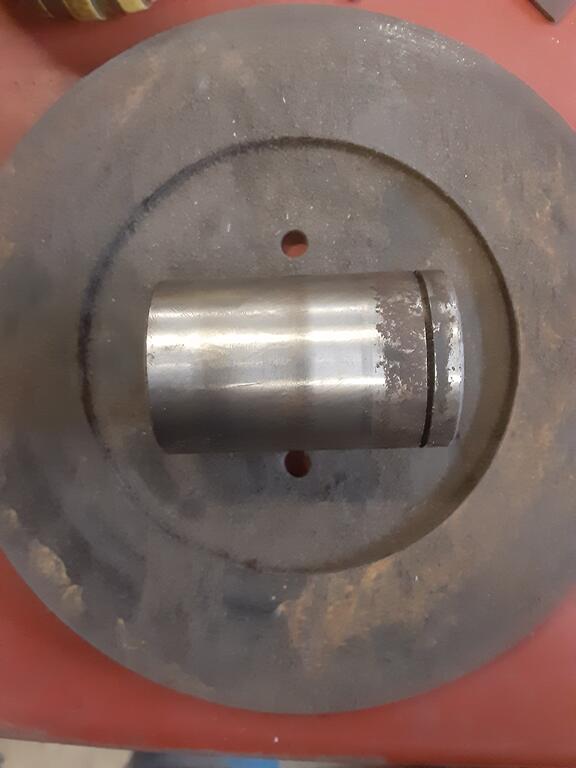

kpinnc 19,036 #51 Posted January 22, 2022 If you know a decent machinist, you could have a sleeve made up with internal threads that butts up against the largest shoulder there. Just an idea. No clue how good an idea or not... 3 Share this post Link to post Share on other sites
Oldskool 6,678 #52 Posted January 22, 2022 4 minutes ago, kpinnc said: If you know a decent machinist, you could have a sleeve made up with internal threads that butts up against the largest shoulder there. Just an idea. No clue how good an idea or not... It is a good idea. Unfortunately that section of the shaft is to large of a diameter for the clutch to fit. The shiny section of the shaft is the correct size for the clutch. Share this post Link to post Share on other sites

Oldskool 6,678 #59 Posted January 22, 2022 7 minutes ago, cafoose said: Just a thought could you drill out the side of the pulley towards the engine the depth and diameter of the shoulder so the pulley goes closer to the engine? The pulley actually has a large enough hole in it already to clear the shoulder. When installed it's going to be really close to the case as it sits. Also as things sit, the engine fits under the hood without any trimming. Share this post Link to post Share on other sites

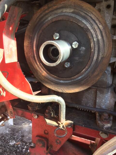

wallfish 20,724 #62 Posted January 22, 2022 The sleeve is just the inner race for the bearing Your pic shows the pulley groove next to the block so the shoulder shouldn't need to be modified but that pulley looks wide. What about a single groove pulley that goes right on that shoulder? It would still need to be keyed to the shaft but that seems to be the case for any pulley since that shaft doesn't have a keyway. But, that might give you more shaft outside of the drive pulley to work with. For extending the shaft if needed, could the threaded section be ground down to a smaller diameter and then threaded again to accept a shaft extension threaded on to the new smaller threads? Then the sleeve/race could span that connection for more support. Maybe even grind a V at the seem and weld it on too? Just think'n out loud again 1 1 Share this post Link to post Share on other sites
Oldskool 6,678 #63 Posted January 22, 2022 @wallfish I just bundled up so I could go check things out. I could mill off one of the grooves. That would probably give me just enough. I had thoughts of using the second groove but I can just use the second groove on the clutch. I'm hoping to have a hub built for the pulley this weekend. As for keying the shaft I'll just cut my own groove into it. 1 Share this post Link to post Share on other sites
Oldskool 6,678 #64 Posted January 22, 2022 Is the groove in this inner race just for looks or is there an outer snap ring that goes there? Share this post Link to post Share on other sites
wallfish 20,724 #65 Posted January 22, 2022 13 hours ago, Oldskool said: I was figuring it probably would do to the size of the cast iron vane it had screwed on it. When I removed the vane there wasn't any other supports for it. I could be guessing wrong. Besides wouldn't the trans drive belt kind of equal that out.? I guess with there being a belt I didn't really think it over as much as I would if it was chain drive. The vane pump load is centered on the shaft so it's a spinning load not a side load. It would be difficult to equalize any side loads 180 deg apart on the belts since the loads will change like driving up hill and or say, loading a blower full of snow. You may be able to add a sealed bearing under the pulley without opening the engine if you use that pulley with all the space under it. And you might be all set with that length of shaft if you can just thread something on those threads and machine it to the diameter if the shaft. Yes it will be thin but the race will be supporting it too. This is from the 520-HC 1 1 Share this post Link to post Share on other sites
wallfish 20,724 #66 Posted January 22, 2022 (edited) 25 minutes ago, Oldskool said: Is the groove in this inner race just for looks or is there an outer snap ring that goes there? That groove in the race goes towards the clutch plate and the 2 clips that bolt the clutch plate on to the pulley go into that groove to hold the race on. see the pic above with the 2 clips mounted in that race groove Edited January 22, 2022 by wallfish Share this post Link to post Share on other sites
Oldskool 6,678 #67 Posted January 22, 2022 @wallfish the shaft looks like it falls short of the end of that race by about an inch? Share this post Link to post Share on other sites

kpinnc 19,036 #69 Posted January 22, 2022 5 hours ago, Oldskool said: What's it's purpose other then being a shim? It provides an inner race to the bearing at the full length of the rollers, and holds the clutch plate on center as well 1 Share this post Link to post Share on other sites
wallfish 20,724 #70 Posted January 22, 2022 1 hour ago, Oldskool said: @wallfish the shaft looks like it falls short of the end of that race by about an inch? 3/4 1 Share this post Link to post Share on other sites

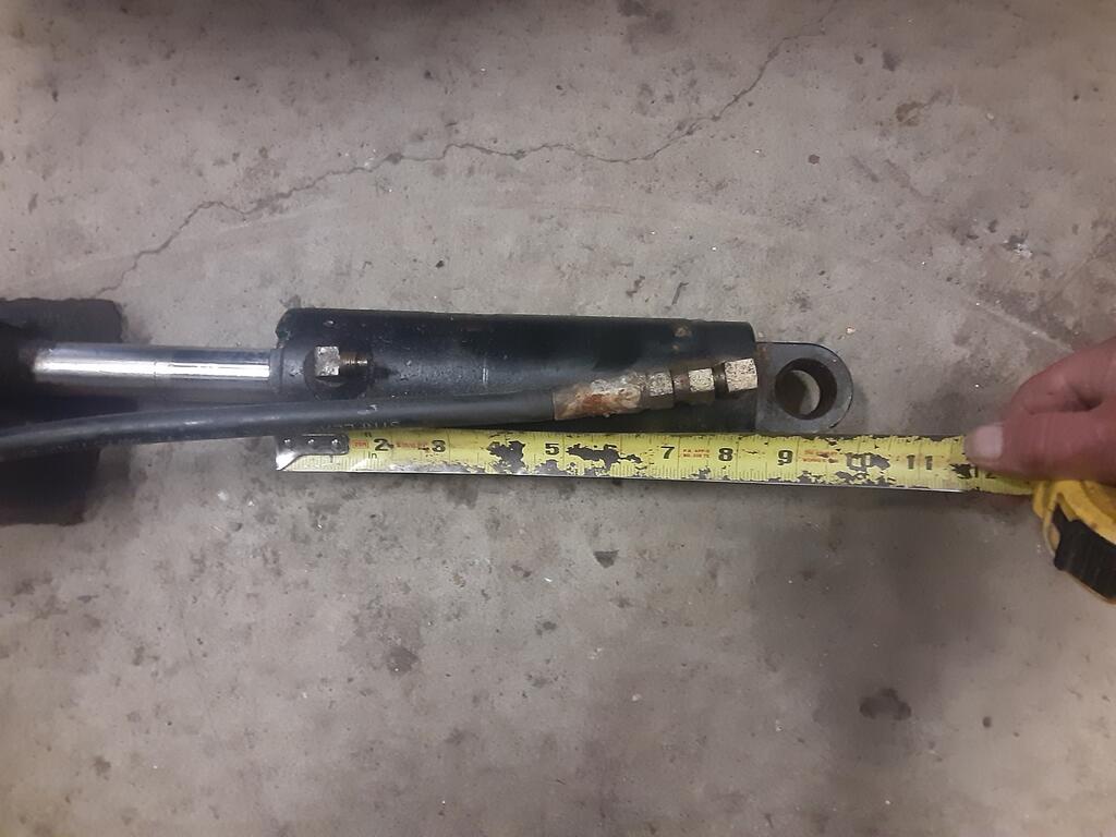

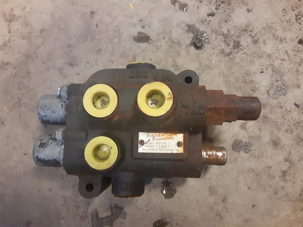

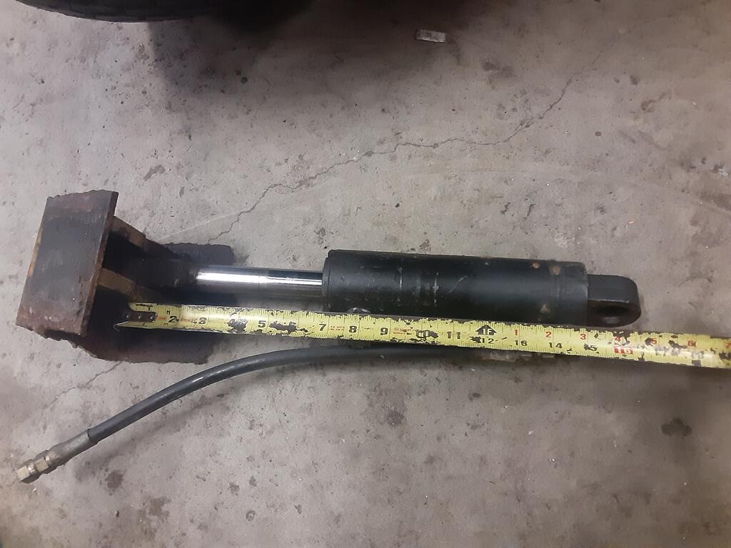

Oldskool 6,678 #71 Posted January 23, 2022 Been under the weather lately. Today felt well enough for a dig around in the parts pile. I do not even remember getting this little cylinder and I found 3 different control valves from Fisher plows, misc hoses, and a couple more plow pumps. I must be able to come up with something useful for this build. 1 1 Share this post Link to post Share on other sites
