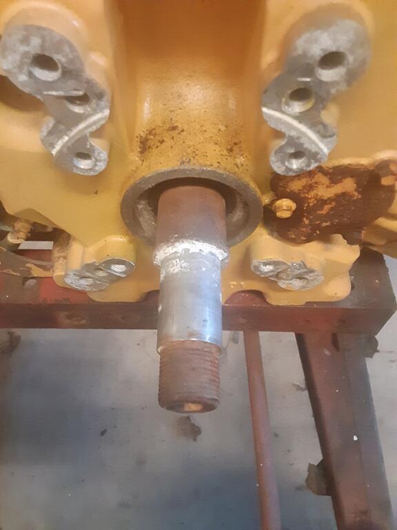

Oldskool 6,678 #39 Posted January 21, 2022 10 minutes ago, Handy Don said: (different diameters for gear and hydro drives) One quick thing to check is the diameter of the engine shaft and the inner race of the pro pulley cone are the same -- What would be a stock size for the engine pulley running the 8 speed? I did check the diameters. They are the same. The crank shaft on this is short so I'm hoping there is enough for the clutch. Do you know how much shaft the clutch requires? 1 Share this post Link to post Share on other sites
Handy Don 17,381 #40 Posted January 21, 2022 (edited) 7 minutes ago, Oldskool said: Do you know how much shaft the clutch requires? I don't. Never occurred to me to measure when I had the PTO off for cleaning servicing. I'd guess it was about 2" (it has to clear the innermost end of the thrust stub shaft, right?). You can estimate by checking using a caliper to measure from the outermost (away from the engine) lip of the main PTO bearing race to the plane of the clutch material facing and then add the depth of the engine-pulley-mounted plate. Hoping someone here has their's apart and can measure the exposed shaft left after the drive pulley is mounted and post some pictures. Edited January 21, 2022 by Handy Don 1 1 Share this post Link to post Share on other sites
Oldskool 6,678 #41 Posted January 21, 2022 Thanks Don @Handy Don . I think I will only have about an inch of shaft for that clutch to ride on. 1 Share this post Link to post Share on other sites
ebinmaine 80,461 #42 Posted January 21, 2022 8 minutes ago, Oldskool said: Thanks Don @Handy Don . I think I will only have about an inch of shaft for that clutch to ride on. There's an inner and outer bearing. You may be scant on space. Perhaps an electric clutch would be feasible if a manual one can't be used. 1 Share this post Link to post Share on other sites
oliver2-44 11,712 #43 Posted January 21, 2022 32 minutes ago, Oldskool said: I think I will only have about an inch of shaft for that clutch to ride on. Does the end of the shaft have a tapped hole? If so you could bolt on an extension, then ship the PTO inner race over it which would reinforce it some. 3 Share this post Link to post Share on other sites
Oldskool 6,678 #44 Posted January 21, 2022 23 minutes ago, ebinmaine said: There's an inner and outer bearing. You may be scant on space. Perhaps an electric clutch would be feasible if a manual one can't be used. That is a possibility but the 1-1/8 electric clutches aren't cheap at all. 1 Share this post Link to post Share on other sites
Oldskool 6,678 #45 Posted January 21, 2022 4 minutes ago, oliver2-44 said: Does the end of the shaft have a tapped hole? If so you could bolt on an extension, then ship the PTO inner race over it which would reinforce it some. I don't think it is tapped. I sure could change that real easily. Depending on how the pulley falls when made is a big factor for residual length. This engine ran a water pump originally so the shaft is not only on the short side but also has an integral shoulder an inch out from the case along with the shaft being externally threaded approx 1" of the outer end. 2 Share this post Link to post Share on other sites
ebinmaine 80,461 #46 Posted January 21, 2022 10 minutes ago, oliver2-44 said: Does the end of the shaft have a tapped hole? If so you could bolt on an extension, then ship the PTO inner race over it which would reinforce it some. I like the idea of this possibility. 9 minutes ago, Oldskool said: That is a possibility but the 1-1/8 electric clutches aren't cheap at all. You got that right. I don't think I've got anything like that kickin around but I'll take a look 2 Share this post Link to post Share on other sites

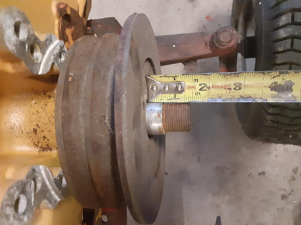

Oldskool 6,678 #47 Posted January 21, 2022 This is what I'm working with. This is what I may have after a pulley is installed 1 Share this post Link to post Share on other sites
Handy Don 17,381 #48 Posted January 21, 2022 Yeah, that does look tight and the threads aren't helping. Way over my pay grade to think about extending a crankshaft! 2 Share this post Link to post Share on other sites
