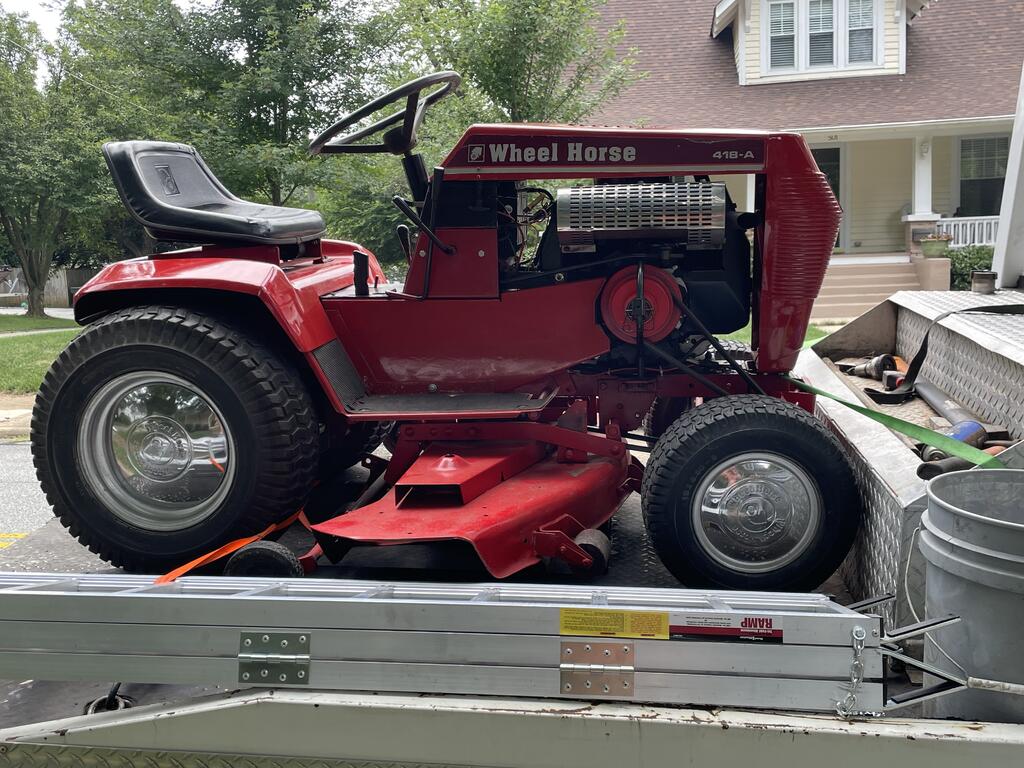

David417a 8 #1 Posted January 16, 2022 Hey I bought a 417a smokes oil when motor is under load. Steep inclines or heavy grass. I bought it last summer as the 312 was getting in need of some love. The 417 has around 600 hrs. Before I rebuild upper end is there anything I should consider? Lower hours and very clean machine. 4 2 Share this post Link to post Share on other sites

David417a 8 #12 Posted January 17, 2022 What’s odd about it? For a 30 year old tractor plus or minus looks good. The grill does need to get painted black. I did look at Lowe’s and Home Depot felt this would outlast any of them. Paid 600 for it, I would not hesitate to put 1000 into it. Plus shiny hubs😜 1 Share this post Link to post Share on other sites

WHX?? 55,016 #15 Posted January 17, 2022 Sure looks like a twin in there Paul and was guessing twin as the muffler type. Clearly says 418 on the hood tho. Can you get us a pic of the tag David? 1 Share this post Link to post Share on other sites
