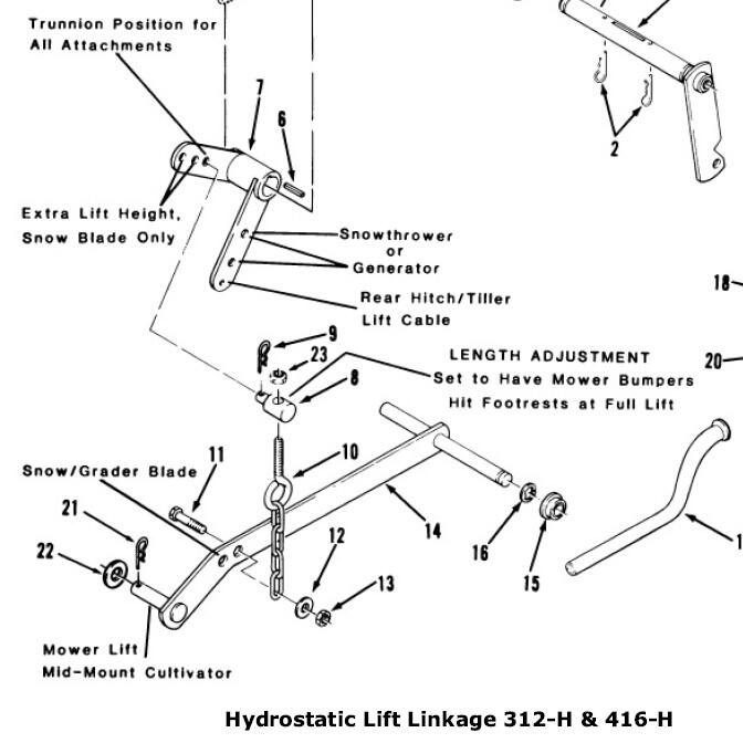

gwest_ca-(File Mod) 12,451 #3 Posted January 16, 2022 In 1973 this was the snowthrower sold for your tractor. What you have should hook up the same. Do you have the flag connected to the correct hole in the correct most vertical arm? 1 Share this post Link to post Share on other sites
gwest_ca-(File Mod) 12,451 #4 Posted January 16, 2022 The lift tube should go down to the hook at the bottom of the thrower. The flat bar on the tube is bent so it sits parallel to the ground. Make sure it is not upside down with the flat bar pointing down to the ground. That causes the lift to bind. The lift tube can be shortened if it lifts the thrower too high. 1/8" difference in tube length changes the lift height by approximately 1/2". If too short you can add 3/4" SAE flat washers to the flag to raise it higher. 2 Share this post Link to post Share on other sites

Jeff-C175 7,211 #6 Posted January 16, 2022 41 minutes ago, Larry Chamberlain said: do i need to cut some off I believe that there were two different lengths of lift tube. It's possible... but make sure first that you've got it in the correct hole on the mechanism. 1 Share this post Link to post Share on other sites

Larry Chamberlain 29 #8 Posted January 17, 2022 On the lift arm i had to go up one hole the first hole was to small and couldnt even get in to drill it out so had tonuse second hile but i did.shorten the tube 2 inches and went and got 3/4 washers to adjust where i wanted the lift works great thanks Share this post Link to post Share on other sites
