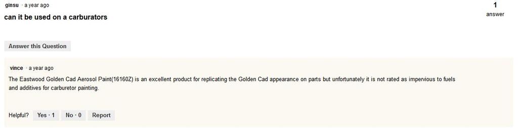

squonk 47,421 #2 Posted January 16, 2022 https://www.amazon.com/Eastwood-Golden-Complete-3-Step-Hardware/dp/B07Q3889GT Share this post Link to post Share on other sites
pfrederi 20,885 #3 Posted January 16, 2022 6 minutes ago, squonk said: https://www.amazon.com/Eastwood-Golden-Complete-3-Step-Hardware/dp/B07Q3889GT oops Share this post Link to post Share on other sites

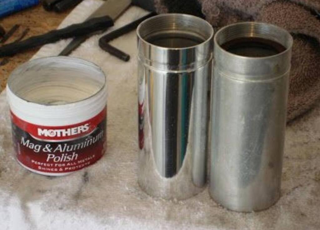

AMC RULES 37,259 #4 Posted January 16, 2022 Think I would just polish them to a high luster and forget them. 4 Share this post Link to post Share on other sites

pacer 3,180 #7 Posted January 16, 2022 1 hour ago, AMC RULES said: just polish them to a high luster and forget them. Thats what I do -- although I have never had any really rusted, just maybe around the edges, I clean em and reinstall. Would think that once they are "off the shelf" and put into use shouldnt be likely to reoccur. Yeah, the vid is nice but, would imagine not many here would tie up that kind of $$ 2 Share this post Link to post Share on other sites
AMC RULES 37,259 #8 Posted January 16, 2022 What I suggested I do by hand, like maybe all of two minutes. 2 Share this post Link to post Share on other sites
pfrederi 20,885 #9 Posted January 16, 2022 17 minutes ago, AMC RULES said: What I suggested I do by hand, like maybe all of two minutes. They are really deeply pitted. This carb was a real mess. The spring on the idle speed had rusted almost completely away Don't think it will "Buff right out" Besides since I am not into polishing, waxing, shining I don''t have any Mothers. 2 Share this post Link to post Share on other sites
