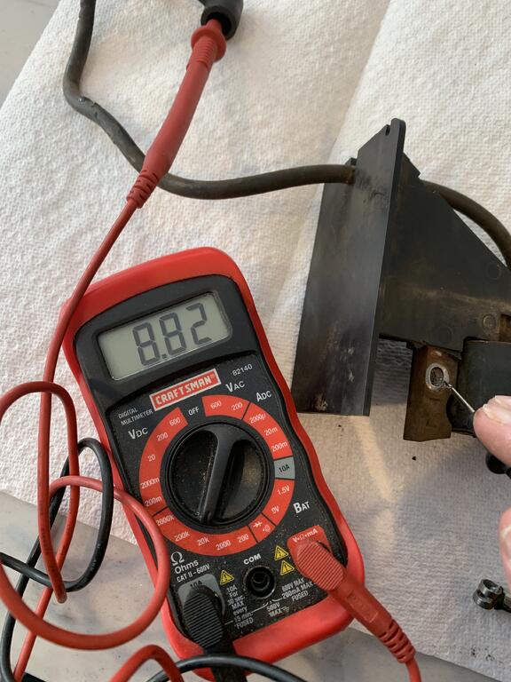

Raposo 532 #10 Posted January 13, 2022 Assuming the coil is bad? Share this post Link to post Share on other sites
pfrederi 21,051 #11 Posted January 13, 2022 For a secondary test you seem to be in spec. 7900/10850 ohms what is primary?? Should be 1.0/3.0 ohms Share this post Link to post Share on other sites
