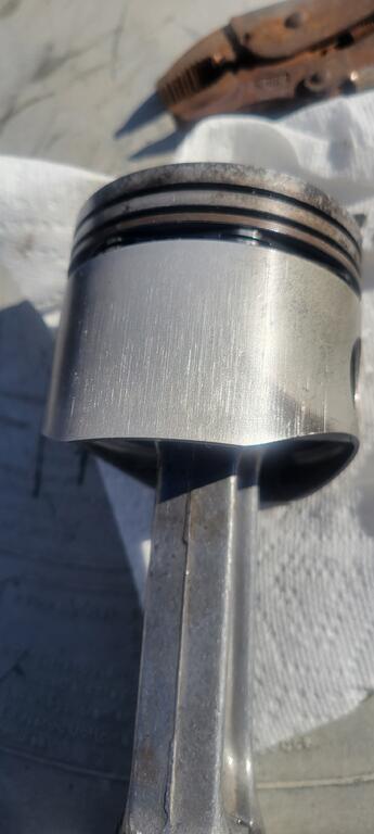

RED-Z06 2,718 #1 Posted January 11, 2022 After honing... Just tore my M12 back down after 5hrs of running,developed a rattle, oil on the piston. The skirts are severely worn especially on the thrust side (rear of the block), the rod shows no scoring but its dull which is indicative of abrasive presence. Rings were in spec 5hrs ago but now. .019/.024/.110 top to bottom. The oil was dark and streaks of silver..i ran a magnet through the oil as it drained and got no ferrous debris so its aluminum...rod and piston. Live and learn...ill clean it more thoroughly this time but im thinking what got me was the valve box, i don't recall if i flushed it after honing and some grit could have been in there. Skirt thickness in 3 spots on trailing side..0.085 0.081 0.085. And on the thrust side..0.061 0.054 0.058 5 Share this post Link to post Share on other sites

RED-Z06 2,718 #5 Posted January 11, 2022 I dunked the whole block into hot soapy water in a tub and used various brushes to scrub inside and out, cleaned the bore with a scotch pad and soap then water and rags..until it came out clean, then 150psi air.until dry. 1 Share this post Link to post Share on other sites

Achto 32,109 #21 Posted January 12, 2022 4 hours ago, RED-Z06 said: After honing.. I know that you stated the piston ring end gap but what is your piston to cylinder clearance. Too great of clearance will cause piston slap or chatter. An egg shaped hole will also cause the same thing. Measure the bore in multiple spots, right all of you numbers down and see how strait the cylinder is. Measure the skirt on you new piston and figure out what you clearance is. Share this post Link to post Share on other sites
RED-Z06 2,718 #22 Posted January 12, 2022 1 minute ago, Achto said: I know that you stated the piston ring end gap but what is your piston to cylinder clearance. Too great of clearance will cause piston slap or chatter. An egg shaped hole will also cause the same thing. Measure the bore in multiple spots, right all of you numbers down and see how strait the cylinder is. Measure the skirt on you new piston and figure out what you clearance is. I probably should but, if its larger than spec im not going to have it punched out, just not worth it, im already to the point id have been ahead of the game to just pickup a used local M16 that ran for $200 and just swapped it on. No doubt the bore has some wear from the contamination vs last week, but...it'd be well more than its worth to punch it 10 or 20 over. It would cost 250+ for a local machine shop to bore it..been there with an M10S...700 in machining and parts for a 250 dollar engine. 1 Share this post Link to post Share on other sites

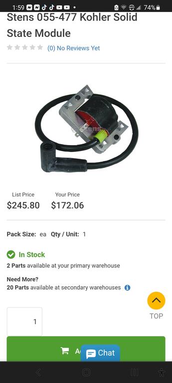

RED-Z06 2,718 #23 Posted January 12, 2022 And they are great engines...no doubt, but when you look at what parts cost...if not for sketchy aftermarket stuff it wouldn't be worth doing. Look at what a coil from stens would run retail vs dealer cost.. Share this post Link to post Share on other sites
RED-Z06 2,718 #24 Posted January 12, 2022 Old piston across the thrust faces on the skirts...3.363" New piston 3.369" That represents the maximum new size and maximum wear specified limit... 6thou wear is probably my noise Share this post Link to post Share on other sites
Achto 32,109 #25 Posted January 12, 2022 (edited) Common clearance for a cast piston is .001 to .0015 per inch diameter. Hypereutectic pistons are tighter around .0005 per inch diameter. You are just outside the cast piston limits. It would probably be ok but may be noisy. You can get .003 over oem pistons, might be an option. Or maybe go .010 over rings on the stock piston, file end gap for correct gap. Did you put the balance gears back in when you built it the last time? Edited January 12, 2022 by Achto Share this post Link to post Share on other sites
