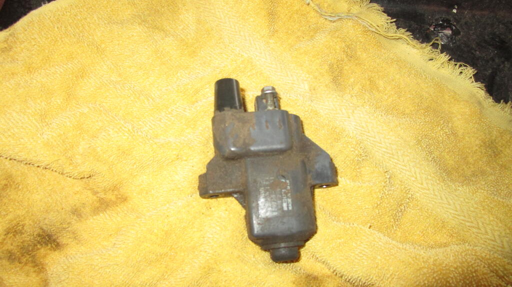

brian_elaine6820@yahoo.ca 0 #1 Posted January 11, 2022 I want to know if I can interchange a points type coil into a electronic ignition model on a p216 The actual mounts have to be changed but will it work electrically and not damage the electronic pick up Share this post Link to post Share on other sites
Achto 31,898 #2 Posted January 11, 2022 (edited) The points type coil should have a different primary resistance when compared to electronic type. I don't believe that they will interchange. Edited January 11, 2022 by Achto Share this post Link to post Share on other sites
brian_elaine6820@yahoo.ca 0 #3 Posted January 11, 2022 thanks I did not see this topic covered anywhere I just happen to have 2 coild used with points but I need a coil for elctronic system .Both use a 12 volt signal to the coil and switch it on and off Share this post Link to post Share on other sites
kpinnc 18,386 #4 Posted January 12, 2022 I've zip tied one to an Onan P220 that came from an older P218. I know what you mean I think, because the mounting bracket was different between the two. Years later, the P220 is still going. 1 Share this post Link to post Share on other sites
