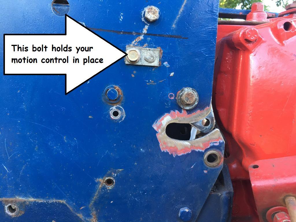

953 nut 68,509 #26 Posted January 17, 2022 The space you are working in is a bit tight but you should be able to back off on the two screws (don't remove them) that apply tension to the cam follower and back off on the nut that holds the ball pivot that is attached to your motion controller. Slide out the old plastic cam follower and slide in the new one. Tighten everything back up and you should be good to go. Share this post Link to post Share on other sites

953 nut 68,509 #29 Posted January 20, 2022 5 hours ago, tallen4392 said: ball pivot with the nut on it got it out today with a lot of swearing tomorrow i will try to put it back together not that simple Sorry, looking at my previous post I see that I left out one detail. If you back off on a bolt that retains the motion control it will be able to move toward the front of the and give you just enough room to slip things back together. 1 Share this post Link to post Share on other sites
