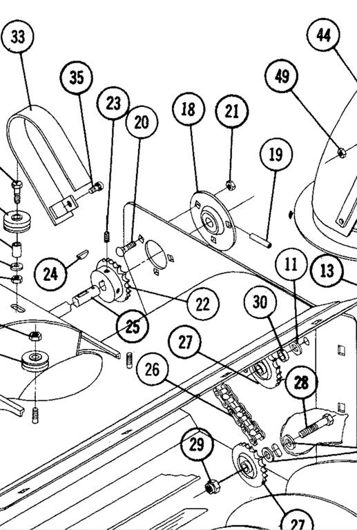

Big Jilm 8 #1 Posted January 7, 2022 Ok most of these older blowers are pretty similar. Mine pretty regularly has an issue where the set screws (23) back out a little or spin out on the drive shaft (25) and the shaft spins but the gear does not. Do I just need to lock-tite it? Is that woodruff key (24) help transfer power or is that in the bearing (18). I had to tighten the set screws twice on one driveway. Any thoughts or advice? 1 Share this post Link to post Share on other sites

gwest_ca-(File Mod) 11,881 #3 Posted January 7, 2022 Welcome to the forum. The Woodruff key should be for the sprocket. If worn it should be replaced and new set screws may help. Once the shaft spins the cup points get rounded off and will not cut into the shaft. 2 Share this post Link to post Share on other sites
8ntruck 8,402 #4 Posted January 7, 2022 to the forum. Lots of good folks here. Chances are pretty good that someone has already broken, and fixed whatever you happen to be working on. That key should be between the gear and shaft. If there is room, put two set screws, one on top of the other in the gear. A new set screw on the bottom will hold torque better than an old one. Like @roadapples suggests, blue Locktite will help. Don't use red or green 'cause they are almost forever type of thread loco era. 1 Share this post Link to post Share on other sites
Jeff-C175 7,207 #5 Posted January 7, 2022 3 minutes ago, gwest_ca said: will not cut into the shaft Or they'll cut a groove in the shaft. You need that key to keep the sprocket from spinning on the shaft. That's not the setscrews job. 2 Share this post Link to post Share on other sites
Big Jilm 8 #6 Posted January 7, 2022 1 hour ago, Jeff-C175 said: Or they'll cut a groove in the shaft. You need that key to keep the sprocket from spinning on the shaft. That's not the setscrews job. That’s kinda my fear and gut feeling. I’ll tear into it this weekend and see what’s goin on in there. Hoping I just have to take off that guard, chain and maybe bearing (18) to get to that key. Any pointers are welcome. These exploded views are about all I can find on disassembly/assembly on this part of the blower. much thanks for everyone’s quick responses. I think I’ll get a second set of lock screws as well and lock-tite blue the new ones in first. Thanks again for all the feedback. Super appreciate it. Share this post Link to post Share on other sites
Jeff-C175 7,207 #7 Posted January 7, 2022 (edited) 13 minutes ago, Big Jilm said: That’s kinda my fear and gut feeling. I’ll tear into it this weekend and see what’s goin on in there. Hoping I just have to take off that guard, chain and maybe bearing (18) to get to that key. Any pointers are welcome. These exploded views are about all I can find on disassembly/assembly on this part of the blower. much thanks for everyone’s quick responses. I think I’ll get a second set of lock screws as well and lock-tite blue the new ones in first. Thanks again for all the feedback. Super appreciate it. It may not be easy... Depending on the vintage of your blower, the shaft bearings may be "cam lock" type. Google "Cam lock bearing" for info on how to work with those, there's a Youtube video that shows how. (probably more than one...). Although, the diagram you posted shows the older variety like mine, and you may not have the cam locks. Just setscrews and a roll pin. Prepare yourself for a bit of a struggle getting that stuff off, The keyway in the shaft may be torn up. Key might be ground to little pieces. Unless someone had it apart one time and never put the key back in. I'm a satisfied customer of this place: https://thebigbearingstore.com/ I recently rebuilt an old blower and got my sprocket, shaft, bearings from them. Decent quality, good prices, shipping was timely. Edited January 7, 2022 by Jeff-C175 1 Share this post Link to post Share on other sites

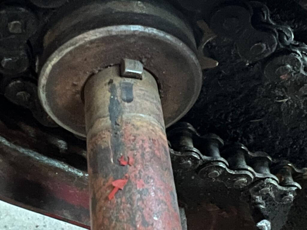

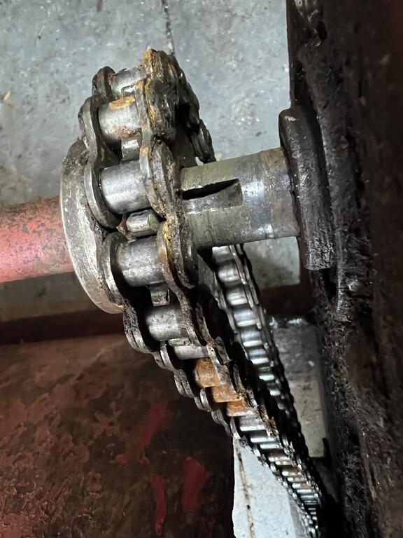

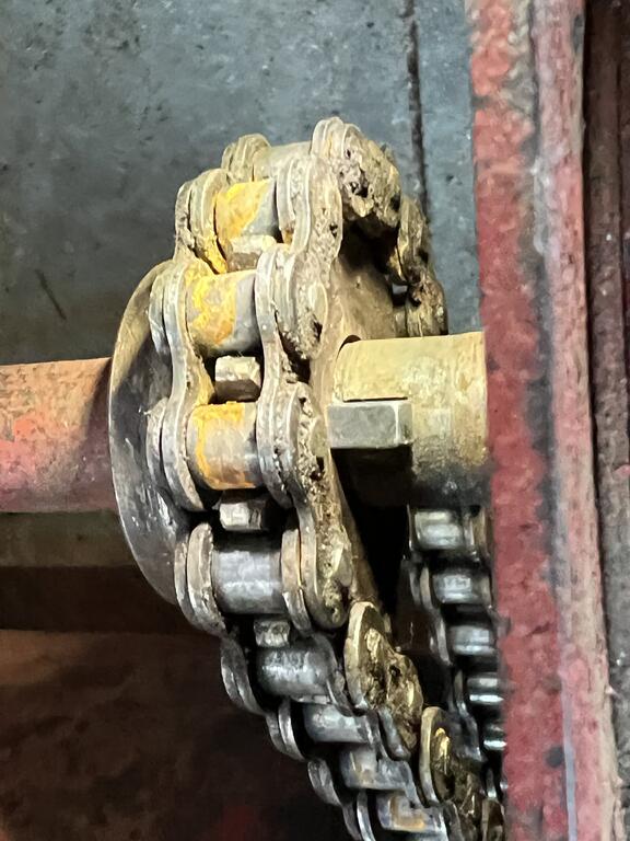

Big Jilm 8 #9 Posted January 23, 2022 Ok so I got to the hardware store and got a woodruff key and some set screws and blue thread lock. I was able to pull the sprocket over far enough to see the key way underneath. I was able to get the key in the key way, line it up with the notch. Neither the key way nor the notch looked spun out and it was tight going back on. I had to use a rubber mallet to persuade it a little. Pushed back into place it looks like the sprocket traps the key. Not sure how or why it was missing. May have been for years before I owned it. ¯\_(ツ)_/¯ I put in new set screws with blue thread lock and then put the old set screws back on top of the new ones. Kind of like using a second but to lock the first one. “Wheel” see how it goes. We’re supposed to get snow tomorrow 2 1 Share this post Link to post Share on other sites
