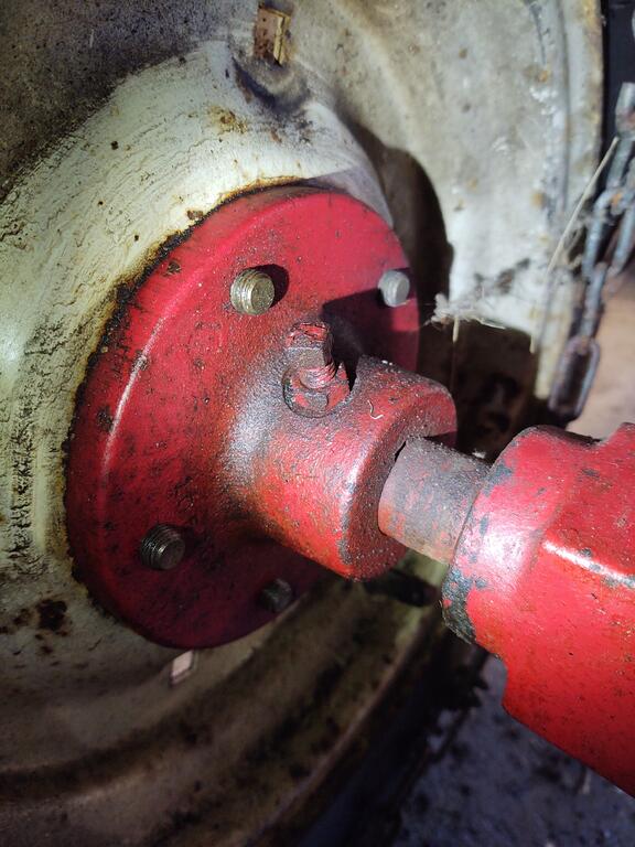

WHX?? 51,688 #26 Posted January 9, 2022 That is the set screw that holds the hub on. No lubrication need ther unless you plan to pull hubs. 2 1 Share this post Link to post Share on other sites
Jeff-C175 7,206 #27 Posted January 9, 2022 (edited) 33 minutes ago, ecojoe69 said: Is that bolt a plug of some sort I should be backing out and lubricating? No, that's the setscrew that holds the hub on. OOps, Jim beat me to it! Edited January 9, 2022 by Jeff-C175 1 1 1 Share this post Link to post Share on other sites
SylvanLakeWH 28,302 #28 Posted January 9, 2022 (edited) 1 hour ago, pfrederi said: Wheel horse parts and more one of the vendors here or your local toro dealer or on line..... For boots… 1 hour ago, Joe 77 B100 said: Is that bolt a plug of some sort I should be backing out and lubricating? Thats a locking bolt / set screw for the hub to the axle… should be nice and tight… yikes two others beat me… Edited January 9, 2022 by SylvanLakeWH 1 1 Share this post Link to post Share on other sites
peter lena 9,231 #29 Posted January 9, 2022 @Maxwell-8 never liked those tiny sealed bearings on those pulleys , the bearing side face to bolt head does not allow a lubricant improvement. if you took that pulley to a bearing / pully shop , they could probably match it up with same size/ type pulley , but with a much larger bearing , 5/8 to 3/4" I D , size , then match it up with a 3/8 ID x 5/8 or 3/4 OD , bronze bushing, with wide side shields on those larger bearings , pop off the shields , clean them out and put in a hi temp grease , like lucas xtra heavy duty . no more bearing failures , done that on a number of pulley bearings , that lucas grease will not disappear , its POLYUREA RATED . 560 DROP TEMP , quiet and solidly smooth , pete 2 Share this post Link to post Share on other sites
Jeff-C175 7,206 #30 Posted January 9, 2022 (edited) 2 hours ago, SylvanLakeWH said: should be nice and tight… @Joe 77 B100 hey! you changed your name, diddincha? A little more about that setscrew: [/broken record mode on] You can't tighten those screws tight enough with a simple hand wrench. They need to be 25-30 ft lb of torque. Chances are that it's tight enough already, but if you DO loosen it for any reason, make sure you get it tight enough again. You'll need a ratchet wrench and an 8 point socket (to fit the square head). That nut that is on there is called a JAM NUT. It's purpose is to keep the set screw from loosening. Before you attempt to loosen or tighten the set screw you first need to loosen the jam nut, and then after the set screw is tight again you tighten the jam nut to hold the set screw from loosening. [/broken record mode off] Edited January 9, 2022 by Jeff-C175 2 2 Share this post Link to post Share on other sites
