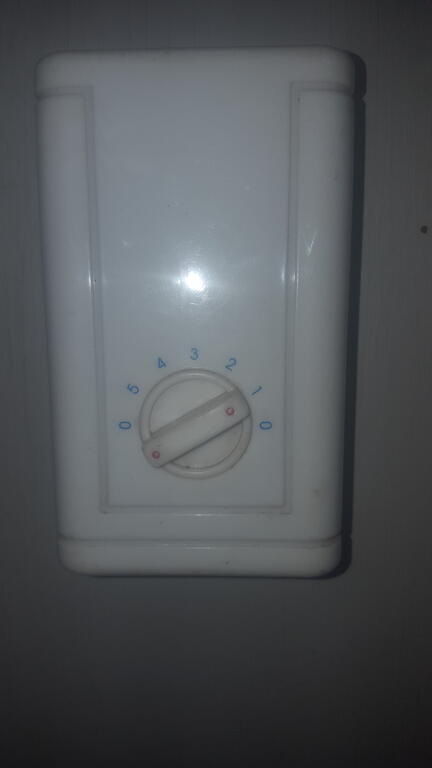

Gregor 4,847 #1 Posted January 6, 2022 I have a ceiling fan in my garage. It has this controller that came with it. 5 different speeds. I want to run it in the winter, but even set at the lowest speed, it turns too fast, and creates a draft. Can the controller be swapped out for this rheostat type controller? Thanks Greg Share this post Link to post Share on other sites
Maxwell-8 4,370 #2 Posted January 6, 2022 I believe so, It is just two wires that are restricted in current. But have noticed electrical stuff can vary over the pond. We are going to install a ceiling fan in our shop as well. The ceiling is 19 feet high and in the winter all the heat raises up there. And then we are working in the cold. I noticed it when needing to do some work on the lighting. The higher I climbed up my ladder, the nicer it became. The fan will blow the hot air back down. in a variety of directions. 1 Share this post Link to post Share on other sites
Gregor 4,847 #3 Posted January 6, 2022 (edited) I do know that not ALL electric AC motors can be variable speed. The motor has to be wired for this. The trouble is, I don't know if my prufyv28948098062yqesent controller has that wiring, or if it is in the fan. My present controller is NOT a simple rotary switch. I do know that not ALL electric AC motors can be variable speed. I guess I should say I THINK this anyway. Edited January 6, 2022 by Gregor Share this post Link to post Share on other sites

Gregor 4,847 #8 Posted January 6, 2022 44 minutes ago, squonk said: Let's see a vid of it's lowest speed. It may not be designed for that switch in the first place . Or, Buy another fan that's reversible The controller came with the fan Share this post Link to post Share on other sites
