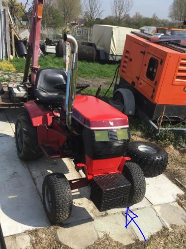

I know @bizon mounted a car battery in the front of his WH 416-8 because U1's are pretty expensive here in Belgium.
He can not use the attach a-matic no longer

added a picture
