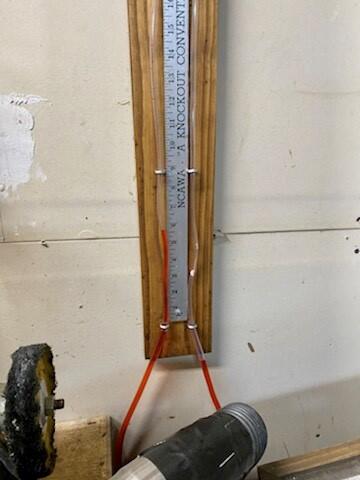

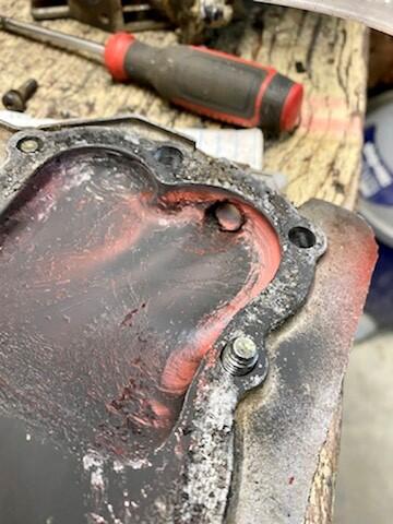

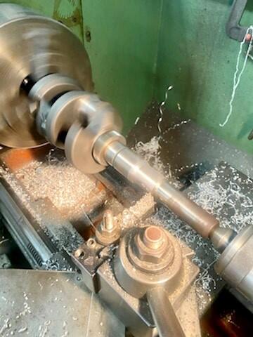

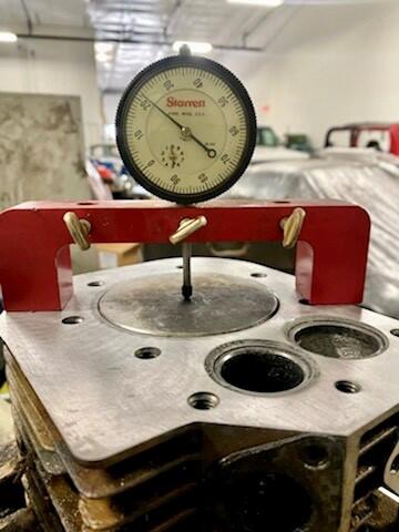

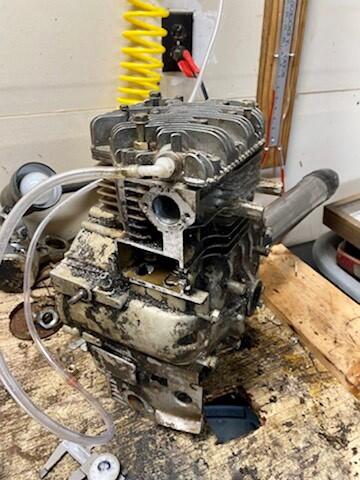

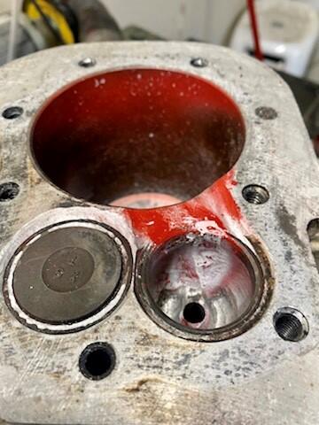

Greentored 3,220 #75 Posted April 13, 2022 Guess I oughtta update more often eh? Pics are a pain for me to get from phone to computer to page, reading is a pain on the phone ha. Anyhow..... This project took a big turn when I acquired a junk 18hp block, built a simple flow bench (manometer for 'comparison') and started playing. Learned an awful lot by doing this and applied it to the big 20.5 block. Here's some random photos from the last month or so..... Hope you are all doing well! 2 Share this post Link to post Share on other sites
