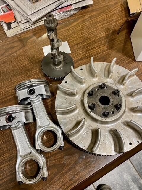

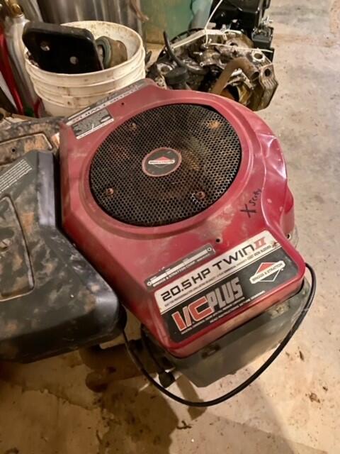

Greentored 3,221 #1 Posted January 5, 2022 Hope you all are doing well! Been wanting to build a pressure lubed opposed Briggs for the off roader for quite a while- they just 'oil' better for obvious reasons. After much searching, I located a 'big boy' 46CI (20.5hp) pressure lube Briggs opposed twin, in a vertical shaft arrangement, and after MUCH deeper digging was able to pick up a horizontal shaft side cover, oil pump, and lower sump (oil pan) to flip her to horizontal for my usage. I have a knack for making power without spending a lot of money, and use that knack to inspire others to open their toolboxes instead of wallets, and enjoy making their small (or large) engines really honk without going broke. Well, plans often change, dont they? I ran across a fella who had a billet flywheel, billet rods, hotrod pistons and custom ground cam for the same style of engine, for about 10 cents on the dollar. Guess this build will be going against a lot I stand for, but its sure going to be fun! Ever heard an opposed flatty twin at 7 grand? Me neither. Stay tuned, its gonna get silly 13 1 Share this post Link to post Share on other sites

RED-Z06 2,720 #13 Posted January 5, 2022 (edited) Curious about the "pressure lubed" opposed twin. In vertical arrangements they had some models that had filters and a pump that pumped oil thru the filter and back into the sump..but the flapper wheel still performed the lubrication. On horizontal models the dippers on the rods did the lubing and ive never seen one with a filter. But im going to read up on them for sure, never liked digging into these but they usually ran strong and very smooth, i do recall they say there was a full pressure lubed model with the drilled crank, lubed it all by pressure but never have seen a horizontal one Edited January 5, 2022 by RED-Z06 1 Share this post Link to post Share on other sites
peter lena 10,105 #14 Posted January 5, 2022 @Greentored if nothing else that piston / rod set up , looks like a small block chevy , very stout and matching piston set up . looks like a fun build , good luck with it , pete 2 1 1 Share this post Link to post Share on other sites

Greentored 3,221 #19 Posted January 6, 2022 14 hours ago, RED-Z06 said: Curious about the "pressure lubed" opposed twin. In vertical arrangements they had some models that had filters and a pump that pumped oil thru the filter and back into the sump..but the flapper wheel still performed the lubrication. On horizontal models the dippers on the rods did the lubing and ive never seen one with a filter. But im going to read up on them for sure, never liked digging into these but they usually ran strong and very smooth, i do recall they say there was a full pressure lubed model with the drilled crank, lubed it all by pressure but never have seen a horizontal one Ive heard of some form of those 'filtered' engines but have zero knowledge of them. The one I'm building is indeed full pressure, with the drilled passages. Theres horizontal models out there but they are rare- mainly used on higher end commercial welders, trash pumps, etc, and to my knowledge they did not make a big boy 46ci in that configuration. It took months and a TON of digging to find a horizontal cover and pan. 3 Share this post Link to post Share on other sites
