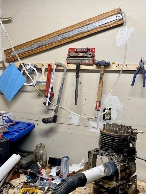

Greentored 3,220 #31 Posted January 13, 2022 Now things are getting even sillier. Before the V twins, opposed twins were a hot item with the roundy round racers, but heres the problem- racers spend countless hours trying to squeeze an edge on their competition, and they're not going to share those secrets. Ive even tried to squeeze some info out of folks since its not a common class anymore, with very little help. Time to figure it out myself- I built a flow bench. Yes its simple and crude, and I cant calculate an actual number- but it IS repeatable, and will tell me whether I gained or lost airflow, a rough idea how much, and at what valve lift I see those changes. Starting with an old, bone stock block and a couple hours of tinkering, I've already found some interesting things on the intake side: 1. the stock port 'stalls' at just .200 valve lift (no additional air flow no matter how high I open the valve) 2. some very mild port cleanup helps, but not as much as expected 3. 'laying back' the eyebrow helps very little, but fully relieving the area between the valve and cylinder does- about as much as the light port cleanup 4. Cutting a 45 degree angle on the valve seat below the 30 degree factory seat angle, and back cutting the valve in the same spot makes a BIG difference up to .150 lift- actually three times more gain that either porting or relieving. Low lift gains are what will start that cylinder filling quickly, and that makes torque! 5. Folks talk about NOT milling oppy heads- it squeezes the 'transfer' area between the head and block and the loss of air flow hurts more than the gains in compression. In 100% stock form, removing the head gasket (mimicking a .045 head milling) indeed hurt max lift air flow a bit, but once all the other work was done, it made zero difference. At this point, I am seeing air flow gains across the board, and no more port 'stall' at .200, although the increase in flow beyond .200 are slow, steady climbs. Stay tuned, the next round I will be getting into much more serious work using real porting tools instead of all I had on hand at the time- a round file 3 Share this post Link to post Share on other sites
ebinmaine 79,724 #32 Posted January 13, 2022 VERY cool stuff Scott. Thanks for taking the time to write it out and post publicly. Keeping in mind that I'm not familiar with the physical aspects of the shape of the block or head on singles or flat twins... Why do you suppose there's a lack of airflow after shaving the head? Are the combustion chambers that much different in shape? 1 Share this post Link to post Share on other sites

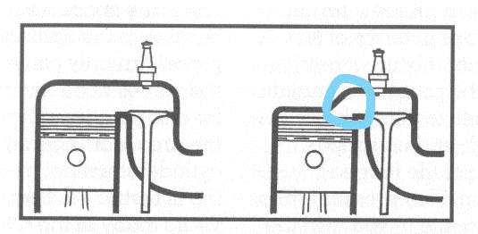

Greentored 3,220 #33 Posted January 13, 2022 The flattys are actually a terrible, inefficient design, and is exactly why an OHV engine came about and makes so much more power. I found this drawing on the interwebs and circled the transfer area. When milling a head, this area gets smaller, and restricts the air flow. The 'air flow vs compression' argument is as strong as an oil debate, but overall it does seem like the guys building high rpm screamers argue airflow, while low rpm workers argue compression. There is definitely a balance and tradeoff. 1 Share this post Link to post Share on other sites
ebinmaine 79,724 #34 Posted January 13, 2022 4 minutes ago, Greentored said: it does seem like the guys building high rpm screamers argue airflow, while low rpm workers argue compression. There is definitely a balance and tradeoff Understandable. So given that I'll be looking for more torque grunt from a single flathead K341... If I mill a head to get more squeeze should I also consider enlarging the flow area? Share this post Link to post Share on other sites

RED-Z06 2,718 #37 Posted January 14, 2022 10 hours ago, Greentored said: The flattys are actually a terrible, inefficient design, and is exactly why an OHV engine came about and makes so much more power. I found this drawing on the interwebs and circled the transfer area. When milling a head, this area gets smaller, and restricts the air flow. The 'air flow vs compression' argument is as strong as an oil debate, but overall it does seem like the guys building high rpm screamers argue airflow, while low rpm workers argue compression. There is definitely a balance and tradeoff. You can also clearance the brow between the cylinder and valves down to just above the compression ring, costs a bit of chamber volume but you do gain flow. Share this post Link to post Share on other sites
Snoopy11 5,731 #38 Posted January 14, 2022 6 minutes ago, RED-Z06 said: costs a bit of chamber volume Wouldn't be worth it then... would it? That would actually decrease power...? Don Share this post Link to post Share on other sites
ebinmaine 79,724 #39 Posted January 14, 2022 Just now, Snoopy11 said: Wouldn't be worth it then... would it? That would actually decrease power...? Don Not necessarily. In every engine there's a line to be drawn between getting squeezed and moving the air. 2 Share this post Link to post Share on other sites
Snoopy11 5,731 #40 Posted January 14, 2022 1 minute ago, ebinmaine said: Not necessarily. In every engine there's a line to be drawn between getting squeezed and moving the air. I'm not much into the grinding stuff... just not my thing. I certainly am not opposed to getting more educated about it... but I can make more than enough power in other ways... Don 2 Share this post Link to post Share on other sites
RED-Z06 2,718 #41 Posted January 14, 2022 3 minutes ago, Snoopy11 said: Wouldn't be worth it then... would it? That would actually decrease power...? Don Depends on how its built, the ability to draw in more air can result in higher dynamic compression 2 Share this post Link to post Share on other sites
