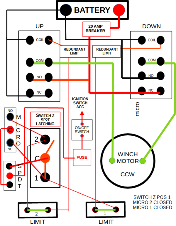

Gregor 4,848 #28 Posted January 5, 2022 6 hours ago, Jeff-C175 said: thought about the way my el-cheapo come along reverses That's exactly where I got the idea for the slot. The trouble is, you have to flip that spring manually. You might as well break down and buy a winch, a little angle iron, a few switches and relays, plus a few feet of wire. In the end, all you have to do is put the tractor in reverse, and the blade magically pops up. But you might want to plan on a couple hours free time, when it comes to all them wires, switches, relays, and such. 3 Share this post Link to post Share on other sites

tractorbeast 27 #33 Posted January 5, 2022 12 hours ago, Gregor said: That's exactly where I got the idea for the slot. The trouble is, you have to flip that spring manually. You might as well break down and buy a winch, a little angle iron, a few switches and relays, plus a few feet of wire. In the end, all you have to do is put the tractor in reverse, and the blade magically pops up. But you might want to plan on a couple hours free time, when it comes to all them wires, switches, relays, and such. @GregorIf I may ask, what software did you use to draw up your schematic. Share this post Link to post Share on other sites

Gregor 4,848 #35 Posted January 5, 2022 42 minutes ago, tractorbeast said: @GregorIf I may ask, what software did you use to draw up your schematic. ummmmmm Here's what I can tell you. I have windows 10. It says "LibreOffice Draw" at the top. Does that answer your question? 1 Share this post Link to post Share on other sites
