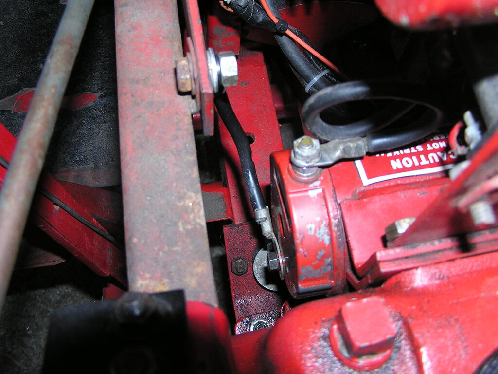

ri702bill 11,545 #1 Posted January 3, 2022 I had to change the starter recently and noticed the 1/4-20 screw in lower portion of the brush cap. @peter lena came to mind with his past posts about having decent grounds for all devices. I had a second Solenoid to Starter wire from a parts C81 - lo and behold -the right length with the correct 1/4" lug on one end and 5/16 on the other - to go from the cap bolt to the angle mount for the belt guard - with dielectric grease, of course. 3 Share this post Link to post Share on other sites

peter lena 9,797 #3 Posted January 3, 2022 @ri702bill agree on that, while I am not a rocket scientist I am a detail nut , found that more often than not, the wiring on the horses is typically in dire need of an upgrade. often refer to " bolt on electrical lugs " in your wiring mounting points , very solid and secure , but more important is that its a easy go to point , to add and continue your wiring. most electrical gain I found is the battery cable ground bolt , to add a 4-6 ga cable to your engine / chassis , at engine corner to frame ,next to clutch pedal . use serrated washers and dielectric grease, done that on my 3 horses , zero electrical issues , instant quick starts . went from that electrical lug to charging rectifier , with 10-12 gage wire to bolt mounts , then on to headlights , with same ground , not rocket science , but my horses consistently quick start and run strong. take advantage of something that works and make it , work easier and more reliable , thats only me , keep it greasy , pete 3 Share this post Link to post Share on other sites
