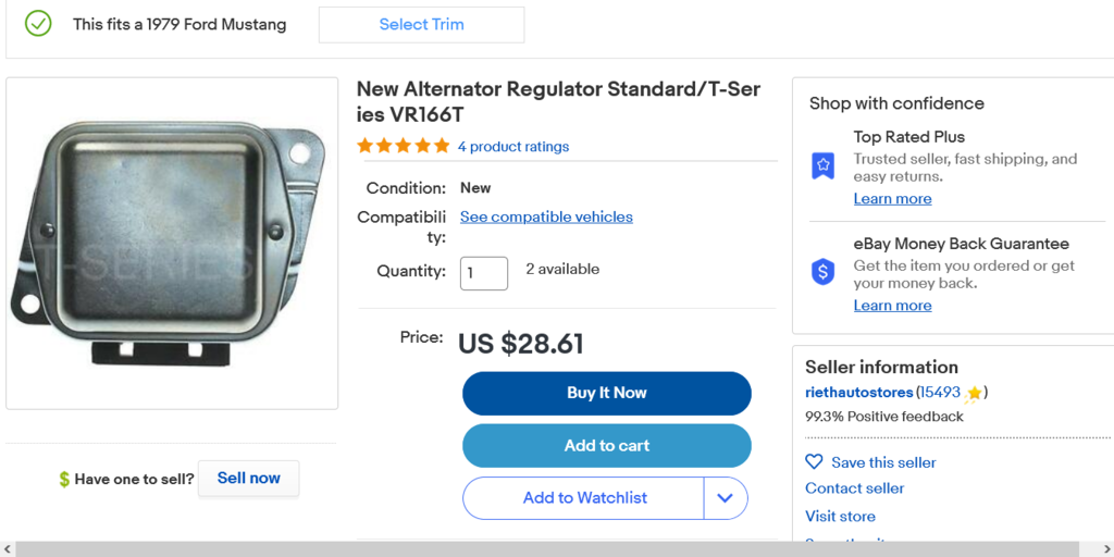

Gregor 4,847 #1 Posted January 3, 2022 on automotive alternators. I have an alternator from a '79 Mustang. Do alternators have a built in regulator / rectifier? Thanks Greg 1 Share this post Link to post Share on other sites
ri702bill 10,594 #2 Posted January 3, 2022 Yes - they have diodes inside - the major issue is when one fails. 1 1 Share this post Link to post Share on other sites
Achto 30,207 #3 Posted January 3, 2022 2 minutes ago, Gregor said: Do alternators have a built in regulator / rectifier? I do believe that Ford had gone to an internal reg/rec by '79. Dodge held out a little longer with an external reg/rec I think till the early '80's. GM switched to internal reg/rec in the early '70's 3 1 Share this post Link to post Share on other sites

pacer 3,177 #7 Posted January 3, 2022 If you need a replacement, more than likely itll have an internal. You will need to know what that 79 came with. FWIW my grey market 70ish Mitsubishi w/FEL alternator went out and when I - finally - found a replacement it had internal reg, and the original was separate ... Hmmm, what do I do? The wiring harness was closely tied into the existing reg and was therefore operating the instruments on dash. I finally decided to go ahead and leave the orig reg in the loop and see what happened --- and, fortunately every thing worked...whew! 1 Share this post Link to post Share on other sites
