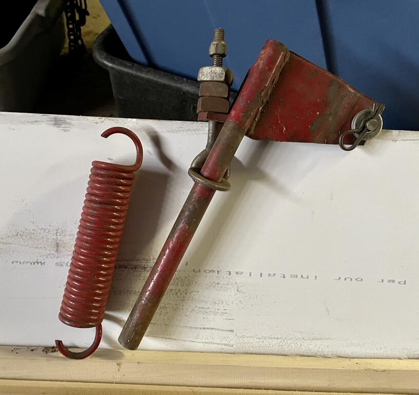

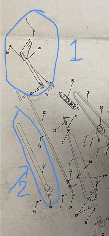

wallfish 20,673 #8 Posted January 3, 2022 To lift it, yes but you also need this part to connect to the tractor https://wheelhorsepartsandmore.com/product/snow-blower-lift-flag-101461-with-spring-4629-and-eye-bolt/ 1 Share this post Link to post Share on other sites
rnphila 5 #9 Posted January 3, 2022 does that flag part 1 connects with the pipe 2? I might have this flag part somewhere… I definitely have this bar/pipe #27 Share this post Link to post Share on other sites
rnphila 5 #10 Posted January 3, 2022 Found all parts, woo hoo! figuring out how there’s last pieces connect Share this post Link to post Share on other sites
