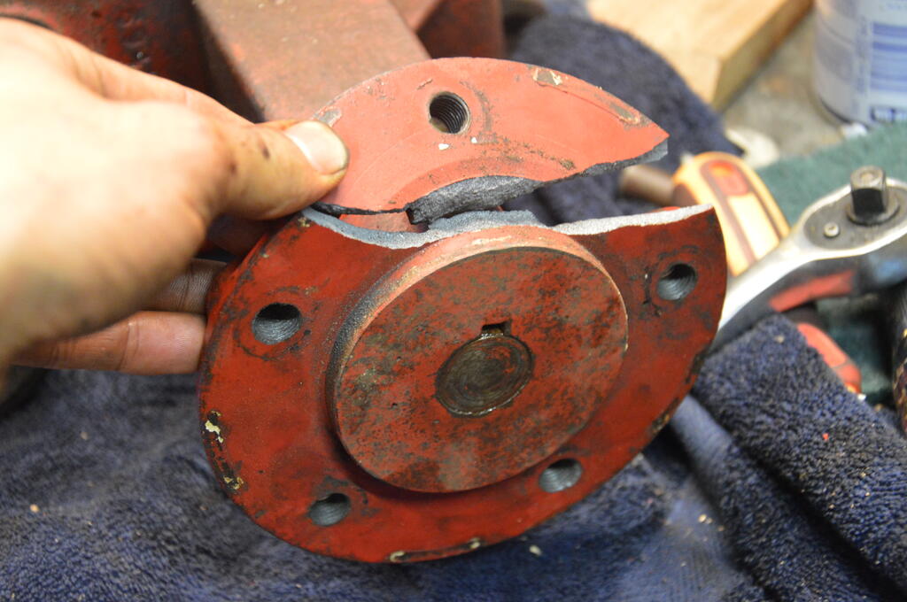

Maxwell-8 4,371 #35 Posted January 3, 2022 Just now, DeepH2O said: What about Axle seals? Should I fool with them? I replace them on all my Horses. But taking off the hubs can be a real pain.. If you decide to do it, DON'T use a hammer!!! Search for hub puller 's plenty of treads on here concerning that. 1 Share this post Link to post Share on other sites

Maxwell-8 4,371 #39 Posted January 3, 2022 Just now, Snoopy11 said: Did I say... ...? Don Cause I know the consequence of it previous owner used the hammer to pull off the hub and ended like this: Me on my raider using the hammer to put the hub back on: 1 1 Share this post Link to post Share on other sites

Snoopy11 5,731 #41 Posted January 3, 2022 1 minute ago, Maxwell-8 said: Cause I know the consequence of it I... am guilty of using a hammer and "tapping" on mine... I don't hit it "hard"... but because I know how "hard" it is to find 3 bolt hubs... I will be less "hard"-headed in the future, and refrain from using a hammer... especially after seeing those pictures... Don Share this post Link to post Share on other sites
