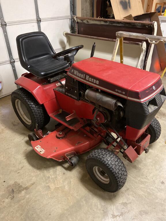

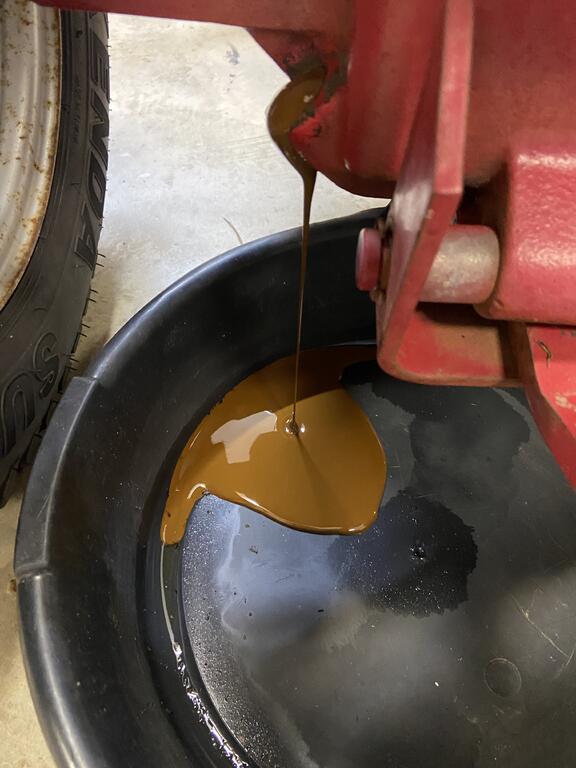

DeepH2O 66 #1 Posted January 2, 2022 (edited) Long time lurker on the forum, first time posting. My dad passed away last June. We’ve had this 1989 312-8 in the family since new. Passed down from my grandfather to my dad. I brought it to my house, over the winter, and tuning it up. I know my dad kept the oil changed in it, frequently. Well, he must’ve not worried to much with the transmission oil. It’s a manual 8 speed. I pulled the dipstick on it and it was pretty cruddy. Had some build up on it. I decided to drain oil and this is what came out 😳. It’s ran fine the last couple times I mowed moms grass. What can use to flush all this out with? Just gear oil (the type manual recommends)? Or is there some type of detergent that I could use? Or is the trans toast?!? This tractor means the world to me! Thanks for any help!! Edited January 2, 2022 by DeepH2O Add content 3 Share this post Link to post Share on other sites
WHX?? 58,346 #2 Posted January 3, 2022 (edited) Deep Water in the oil fer sure. We can help you save the transmission. Fill it per the manual with kerosene or diesel and drive it around a bit. Drain and repeat as required to get all the gunk out. If possible raise the front of the tractor as high as posiible but still remaining safe.... then fill with fresh 80/90. Put some seat time on it and drain and refill with 80/90 again. Others will be along to welcome and offer sound advice. Take care of it and you might be very well passing it to your grand kids. BTW if you been lurking you may already be aware we like Edited January 3, 2022 by WHX?? speeling 2 4 Share this post Link to post Share on other sites
SylvanLakeWH 32,819 #3 Posted January 3, 2022 Old and water in oil… Prop up front end and make sure all oil drains. There’s a hump in trans that keeps some oil in if not propped up… Put couple quarts of kerosene in there and run it around awhile. Change through all gears while driving. Drain again with front end propped up. or, just fill with 80-90 gear oil and run for awhile. Then drain again… Fill with 80-90 weight drain oil. May need to do twice… I’d change shift boot cover to keep water out… And, 5 Share this post Link to post Share on other sites

WHX?? 58,346 #5 Posted January 3, 2022 (edited) You don'twant him to stuff some cheese curds in it Sylvia? ..... inside joke Deep Drain plug is underneath just to the left of the hitch. 1/4 Allen plug ???? Fellas? Edited January 3, 2022 by WHX?? 2 1 Share this post Link to post Share on other sites

Handy Don 17,660 #9 Posted January 3, 2022 (edited) Welcome. The transaxles on these machines are very tough. Odd are excellent that, with the double flush and fresh 80/90 the guys above suggested, you'll have a lot of life ahead in that machine. Make a note on your calendar to change it again in a year. After that, you can change it based on hours of use, per the manual. Edited January 3, 2022 by Handy Don 4 Share this post Link to post Share on other sites

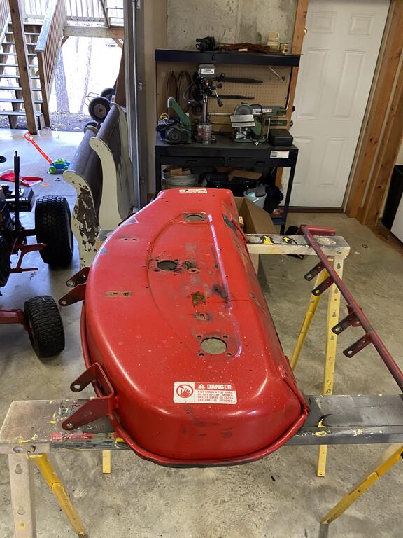

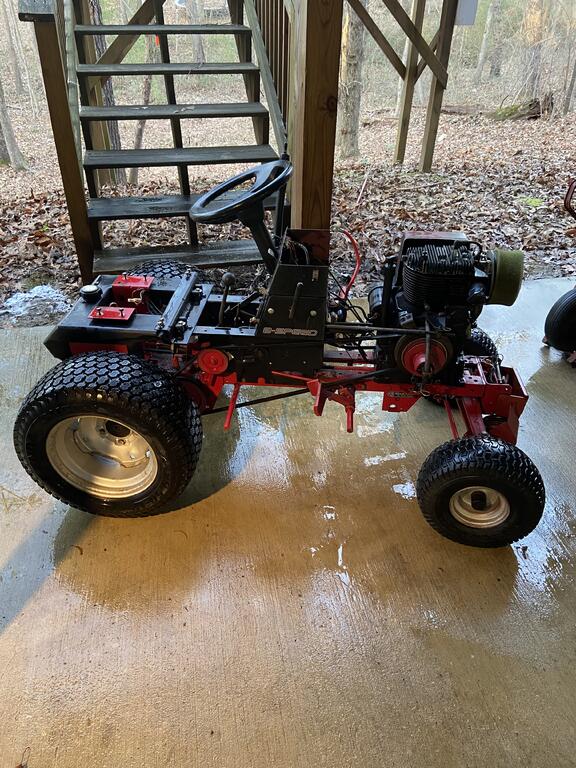

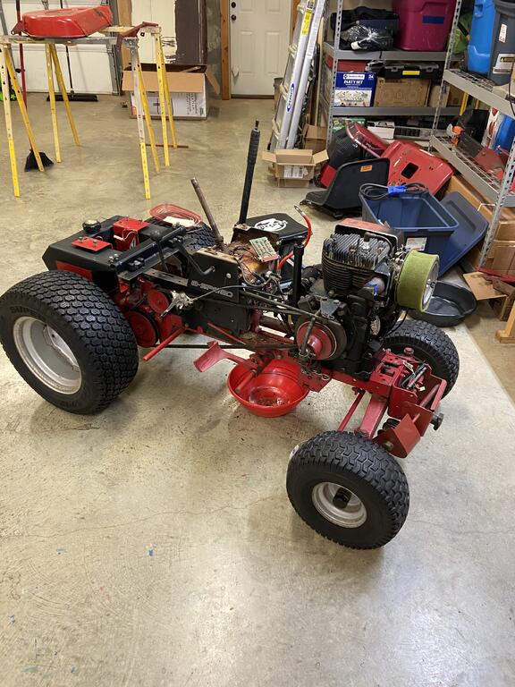

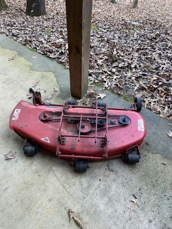

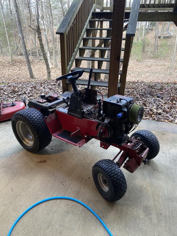

DeepH2O 66 #11 Posted January 3, 2022 Awesome! Thanks for the advice, fellas! I’ve got it torn apart right now, for a extensive overhaul! Dad would be proud! I’m rebuilding the deck. All new rollers/wheels, new idler pulley, new bearings in all the blade spindles, new blades. Repainting everything I can. Replacing all the belts. Installed new seat cylinder. Replaced fuel line and added an inline filter. Adding all new decals. Thank goodness for the people making reproductions. Several other odds and ends! Taking lots of pictures and labeling everything that comes off. Dad would LOVE IT!! I work offshore, in South America. I work on a 28 day on/ 28 day off rotation. Hopefully have all parts I’m painting, buffed down and ready for paint next time I get home. I really wanted to take it down To the frame, but just won’t have time before next summer. Maybe in another couple of years. Welp, headed down to shop to prop tractor up to get all that fluid out!! Thanks again! I’m sure I’ll have more questions in future 3 4 1 Share this post Link to post Share on other sites

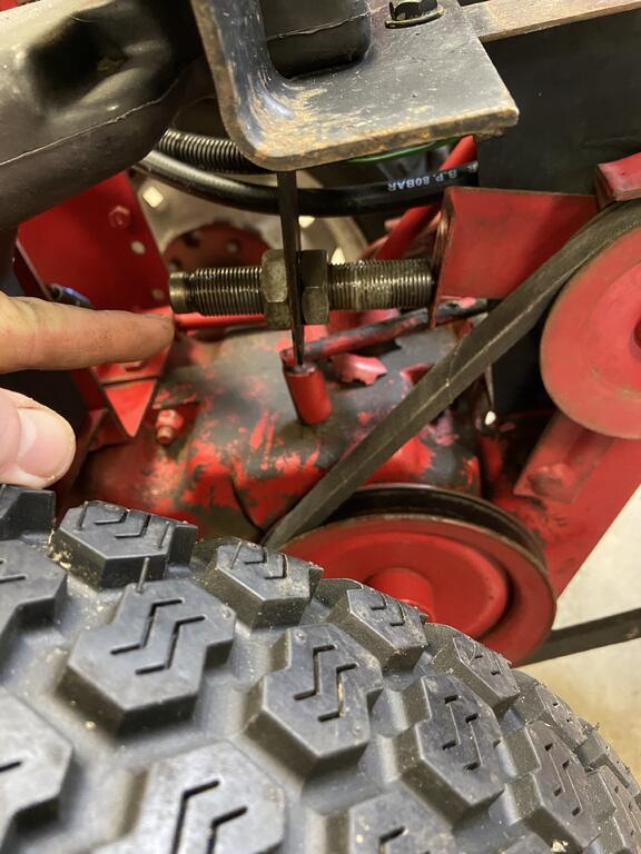

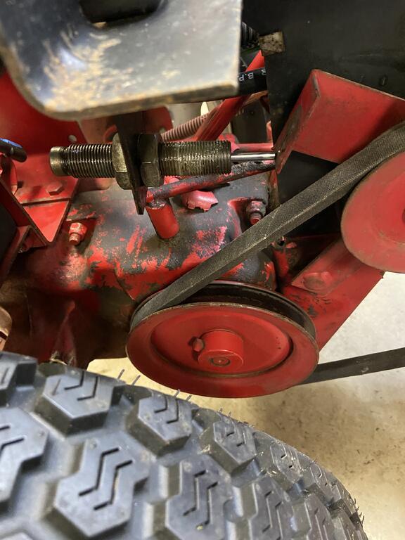

DeepH2O 66 #12 Posted January 3, 2022 One more question for y’all. What is this? The all thread w/ small cylinder coming out of it. The idler pulley has the cylinder pressed in when clutch is depressed. When you engage clutch, the cylinder comes out. I changed the trans belt. With the old belt on, the little piston was all the way in. After new belt, I had to adjust it to keep cylinder in. It looks like a switch of some kind, but no wires going to it!! It’s got me stumped! 1 Share this post Link to post Share on other sites
Handy Don 17,660 #13 Posted January 3, 2022 (edited) That's a damper to prevent the clutch from engaging too quickly similar to a shock absorber). Was only on a few machines. A number of members here have strong pro/con (lots of cons ) opinions on it. I haven't personally experienced one but it seems if it is working fine, then no worries. If it misbehaves, well,..... Edited January 3, 2022 by Handy Don 2 1 Share this post Link to post Share on other sites
tunahead72 2,662 #14 Posted January 3, 2022 2 hours ago, DeepH2O said: ... 1 hour ago, WHX?? said: ... Drain plug is underneath just to the left of the hitch. 1/4 Allen plug ???? ... Correct, and important... You may have to clean out the Allen plug to get a wrench in there nice and tight, but that is the proper place to drain from, you should get about 2 quarts of old fluid out. 3 1 Share this post Link to post Share on other sites
