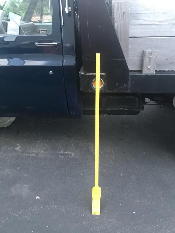

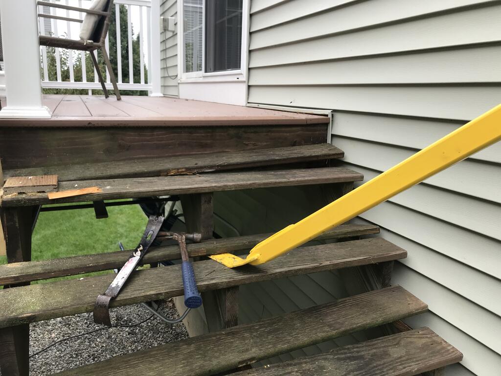

Newstuffsucks81 90 #1 Posted January 1, 2022 These were invented in the ‘40s and used to separate forms from foundations. Almost immediately guys realized they were great crow bars with a great deal of leverage. We redid our back deck this summer so I had a hood reason to make one. 48”x2”x1”x.25” wall. 12” piece of leaf spring from my spare 14bolt axle Bending that leaf spring was the most difficult part. It’s the over load off a one ton pack. I had to heat both sides with map gas and acetylene, put it in a vise and a 24” pipe wrench. I’m a strong guy and it wouldn’t budge. Heated it again cherry red, added 3’ pipe and I got a bend. The I cut a crows beak in one end of the bar, put the spring in, hammered it shut and welded it up. Added a piece of steel across the front to reinforce but not really needed. I ripped the 5 1/4 decking up in no time at all, and they used ring shank nails. 8 Share this post Link to post Share on other sites
