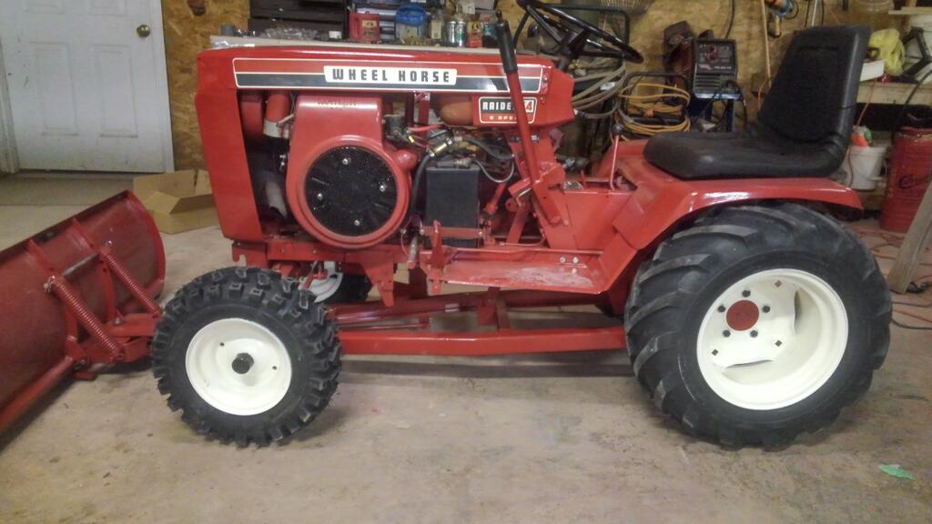

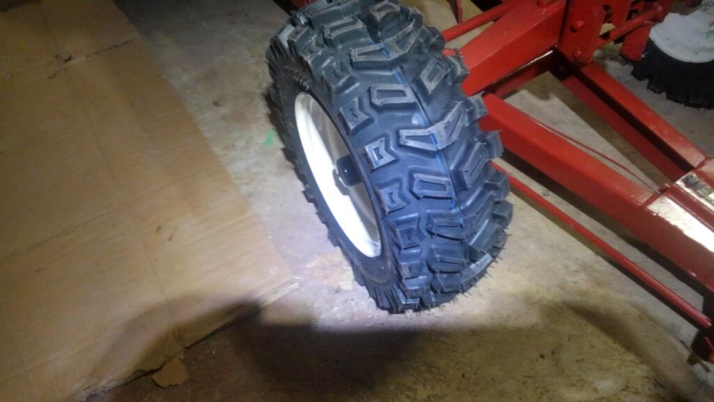

Achto 32,118 #9 Posted December 31, 2021 I have these on the front of my C-145 that I use for pushing the snow blade around. They made a word of difference, no weight added and the tractor goes where I point it. https://www.amazon.com/Carlisle-Trac-ATV-Bias-Tire/dp/B001THCJDO Been thinking about adding these to the rear. I've heard very good reviews from people who don't even run chains with these. Say that chains are not needed. https://www.millertire.com/23x8-50r12-carlisle-versa-turf-compact-radial-tractor-tire-6-ply/ 2 Share this post Link to post Share on other sites

Rusty Tinsnips 477 #12 Posted January 1, 2022 2 hours ago, Achto said: I have these on the front of my C-145 that I use for pushing the snow blade around. They made a word of difference, no weight added and the tractor goes where I point it. These worked very good last year. On concrete. chipped stone and dirt. 2 Share this post Link to post Share on other sites
Maxwell-8 4,371 #13 Posted January 1, 2022 25 minutes ago, Rusty Tinsnips said: Those are snowblower tires if I am not mistaking? 1 Share this post Link to post Share on other sites
Achto 32,118 #14 Posted January 1, 2022 10 minutes ago, Maxwell-8 said: Those are snowblower tires if I am not mistaking? You are correct. They do make great steer tires as well. Share this post Link to post Share on other sites
Achto 32,118 #15 Posted January 1, 2022 2 hours ago, ebinmaine said: Really do wish they came in a larger size for 8" wheel. The ones that I posted are 16x6.50x8's 1 Share this post Link to post Share on other sites

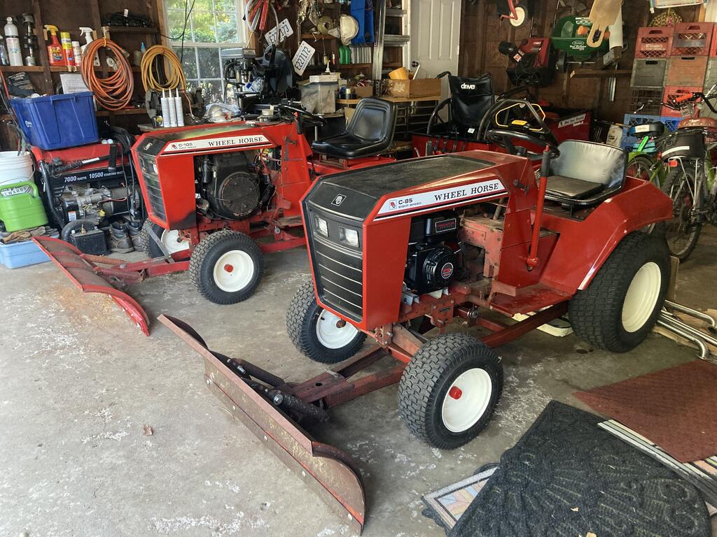

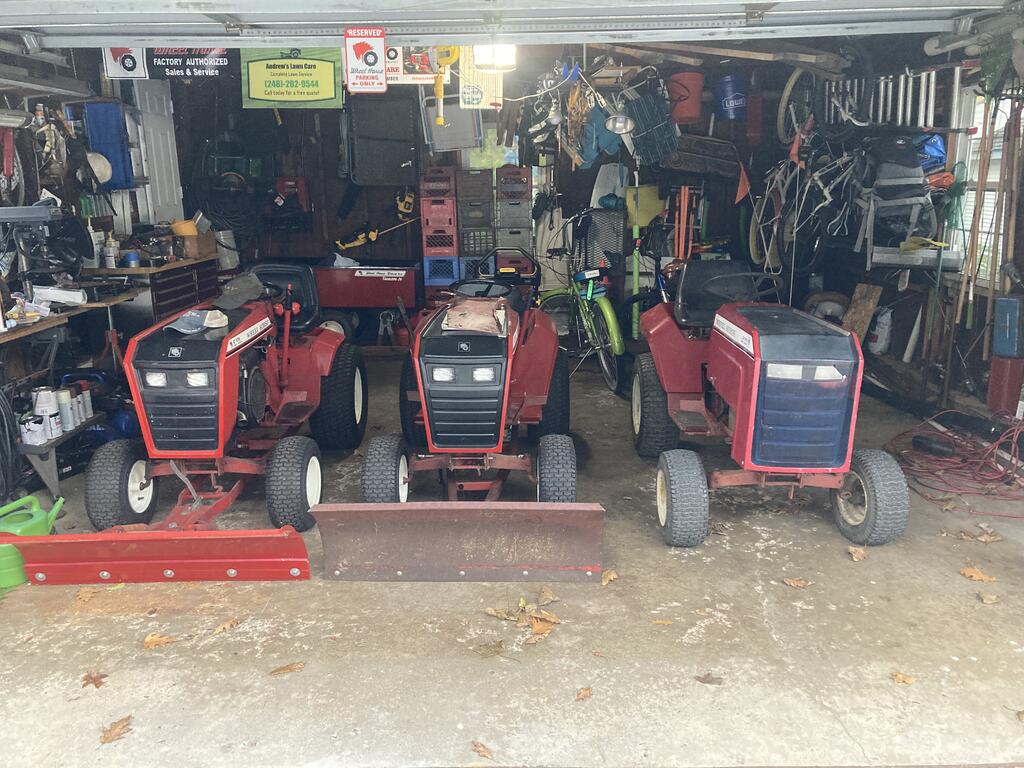

SylvanLakeWH 31,769 #25 Posted January 2, 2022 On 1/1/2022 at 12:20 PM, Lee1977 said: The most useless tires I have ever had were the Carlisle Turf Savers 20 minutes ago, BeninCT said: Turf saver tires are terrible in the snow I respectfully disagree. I plow three flat broom finished concrete driveways in South Eastern Michigan (just did 3” off all three this morning)… Carlisle Turf Savers with no added weight and no chains… work great for me. just my experience. I plow in 2nd gear with a C 105 and a C 6.5 (predator swap). Basically same tractors… Used chains first year and they definitely will mark up asphalt and concrete… Pics of my set up: 2 Share this post Link to post Share on other sites
