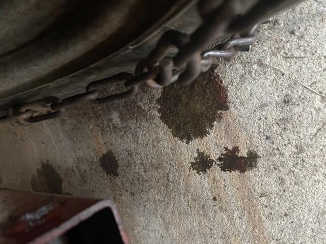

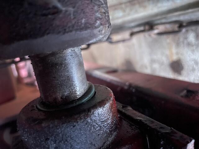

AHS 1,701 #1 Posted December 31, 2021 My B80 is my plow ride! I have noticed oil on the rear end axle seal on the right. I have noticed an o ring(??) pushed out. Is this the sign of a wheel bearing going bad? Im 99% sure that last summer the wheel bearing wasn’t going bad. Rocked the tire and no play. Im all ears. The B80 is tough!! Share this post Link to post Share on other sites
953 nut 69,551 #2 Posted December 31, 2021 That is your axle seal, seems it may not have been properly seated when installed. If you remove the wheel hub, slide a piece of pipe that is snug to the axle over the axle. Tap on the pipe with a small hammer it should true the seal up and slip it into place. 5 Share this post Link to post Share on other sites
ebinmaine 80,765 #3 Posted December 31, 2021 Richard's advice in the previous post is spot on. If that wheel hub isn't easy to remove you could potentially make a tool to slide over half of the axle. Really not the best way to do it but it is a possibility. Jack up that side of the tractor so the wheel is hanging free. Have someone lift the wheel up and down a little so you can see if there is any axle bearing play. Should be next to none. 2 Share this post Link to post Share on other sites
ri702bill 13,092 #4 Posted December 31, 2021 Hmmm...... judging by the wetness on the flange and axle, along with the drip spots on the floor, I'm inclined to think that removing the hub will be easy - all juiced up from the seal being out of place. A tip - remove the square head setscrew completely - rotate the hub so the screw is at 12 o'clock - spritz some penetration oil into the screw hole - helps break the rust. Replace the screw with a NEW one if possible - torque it to spec. Bill 1 Share this post Link to post Share on other sites
stevasaurus 23,857 #5 Posted December 31, 2021 I hate to say it, but that sure looks like an "O" ring to me. I'm wondering if you have a seal behind that. If it is an "O" ring, that is not supposed to be there. Take off the hub and dig that out and see what is going on in there. Measure the diameter of your axle, I'm betting they are 1" and not 1 1/8". The axle seal for 1" axles is SKF #9815. If they are 1 1/8" the seal is SKF #11050. 3 Share this post Link to post Share on other sites

Pullstart 71,296 #7 Posted December 31, 2021 I’m with Steve. That looks like a less than stellar previous repair. 1 Share this post Link to post Share on other sites
AHS 1,701 #8 Posted January 6, 2022 On 12/31/2021 at 7:34 AM, 953 nut said: That is your axle seal, seems it may not have been properly seated when installed. If you remove the wheel hub, slide a piece of pipe that is snug to the axle over the axle. Tap on the pipe with a small hammer it should true the seal up and slip it into place. I had the hub of last summer and found out it was the drive pulley seal. I have a new seal, (somewhere!). I’m sure that will come of easy. It’s 1 1/8”. Ok, what should I use for pipe? The piece of pipe has to be no bigger than the seal, so it can push the seal in? Or should you just need to push the seal flush with the transmission? Share this post Link to post Share on other sites
953 nut 69,551 #9 Posted January 6, 2022 5 minutes ago, AHS said: just need to push the seal flush with the transmission? I keep a scrap piece of 1 1/4" PVC for the 1 1/8" axles, it measures about 1.35" Inside Diameter. For the 1" seals I use 1" PVC which measures 1.03"ID. 4 Share this post Link to post Share on other sites
rjg854 13,380 #10 Posted January 6, 2022 You could also use the hub as long as it slides easily on and off the axle. The seal should be flush with the outside of the casing. 3 Share this post Link to post Share on other sites
rmaynard 17,585 #11 Posted January 6, 2022 I have seen tractors where the owner pushes one seal (that is leaking) further into the case, then puts a new one on top of it. Not recommend. Check to see if what you are looking at is a seal (should be hard) or an o-ring (should be soft). When checking for axle bearing play, about 1/8" in/out is good, any up/down is bad. 2 Share this post Link to post Share on other sites

stevasaurus 23,857 #16 Posted January 8, 2022 We are still not sure what you have in there. Is it a seal or an "O" ring?? Regardless, I would take out whatever that is and put in a new seal. There is a reason what ever you have there is falling out. Share this post Link to post Share on other sites
Wheelhorse#1 1,997 #17 Posted January 9, 2022 (edited) At least it should come right off.I’ve done 3 of these so far and never had a problem removing them. I use a pick that’s bent at a angle, hammer it through and pry it out . Edited January 13, 2022 by Wheelhorse#1 Share this post Link to post Share on other sites
