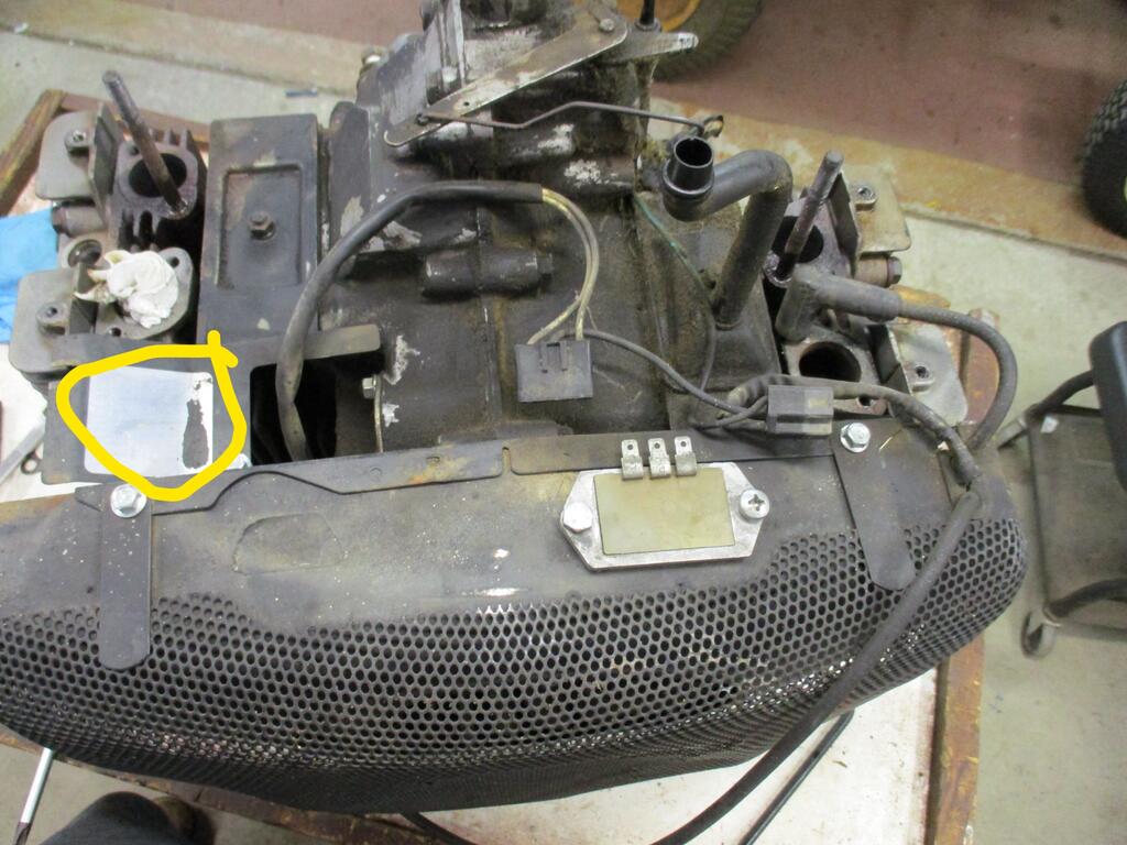

pfrederi 21,145 #6 Posted December 30, 2021 (edited) The red engine with the square filter is a Magnum 18 not original to the tractor Incidentally the heic format you used is very awkward for the nonApple world to use Spec number is an the circled plate Edited December 30, 2021 by pfrederi 2 Share this post Link to post Share on other sites
