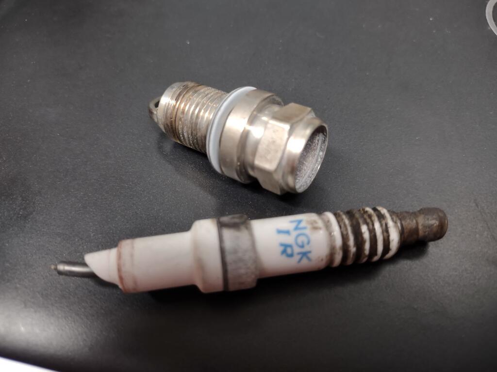

Achto 32,794 #1 Posted December 30, 2021 This did not happen on a small engine, but an engine just the same. I've never seen a spark plug come apart like this. This happened with in the first 1/2 hour of run time. Just don't feel like I got my $13 worth of use from it. 4 Share this post Link to post Share on other sites
rmaynard 17,585 #2 Posted December 30, 2021 1/2 hour of run time? That plug looks older than 1/2 hour. What am I missing? However, I've never seen one come apart like that. 1 Share this post Link to post Share on other sites
AMC RULES 37,259 #3 Posted December 30, 2021 Did the rest of the engine grenade too? 1 Share this post Link to post Share on other sites
ebinmaine 80,765 #4 Posted December 30, 2021 I have seen them come apart like that over the years but they were well used, to say the least. Half hour of run time, I'd say you got you a warranty issue there. That's a bad bond for sure. 1 Share this post Link to post Share on other sites
Achto 32,794 #5 Posted December 30, 2021 3 minutes ago, rmaynard said: That plug looks older than 1/2 hour. I think that compression blowing through the plug base and insulator is what made it look so bad. Melted the plug wire boot as well. Share this post Link to post Share on other sites
Achto 32,794 #6 Posted December 30, 2021 2 minutes ago, AMC RULES said: Did the rest of the engine grenade too? Engine survived. Share this post Link to post Share on other sites
WHX?? 58,215 #7 Posted December 30, 2021 3 minutes ago, rmaynard said: I've never seen one come apart like that. Really how bizarre. Did chunks of porcelain drop down in the jug? Chumponions were known for porcelain cracking but never that bad. 1 Share this post Link to post Share on other sites
rmaynard 17,585 #8 Posted December 30, 2021 Yeah, I guess the black on the porcelain is melted rubber boot. Share this post Link to post Share on other sites

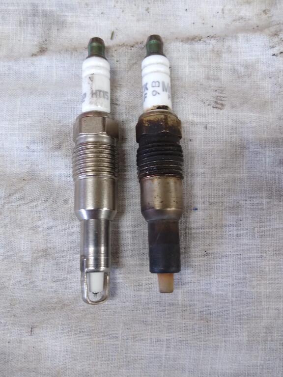

pacer 3,180 #9 Posted December 30, 2021 Another plug story, and this thing dealt me SOME misery!! 06 F150 with - of course - the COP's. At 110K was getting the typical 'juttering/shuttering' (slipping in/out of overdrive) usually caused by bad COPs. Replaced them and new plugs - ran worse.... Doing research found I DID NOT have Motorcraft COPs which was STRESSED that you HAD to have! (but did have Motorcraft plugs) Was driving the truck during this and had accumulated some few hundred miles doing the research. Replace COPs -- showed a misfire on #4 cyl -- replaced that COP, which was - of coarse under the computer next to the firewall, no change. So finally decide to switch another known good COP to that cyl (3rd time) This time I think, ya know, I might oughta check that plug while Ive got it opened up..... Yep, plug on the right -- had to have happened shortly after install!! Ran just fine after the one on the left was installed.... 1 Share this post Link to post Share on other sites
lynnmor 9,042 #10 Posted December 30, 2021 Any chance that you had severe detonation? Wrong heat range spark plugs, low octane gasoline, high temperatures and advanced timing can cause it. Share this post Link to post Share on other sites
squonk 48,152 #11 Posted December 30, 2021 I used to run into those on GM 4 bangers a lot. I had one where the metal broke below the hex. I had to shatter the porcelain and easy out the threaded part. Then one of those flexible grabber thingy's and a inspection camera to clean out the cylinder. 2 Share this post Link to post Share on other sites
ebinmaine 80,765 #12 Posted December 30, 2021 3 minutes ago, lynnmor said: Wrong heat range spark plugs That was actually the biggest cause of the Champion Plug failures, according to some in the industry. They tried to consolidate too many part numbers into one and obviously it didn't work out... 1 Share this post Link to post Share on other sites
Lane Ranger 12,114 #13 Posted December 30, 2021 Yes I had that happen on Champions several times. Disappointed me ! 1 Share this post Link to post Share on other sites
Achto 32,794 #14 Posted December 30, 2021 50 minutes ago, lynnmor said: Any chance that you had severe detonation? Wrong heat range spark plugs, low octane gasoline, high temperatures and advanced timing can cause it. No back fire or other noticeable issue. Correct heat range, natural gas, with 20 some pounds of boost from the turbo's. It past emissions, so the fuel/air mixture was correct. Same configuration that we run many times over. Share this post Link to post Share on other sites
roadapples 6,987 #15 Posted December 30, 2021 Maybe dropped before you got it and the porcelain was already cracked 6 Share this post Link to post Share on other sites
WHX?? 58,215 #16 Posted December 30, 2021 Prolly right 'Apples ... got dropped on the floor at the factory. Guessing this was on a genny at work Dan? 1 Share this post Link to post Share on other sites
Achto 32,794 #17 Posted December 30, 2021 (edited) 2 minutes ago, WHX?? said: Prolly right 'Apples ... got dropped on the floor at the factory. Guessing this was on a genny at work Dan? Yep. The other 11 spark plugs in the 33.9L engine were fine. Edited December 30, 2021 by Achto 1 Share this post Link to post Share on other sites
pfrederi 21,172 #18 Posted December 30, 2021 I broke a plug once, i was using a plain deep well socket and it was a bit worn and sloppy let the socket off line enough to break the porcelain. 2 Share this post Link to post Share on other sites
