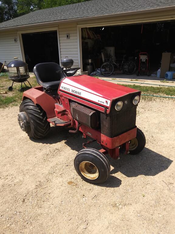

littleredrider 409 #7 Posted December 30, 2021 I have the tri ribs on my 520-8. Uses stock wheels. I have the steering reduction, but it turns effortlessly. Never measured but looks to be same height as the originals. I also have the Vredesteins 5-6 rib whatever they are on the other 520, and with the steering reduction as well, steers easy. If your gonna have alot of weight on the front, loader, 2-stage, whatever, then might look into the 5 rib. They won't sink into the ground, have more flotation. The tri ribs on ride on the center, so in soft ground or alot of weight, they will sink in. But will only go so far, the rib height is about an inch or so.... 2 Share this post Link to post Share on other sites

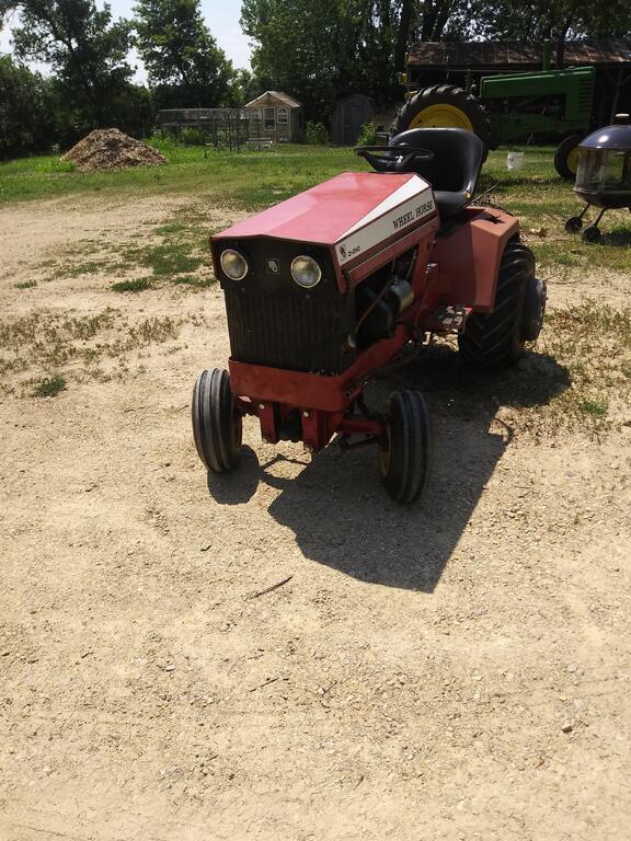

Andy N. 2,897 #14 Posted December 31, 2021 This past fall I put tri ribs on my 520-H and V61's on my 418-A. All purchased from Miller Tire. Both work great for, but the tri ribs do tend to leave marks in the lawn when I make sharp turns. Tri ribs are tubeless. V61's have tubes. I got to use the 418-A the other night plowing snow and they worked much better in my "U" shaped driveway pushing wet heavy snow around the turn. We are supposed to get 8" of snow this weekend which will hopefully give me a chance to use the 520-H with the single stage blower. 4 1 Share this post Link to post Share on other sites

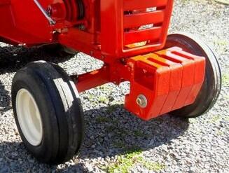

kpinnc 19,107 #15 Posted December 31, 2021 I have those same tri ribs on my Bronco. They are pricey, but make the tractor drive like it has power steering, even with more than 100lbs of suitcase weights up front. I may not buy another set due to the cost, but they are excellent tires! 2 Share this post Link to post Share on other sites
RED-Z06 2,720 #16 Posted December 31, 2021 Fwiw i installed my V61s with no tubes in...frankly, sketchy rusted but clean wheels. No leaks yet 1 Share this post Link to post Share on other sites
jeepdan 337 #17 Posted December 31, 2021 (edited) 2 hours ago, kpinnc said: I have those same tri ribs on my Bronco. They are pricey, but make the tractor drive like it has power steering, even with more than 100lbs of suitcase weights up front. I may not buy another set due to the cost, but they are excellent tires! Those look nice. What size tire and brand are those? What size wheel? Edited December 31, 2021 by jeepdan 1 Share this post Link to post Share on other sites
kpinnc 19,107 #18 Posted December 31, 2021 28 minutes ago, jeepdan said: Those look nice. What size tire and brand are those? What size wheel? Firestone 16x6.50-8. 1 Share this post Link to post Share on other sites
